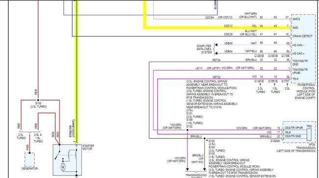

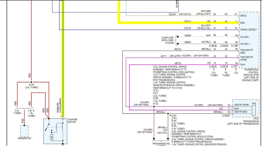

I had someone swap out my engine with another stock engine because mine stopped working. Now my car won’t crank and the gear shift display on my dashboard won’t read what gear it’s in. P0707 and P0706 are the codes it gives. No wiring seems to be broken/unplugged. Any ideas on what to check?
Sep 10, 2020 at 2:14 AM
Good morning,

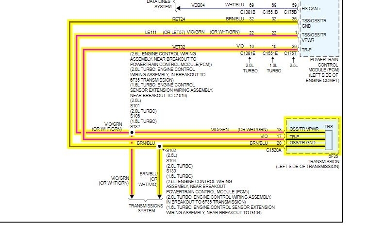

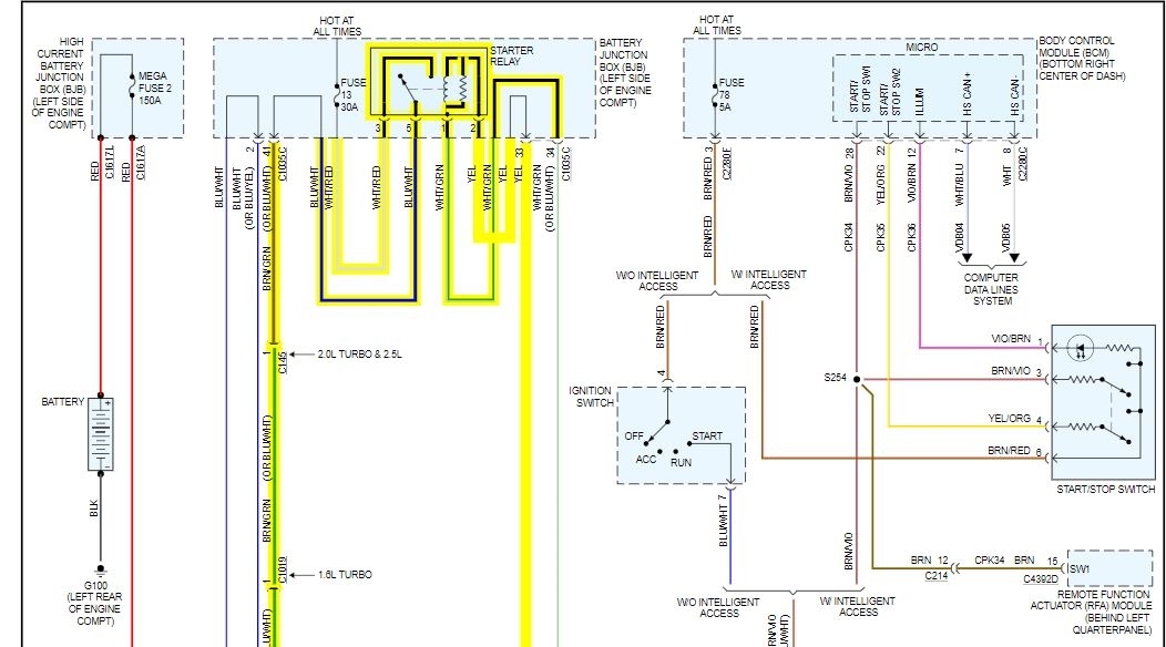

I attached a wiring diagram of the starting system for you to view.
If you have a voltmeter, we need to do some testing to see why this will not start.

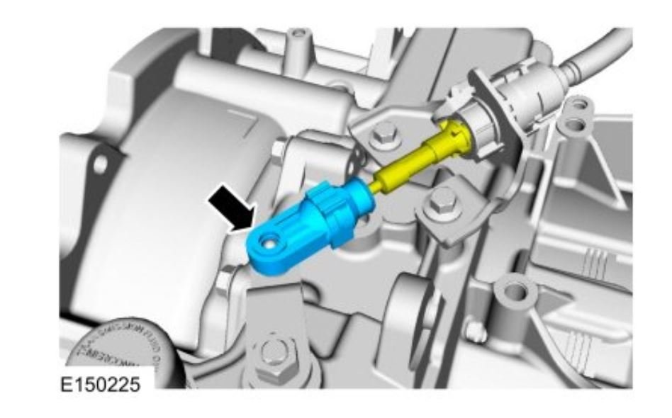

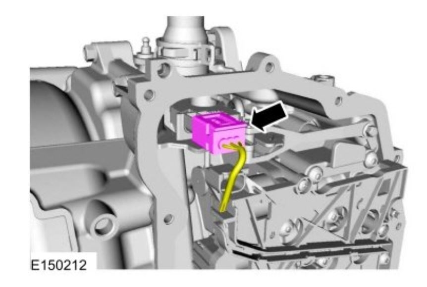

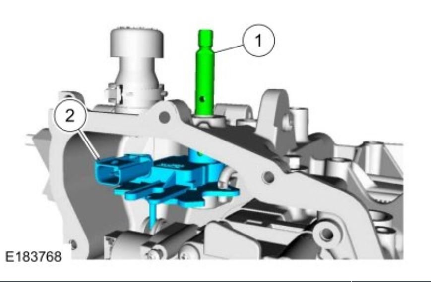

Transmission Range (TR) Sensor
Base Part Number: 7F293
Special Tool(s)/ General Equipment
Removal
1. Remove the main control cover.
Refer to: Main Control Cover See: Fluid Pan, A/T > Removal and Replacement > Main Control Cover (307-01 Automatic Transmission - 6-Speed Automatic Transmission - 6F35, Removal and Installation).

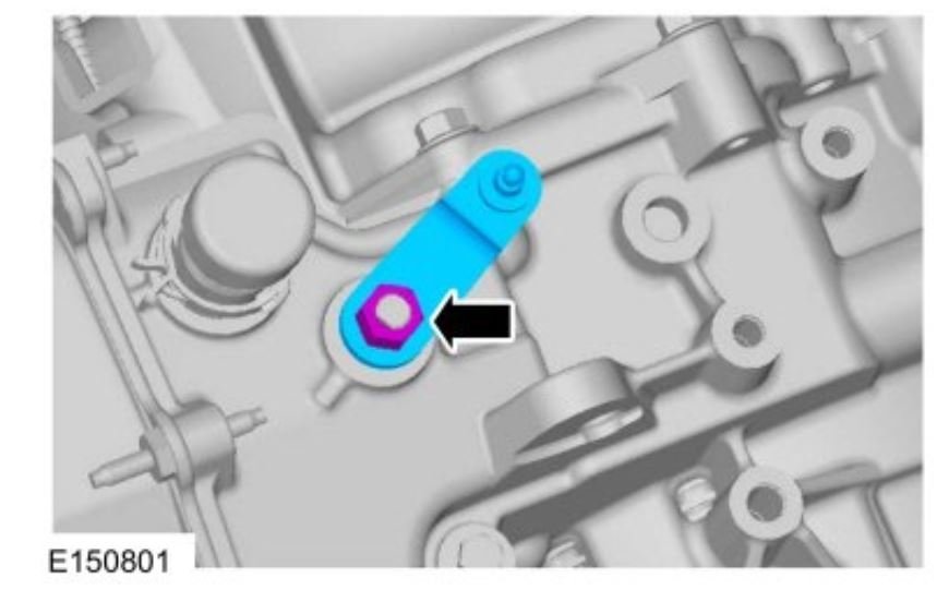

2. Disconnect the selector lever cable end from the manual control lever.
3. Remove the manual control lever nut and the manual control lever.
4. Disconnect the TR (transmission range) sensor electrical connector.

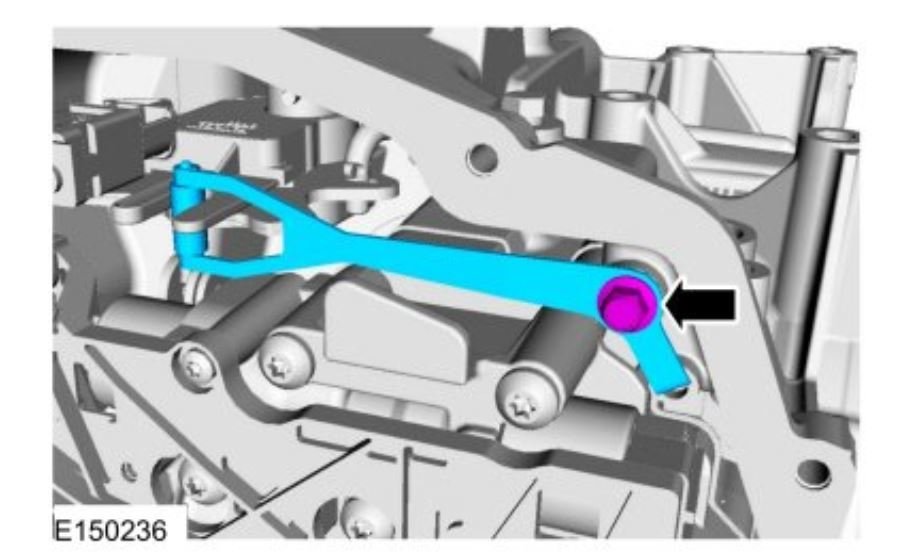

5. Remove the TR (transmission range) sensor detent spring bolt and the TR (transmission range) sensor detent spring.

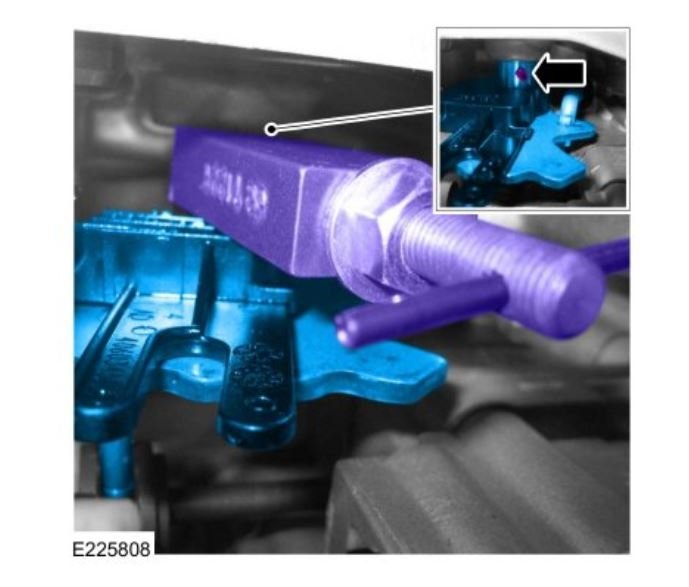

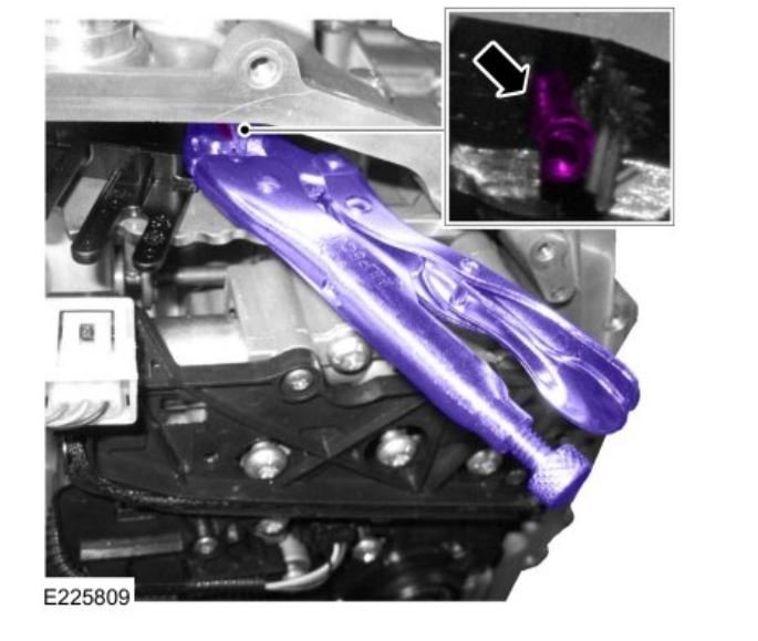

6. NOTICE: Do not drive the manual control shaft pin through the manual control shaft. The manual control shaft pin will contact the transmission case causing damage to the transmission case.
NOTE: If the roll pin remover does not pull the roll pin far enough to clear the manual shaft, the roll pin can be pulled from the TR (transmission range) sensor with a pair of channel locks.
Using the roll pin remover, remove and discard the TR (transmission range) sensor roll pin.
7. If the roll pin did not clear the manual shaft by pulling it with a roll pin remover, remove the roll pin from the TR (transmission range) sensor with a pair of channel locks.
Use the General Equipment: Locking Pliers
8.
Remove the TR (transmission range) sensor in the following sequence.
1. Hold the TR (transmission range) sensor in place and slide the manual shaft outward until the manual shaft is out of the transmission case.
2. Remove the TR (transmission range) sensor from the transmission, leaving the park pawl actuating rod attached to the TR (transmission range) sensor.
