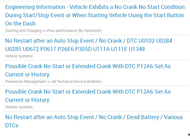

At this point, we really need to scan the can-bus to determine if there are diagnostic trouble codes stored in any of the modules.
CAN stands for controller area network. Basically, the different modules are tied together via a few wires. This type of scan will retrieve codes regardless of the module storing them.
Here is a link that explains how it's done:
Also, are there any aftermarket components plugged into the data link connector?
Let me know. There are a few different technical service bulletins related to a no-crank/no-start condition. However, I need to know if there are diagnostic codes stored to point you in the right direction. See pic below.
Let me know if that is something you can do or have done.

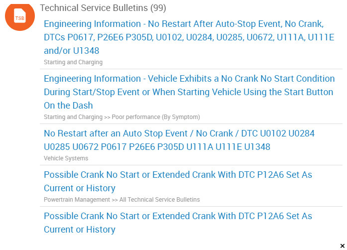

See pics below. Note: The pics are only a portion of the list. It appears there are multiple possible causes.
