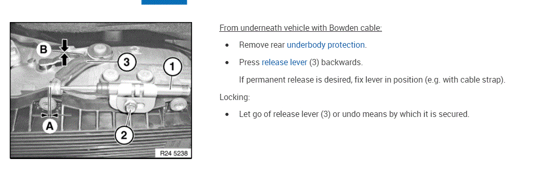

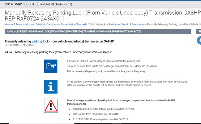

That is an early production, but it shows the same procedure. I also check 2015 and it's the same.

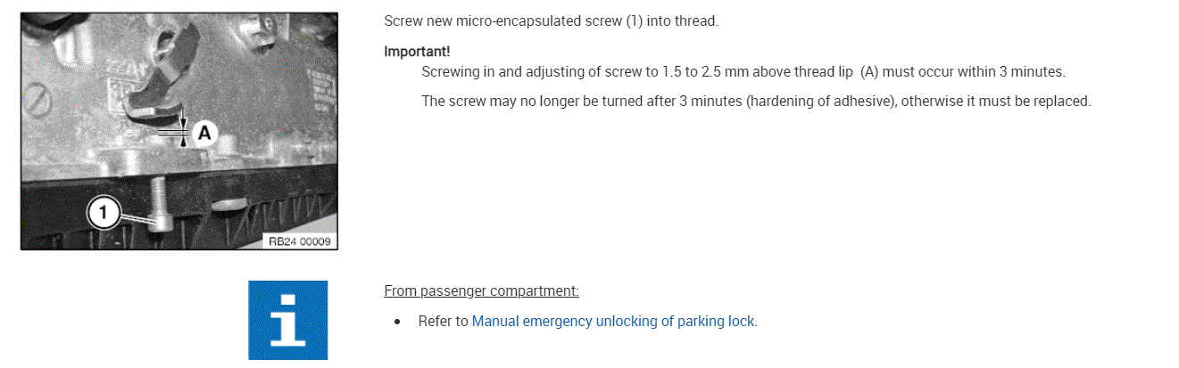

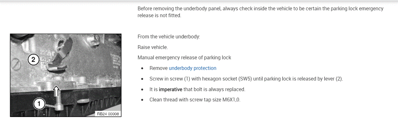

I dug through my manual and found a way to do it from under the vehicle. Take a look at the directions below. Please make sure the wheels are blocked and the parking brake is applied. I know it's on a hill.
Take a look and let me know.

I won't be able to do it from under, I know about that method, car is on a slope. The cup holders on this one is part of the whole console. I had several others with removable cup holders but not this one.

I have no idea why the inside release isn't on your vehicle. Is there something different as far as the model? The only other way I know of is from under the vehicle.
I wish I could be of more help. Let me know.
