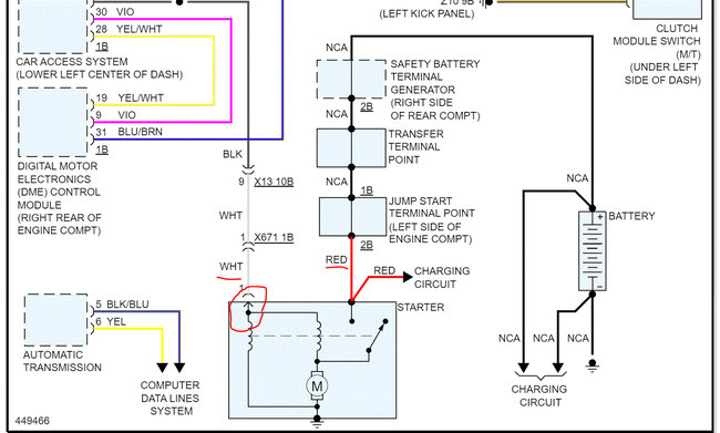

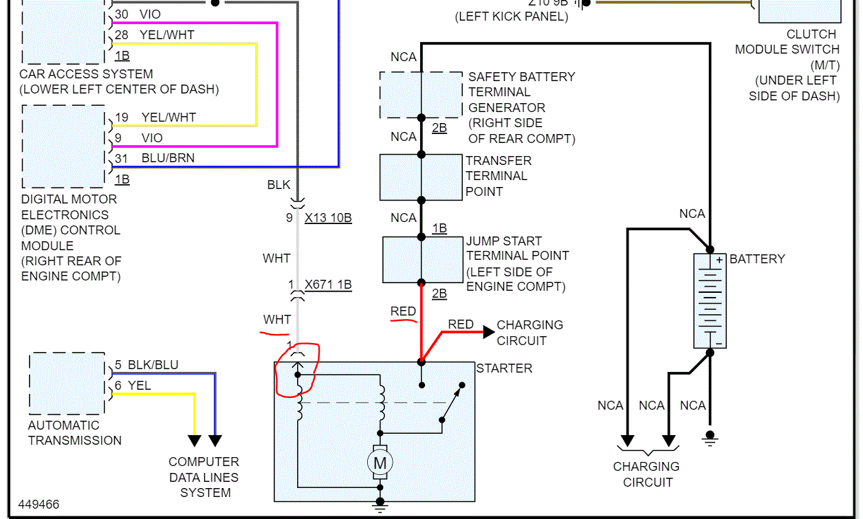

Does the click come from the starter motor? Do this. At the starter, there will be a heavy gauge red wire that should have 12v at all times. First, confirm that is the case.
If it does, have a helper try to start the vehicle. When the start button is pressed, you should then have 12v to the smaller gauge white wire.
If you have both, the starter is likely bad. Try this and let me know what you find.
I attached the starter schematic for your reference. Additionally, here is a link you may find helpful:
See pic below.

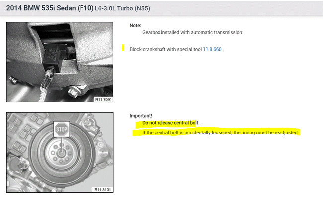

Are you sure the engine isn't locked? If you place a socket and a breaker bar on the crankshaft pulley bolt, are you able to turn the engine? If the starter can't turn the engine and it's smoking, that is what it sounds like.

Something is preventing the starter from turning the engine. Are you able to get to anything that will turn the engine?
Also, if you go to the center bolt on the crankshaft pulley, you have to be careful not to loosen it. If it becomes loose, the timing will require adjustment.

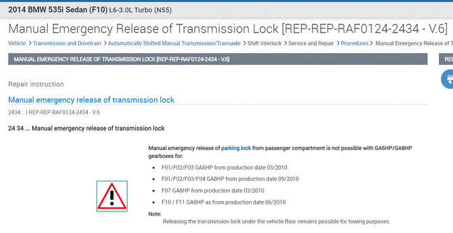

I can't get to the bolt its tight and car is parked outside on a small incline and cannot be put in neutral to be moved. Why would loosening the bolt requires timing adjustments?
Jun 15, 2022 at 10:34 PM
  • 110,241 POSTS

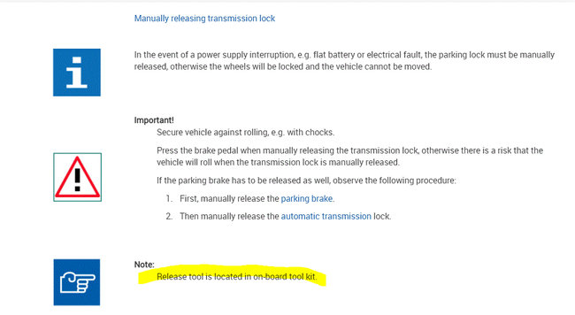

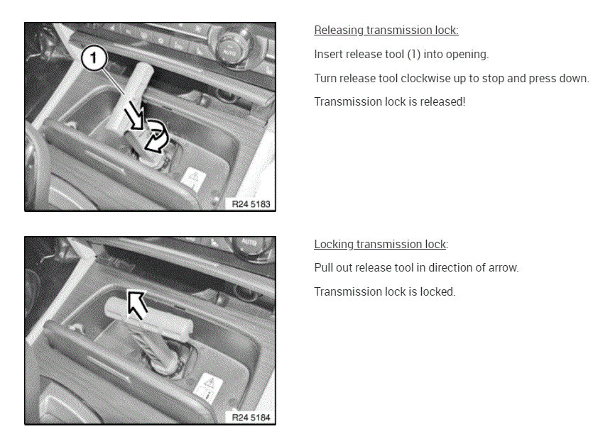

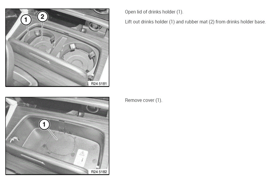

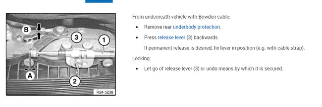

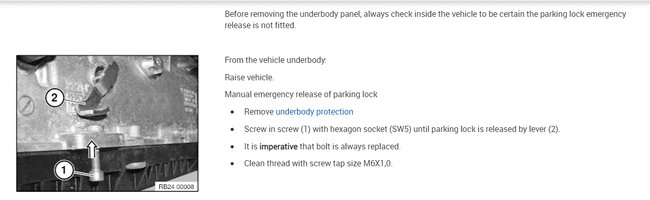

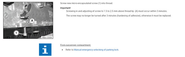

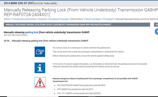

When you loosen the center bolt, it changes the crankshaft position sensor angle. Take a look at the pic below.
As far as the shift lock is concerned, you can manually bypass it. The remaining pics below are the directions to release the shifter.
Let me know if this helps.

I knew about this release mechanism, but this car does not have it. That was the first thing i checked. No tool, and these ashtrays are different, they don't come out. Tow truck also knew about it and couldn't find any other way to put it in neutral.

  • 110,241 POSTS
Unfortunately, that is the only way I am aware of. You know what? Let me know the production date. It may be an early or late model and has a different design.
The production date should be on the driver's side door.

  • 110,241 POSTS
That is an early production, but it shows the same procedure. I also check 2015 and it's the same.
I dug through my manual and found a way to do it from under the vehicle. Take a look at the directions below. Please make sure the wheels are blocked and the parking brake is applied. I know it's on a hill.
Take a look and let me know.

I won't be able to do it from under, i know about that method, car is on a slope. The cup holders on this one is part of the whole console. I had several others with removable cup holders but not this one.
