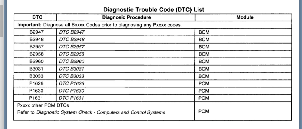

No matter what, there should be some codes that will point us in the right direction so let's start with checking for codes and see what is there.
Here is a guide that will help with this:
If there are no codes then more then likely we have a key or immobilizer issue so I would suggest trying another key, assuming you have a second.

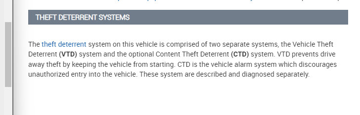

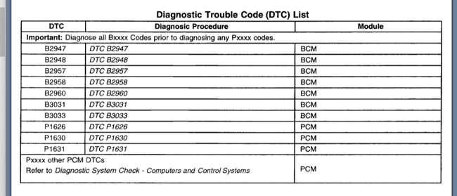

I am attaching some info on this including the normal codes that we get when there is an issue but let me know what codes are there and we can take the next steps.

Only code is an o2 sensor p0137. I do have an extra key I had made when I acquired this car and did try both when the issue flared up.

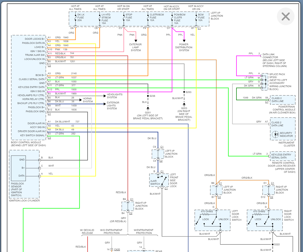

Okay. Clearly the o2 code is not going to be related so the only things that make sense since both keys are doing this, is that the BCM is not deactivating the system.
Clearly at this point it is still a guess because it could be a faulty ignition switch not sending the key info to the BCM but what is happening is when the BCM is supposed to turn off the theft system, it is not doing it. So, it is either not getting the signal or not sending the signal.
So, the way we need to confirm this is using a scan tool when it is acting up to watch the BCM data and see if it is recognizing the ignition switch status.
This signal is sent on the communication network so we will not be able to just monitor the voltage on the circuit as it is a coded message, and we need the scan tool to read it.

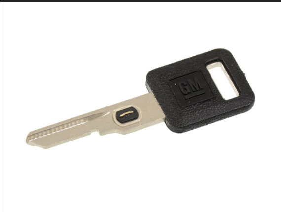

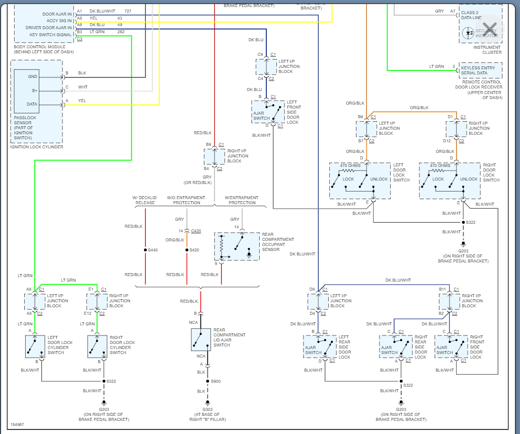

Thanks again. I have a creader 129 and the only option that I see in the body section is ignition voltage and restraint status. If that's not going to be what I need then I guess it will be replacing stuff. I have seen in some videos where they're splicing a 2200 resistor between a yellow and black wire that goes to the ignition switch. What are your thoughts on that please?
Feb 28, 2022 at 3:52 AM
Unfortunately, this can work for the GM vehicles that have a resistor in the key that is matched to the module.
However, your vehicle has a transponder key that sends a signal that the ignition switch picks up and sends a coded message to the BCM.
It doesn't use the resistor bypass method. Plus, you would need to check the key to get the resistance pellet to know what size resistor you need to use. So, if you look at the metal part of the key towards the plastic part there is no pellet in the metal part.
How often does this happen?
I attached a picture below of a pellet key.

Yes, it does not have the pellet. I don't drive it often, this last time it did it I had let my son use it to get to work and on the 4th day he had it, he guessed it failed about the 20th start. The last time I had it fail was roughly the same number of days but I would guess closer to the 10th cycle it failed. I'm currently on the second day of driving it and have started it about 6 times thus far.

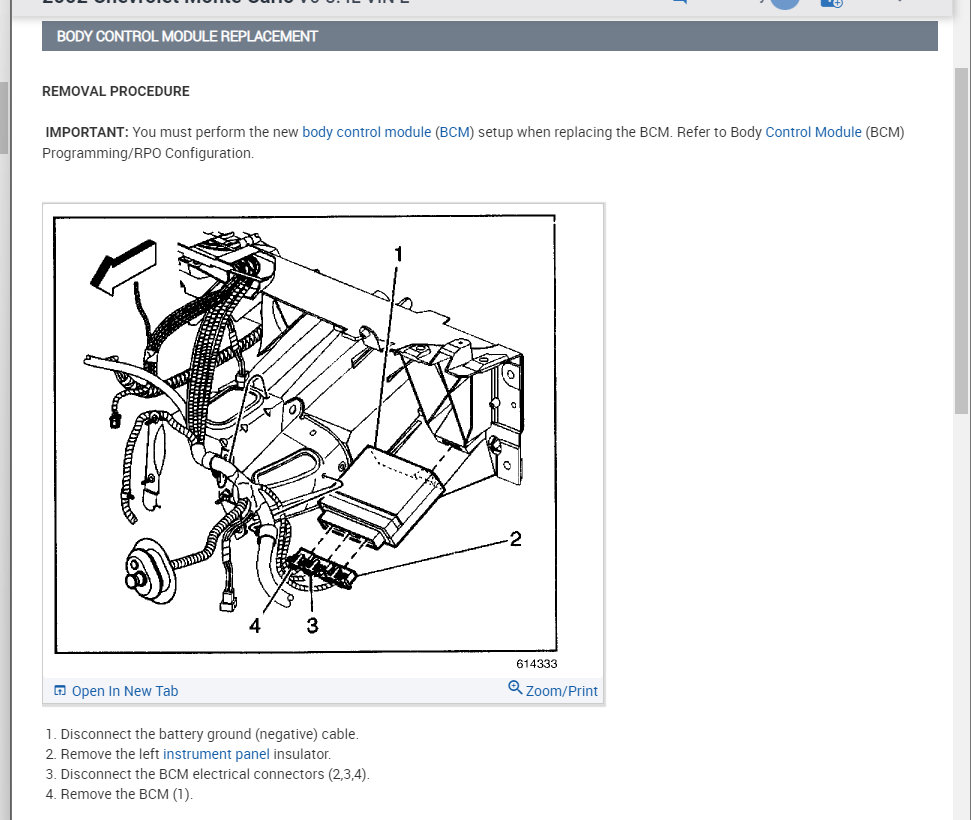

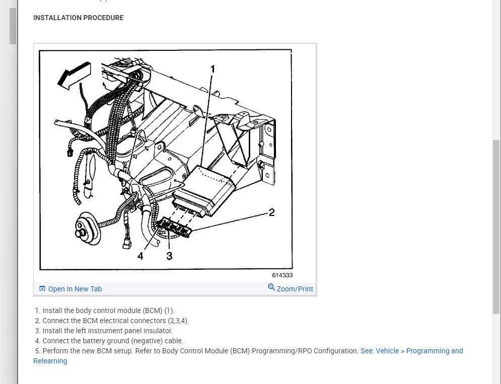

As far as throwing parts at it. What would those be? BCM, Ignition Switch? You said something about an immobilizer? In the meantime I will try to secure an appropriate scan tool.

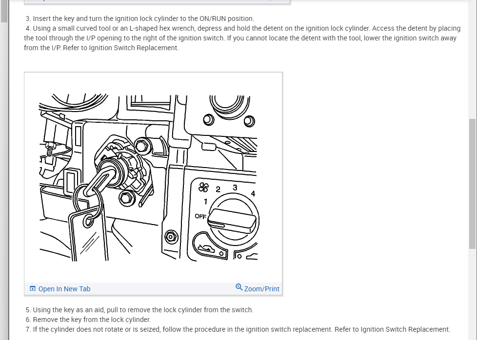

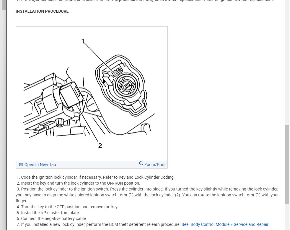

Mar 1, 2022 at 1:30 AM
Yes. The most likely cause of this is an ignition switch/immobilizer which appears to be one part. Then the BCM as well.
I am attaching the info on both these below.
