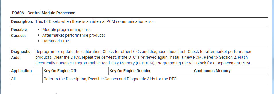

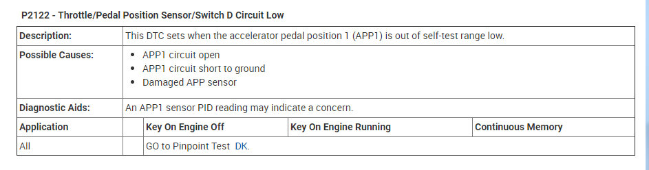

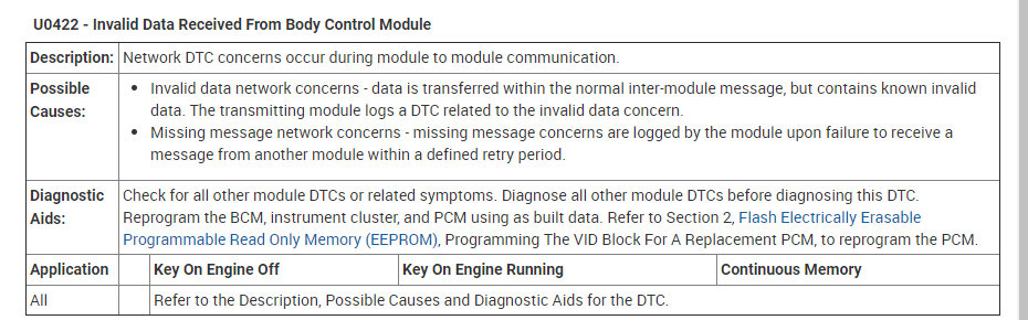

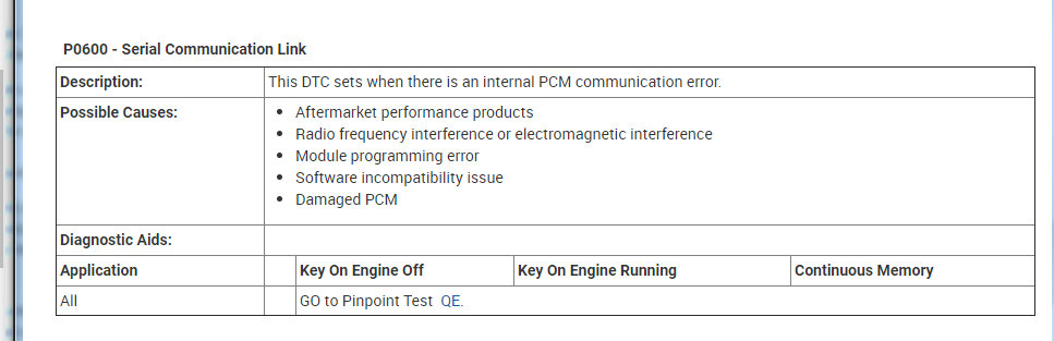

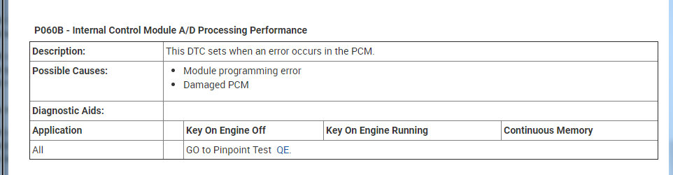

Po606, Uo422, P2681,P2602, P2122, Po60B, Po600, Uo422, Po606, Uo422 and P2681.That' s all of the codes I got them from my tuner .I looked at the list of codes from the website and couldn't find any of them. maybe you can help. thanks for your time and help.
Apr 26, 2021 at 11:48 AM
You said you have a tuner on the vehicle?
If so, that is going to be the cause of the P0606, P0600, P060B.
The U0422 is just saying that there is communication issues which would be the case since it appears the PCM cannot communicate or is damaged.
Also, the P2122 is for the accelerator pedal position sensor as I suspected.
So let's start with what aftermarket components you have installed on this. Can you remove them and retest the operation of the vehicle?
