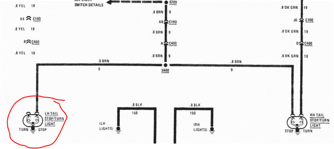

The left brake light and turn signal are not working
1988 GMC SIERRA
200,000 MILES • 5.7L • 5 CYL • 4WD • AUTOMATIC
JLMEHAFFEY
The reverse light is working fine. I have replaced the bulbs, the fuses, and the brake fuse as well. I am not sure what else i need to do.

The brake and signal lights work from the same power supply. I need you to first check to see if there is power to the light socket. All you need to do is take a test light or multi meter to check.
If you look at the attached pic, you will see there is a brown wire that supplies the power. Check that wire in the socket that for power.
I need to know something as well. When you remove the light assembly from the truck, is the rear of the light housing a printed circuit board?
