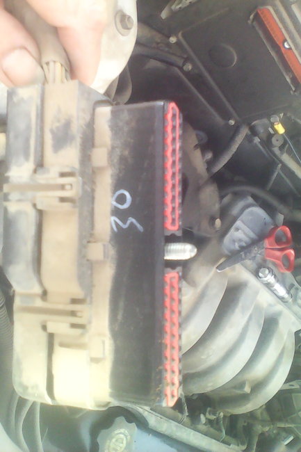

I have another question same vehicle what is the name or type of connector that plugs into the TCM, and ECM. I tried using the term 40 pin, and 60 pin I got zero results. Here is a pic of it.

KEN L
  • MASTER CERTIFIED MECHANIC
  • 48,363 POSTS
Main ECM connector. I don't think it has a name that I know of. Caradiodoc might chime in with it
