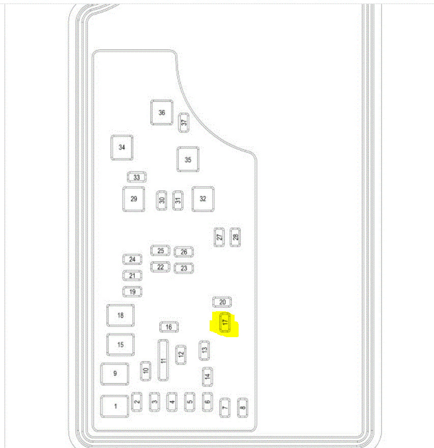

Wipers continue not to work even after replacing the motor and switch and I can’t find a bad fuse or relay.
Dec 29, 2021 at 9:29 AM
  • 110,194 POSTS
These vehicles have what is called an integrated power module. Although the modules last, a common problem is the small pins tucked into each connector are known to corrode, break, pull out, and so on.

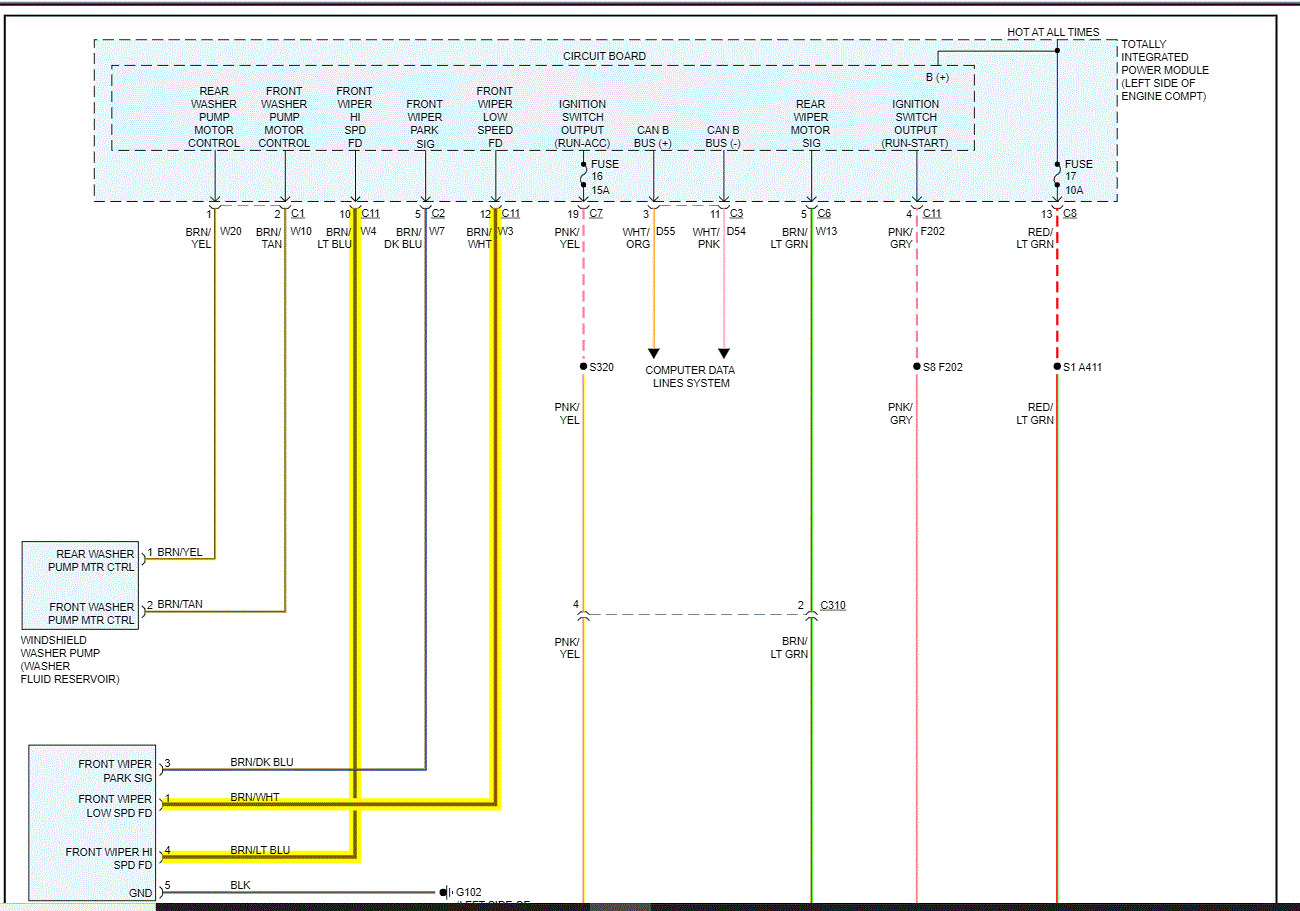

First, if I am reading the wiring schematics correctly, fuse 17 in the under-hood fuse box (see pic 1 below) is what powers the wipers. If you haven't already, check that fuse. If it is good, make sure there is power to and from it. Here is a link you may find helpful:

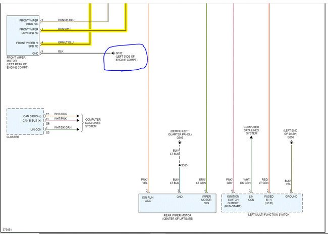

If the fuse is good and has power, the easiest thing to do next is to confirm that the ground wire at the wiper motor (black in color) has continuity to ground. See pic 3.
If that checks good, then we need to confirm if there is power to the motor. If you look at the wiring schematics below (pics 2 and 3), notice I highlighted two wires. One is brown with a white tracer and the other is brown with a light blue tracer. The brown/white powers the low wiper speed and the brown/lt blue powers high speed.
Turn the key to the run position (engine off). Turn the wiper switch on high speed and check the brown/light blue wire for power using a test light or a voltmeter/multimeter.
Do the same on the brown/white wire with the wipers on low speed.
If you have power to both with the harness disconnected, connect the harness again and see if they work. If they don't, perform the same test with the connector at the motor connected. See if you have voltage with the wiper on and off. Let me know the results.

Well, i checked fuses for power all good. But when i checked for power on the harness connector going to wiper motor there was no power at the low or high speed. Ground wire was good. Any other suggestions or recommendations?

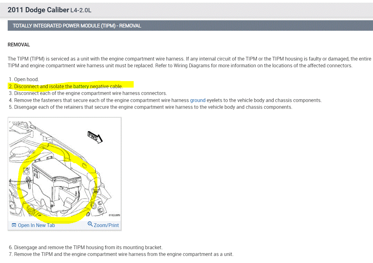

We need to disconnect the totally integrated power module to inspect the connection.
The connectors are under the TIPM (fuse box). First, make sure the battery is disconnected (neg terminal). Next, follow the directions in pic 1.
Once the box is loose, carefully lift it up to gain access to the wiring/connectors under it which plug into the module.

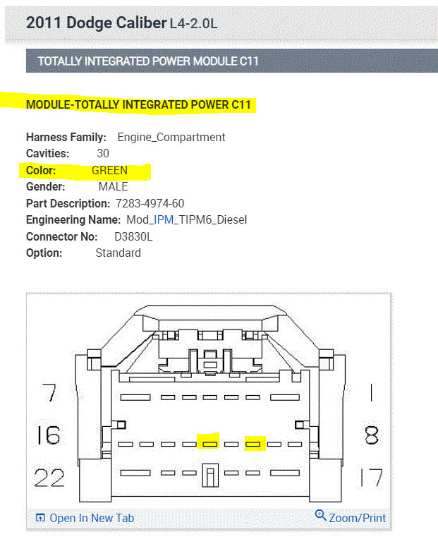

If you noticed in the first schematic I sent, the wiper speed power is supplied via connector 11 (C11) at pins 10 and 12.
Connector C11 will be green in color. If you look at pic 2 below, you will see how it's shaped. Disconnect the connector and inspect the two pins I highlighted in pic 2. Are they corroded, broken, or damaged in any way? Also, check on the receiving end for corrosion or damage.

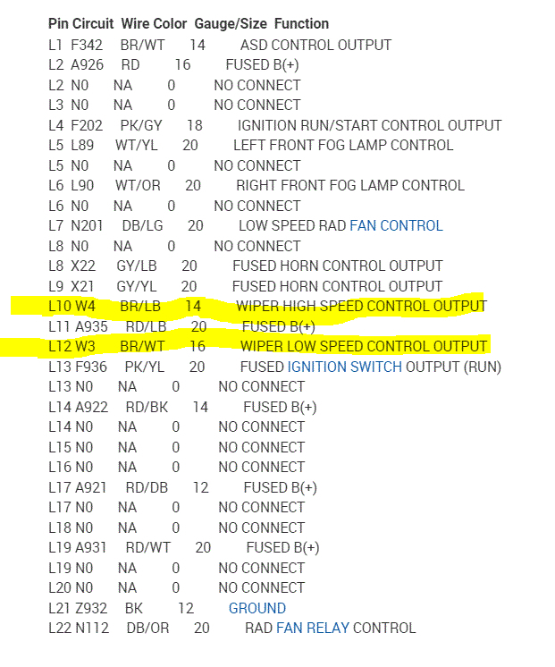

The last pic below simply shows what the two pins power. Since there is no power at the motor, I suspect this is where the problem is. Check it and let me know what you find.
