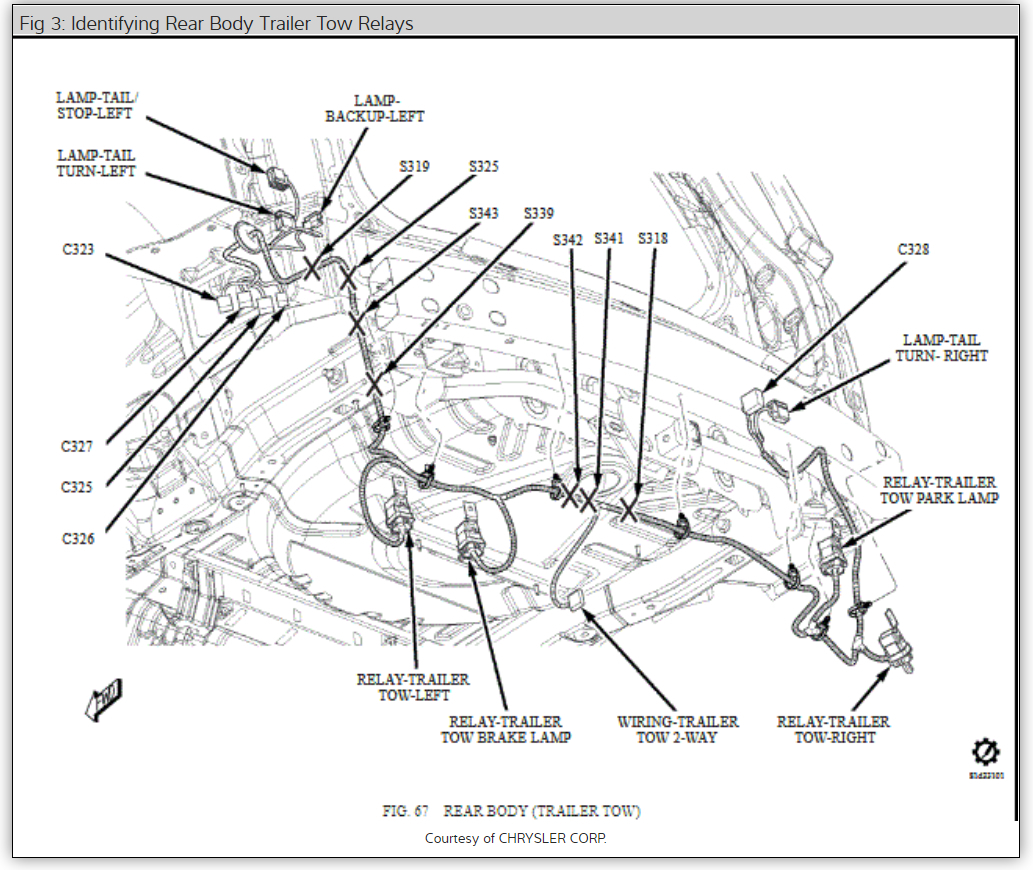

rear window wiper fuse location?
Apr 23, 2010 at 12:28 PM
  • 55,423 POSTS

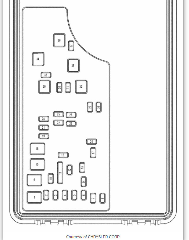

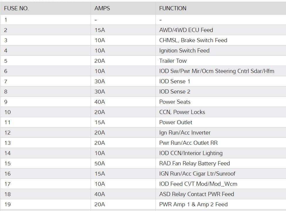

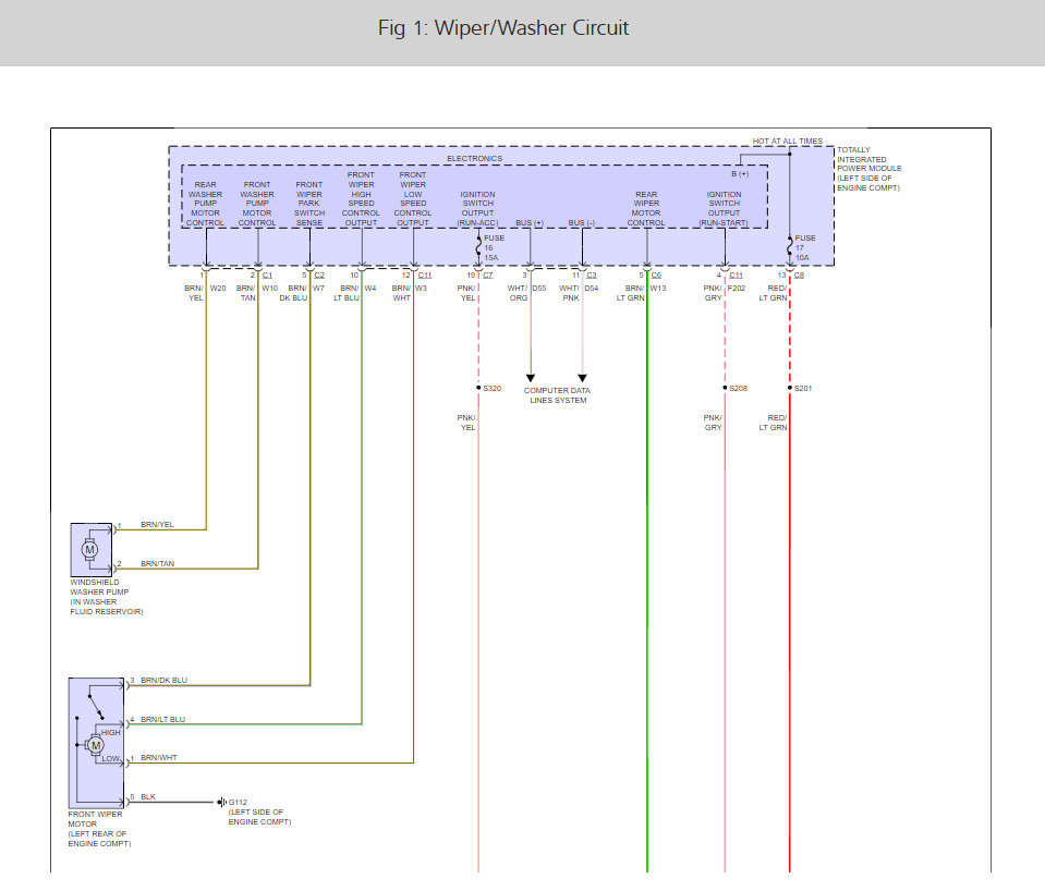

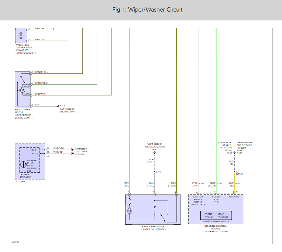

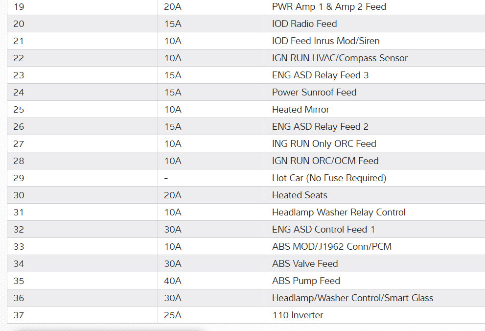

This system does not have a fuse for the rear windshield wiper circuit, it is controlled by the TIPM, you must check the fuse for that, is there any other operations that are not working? Here is the wiper system wiring diagram and a guide to test where you are losing power at.
and
Check all fuses in the TIPM
