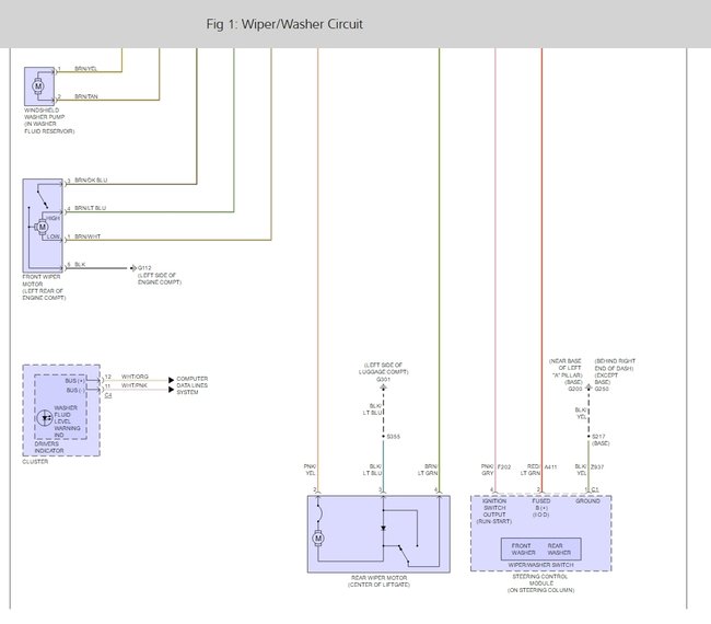

The rear window wiper does not work, I replaced the motor, yet no luck, the rear window washer works and it's on the same control?
Is there a special fuse, I pulled all and none are blown, unless there is an inline fuse, and if so what is the location.
any suggestions

Check fuse # 16 (15 amp) at the left side of the engine compartment. should have pink/yellow wire running to it. need to use tester, visual inspection can not always detect a faulty fuse.

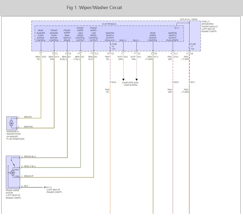

Hey Chrossfire,
There is a integrated power module that might be bad, here is a complete wiring diagram for you to check to see what's going on and a guide to use a test light.
Please run some tests and get back to us so we can continue helping you.
Best, Ken
