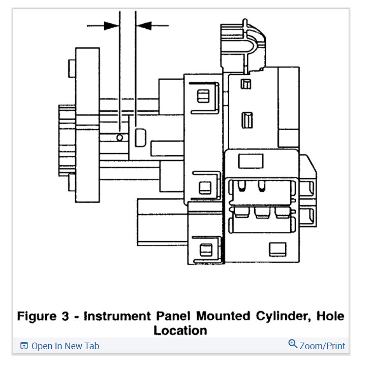

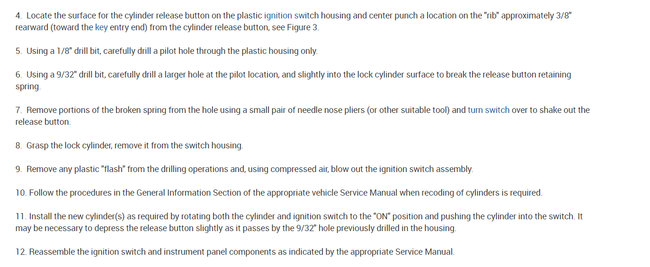

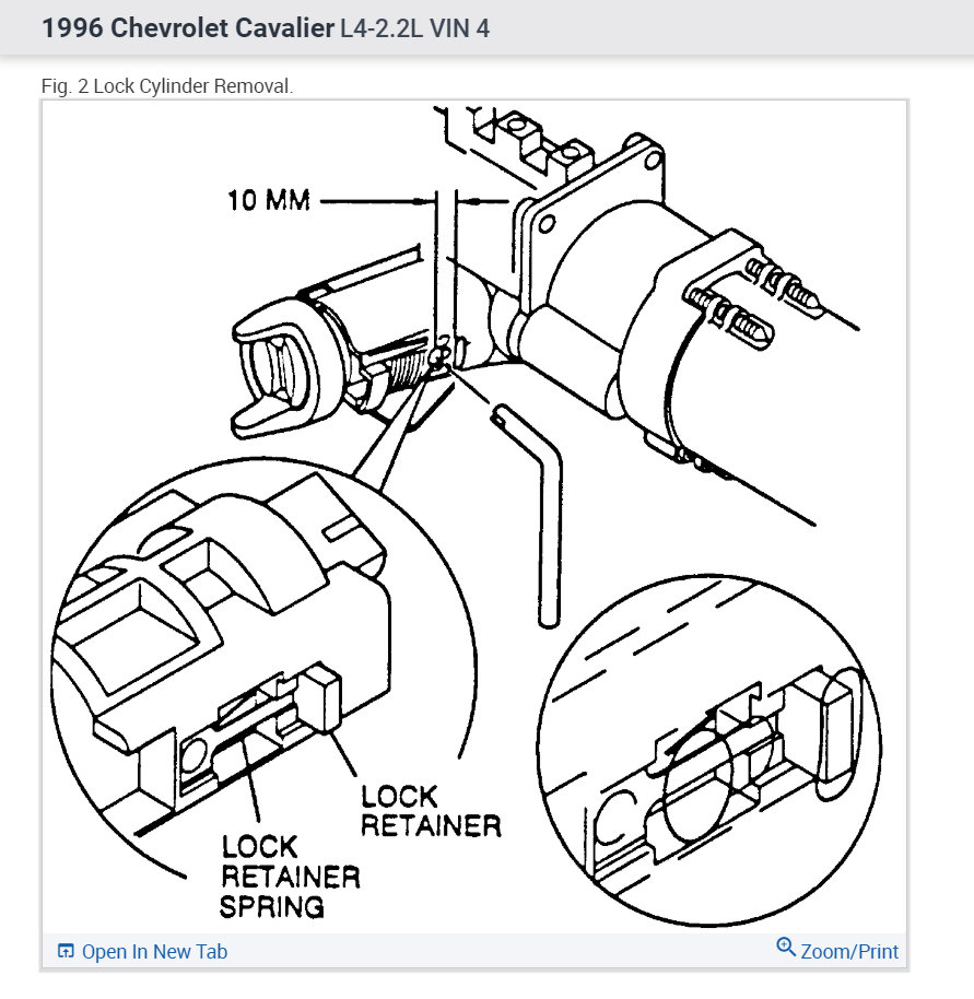

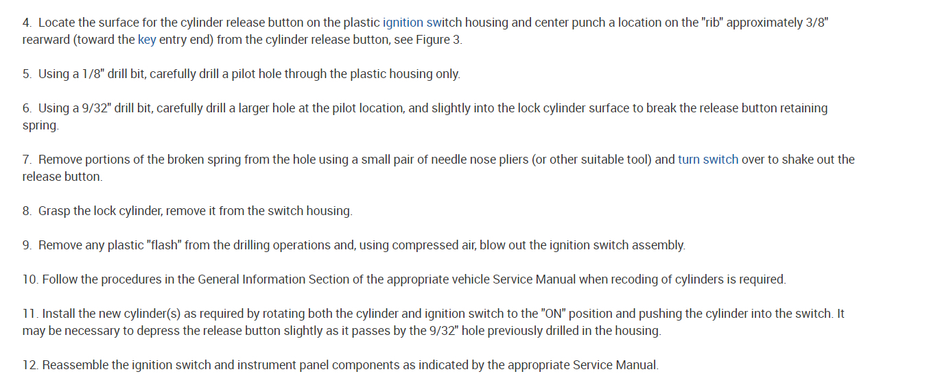

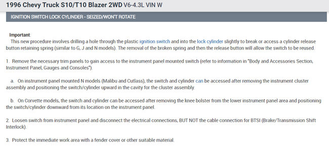

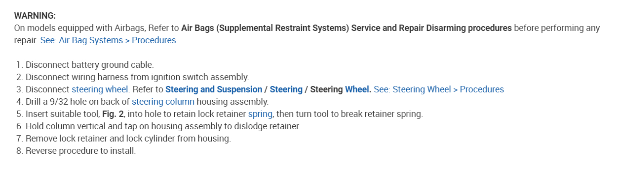

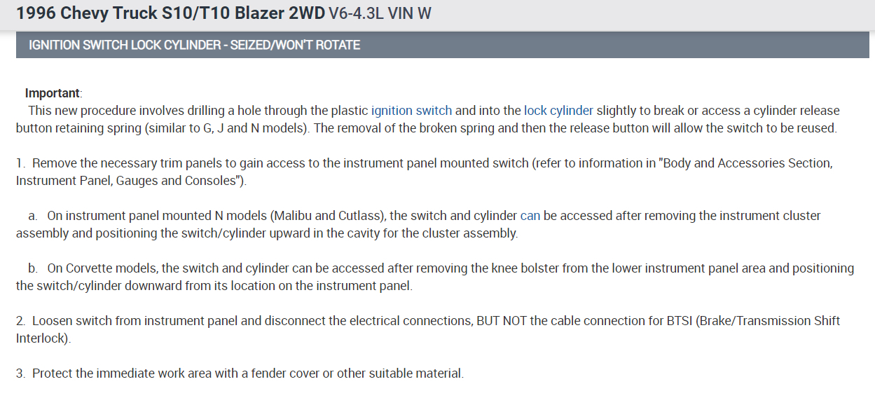

This happens when the ignition switch and key lock needs to be replaced. HEre are the instructions in the diagrams below. Check out the diagrams (Below). Please let us know what happens.
Monday, February 1st, 2021 AT 10:43 AM (Merged)
BILL LOST
I had to remove shift lever & grind some off the side so it released the paw that release the key
