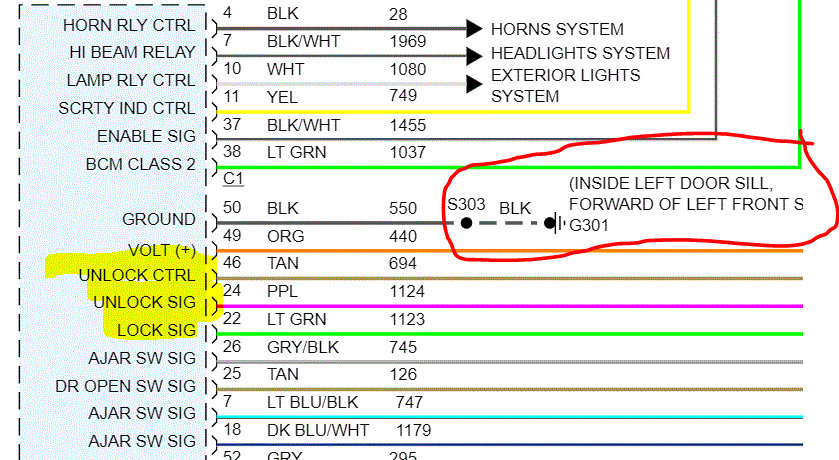

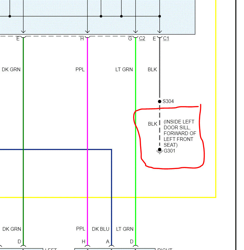

Windows and door locks not working
2005 PONTIAC GRAND PRIX
175,000 MILES
CHRIS DERRY
Fuse is good, replaced drivers door switch . Still no windows not working, door locks not working. any help would be greatly appreciated.
Jun 13, 2020 at 12:52 AM
  • 110,244 POSTS
I went through the wiring schematics for both the windows and the door locks. Both have different power supplies, so I don't think that is the issue. However, I did find one item that involved both. Both are grounded at the same point. Take a look at the two attached pics. The first one shows the ground for the locks and the second is the ground for the windows. That is what needs checked. I suspect that is the problem. Also, note that both circuits have a splice location, so make sure that is okay as well.
