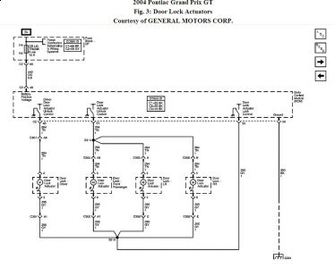

I have a 2004 Grand Prix and about a week ago when I would unlock my car using the keyless remote the car would continue to unlock itself, lock itself, pop the trunk, and would cycle through these multiple times. After driving for a few minutes this would stop, but it will do it again the next time the car is unlocked.
I switched out my keyless entry remote with the spare, and it still did it. I pulled the fuse on the keyless and just used the key manually, and it still did it. I finally pulled the fuse on the automatic locks, and although the locks and trunk have stopped cycling, I can still hear clicks/noises coming from the driver side automatic lock/window switch area.

Sounds like a malfuntion in the body control module.
https://images.2carpros.com/forum/automotive_pictures/30961_gp_2.jpg
I would start by getting the codes from the bcm, then a test procedure can be done. May need to reprgram or replace the BCM, but I wouldn't jump to that conclusion until testing is done through the codes.
