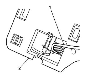

Hello - I believe this is the info you need. Lock Replacement - Rear Door Notes Lock Replacement - Rear Door Removal Procedure Important: Do not attempt repairs in order to correct lock discrepancies. Replace the lock. Remove the rear door trim panel . Remove the rear door water deflector.
https://images.2carpros.com/forum/automotive_pictures/248015_1_156.jpg
Open the outside handle rod to lock clip located on the door lock. The door handle rod should be loose from the lock. Remove the inside door handle.
https://images.2carpros.com/forum/automotive_pictures/248015_2_104.jpg

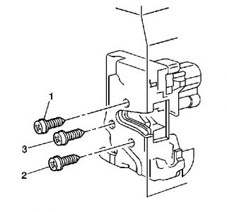

Remove the screws (1, 3, 2) securing the lock to the door (1). Remove the door lock and rods through the access hole in the door inner panel.
https://images.2carpros.com/forum/automotive_pictures/248015_3_72.jpg

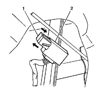

Disconnect the electrical connector (2) from the lock by pulling out the tab (1). Installation Procedure
https://images.2carpros.com/forum/automotive_pictures/248015_4_47.jpg
Connect the electrical connector (2) to the lock by pushing in on the tab. Install the lock and rods through the access hole in the inner door panel.

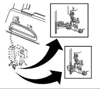

Important: The outside handles have adjustable outside handle lock rods. This allows for adjustment of the amount of travel needed in order to operate the outside handle. When servicing a vehicle with adjustable outside handle lock rods, remove all free play between the outside handle and the lock. Also, do not operate the outside handle before these connections are made. Install the outside handle rod into the clip. Close the clip over the outside handle rod. Inspect the door for proper operation. Install the rear door water deflector. Install the rear door trim panel.

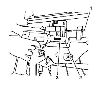

Hello - Does this help you out.........is this what you are looking for? Door Handle Replacement - Front Inside Notes Door Handle Replacement - Front Inside Removal Procedure Remove the front door trim panel. Raise the door window to the full up position.
https://images.2carpros.com/forum/automotive_pictures/248015_7_18.jpg
Remove the rivet (3) from the inside handle. Use a center punch to drive the inside handle (2) mounting rivet (3) mandrel into the rivet head to create a pilot hole. Use a 6.35 mm (1/4 in) drill bit to drill out the rivet. Remove the inside handle rod (1) from the lock rod guide block.
https://images.2carpros.com/forum/automotive_pictures/248015_8_10.jpg
Remove the inside handle (2) by sliding it forward until it releases from the door. Turn the inside handle clockwise to release it from the inside handle rod. Remove the inside handle from the door. Installation Procedure
