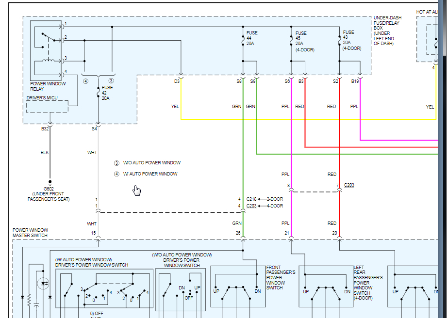

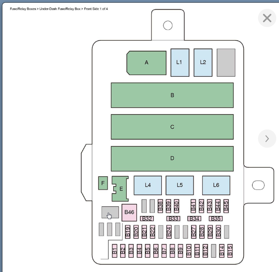

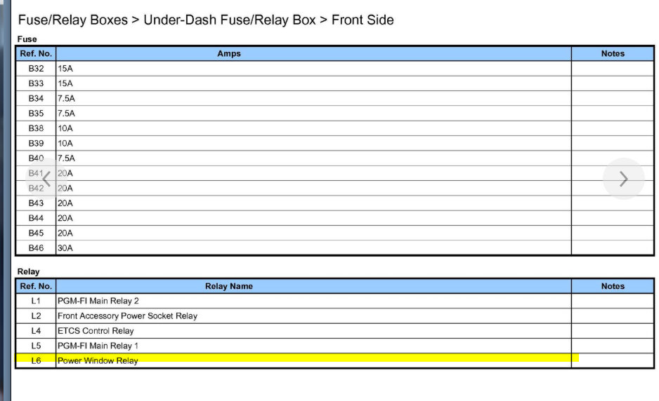

Battery went bad too. put a new battery in car starts fine everything works but the windows.
Nov 7, 2019 at 10:28 AM
Have you checked the power window relay? It is L6 relay on the under dash relay box. Swap out this relay and let me know if they start working. Check out the diagrams (Below). Please let us know if you need anything else to get the problem fixed. Thanks
Nov 8, 2019 at 7:19 AM

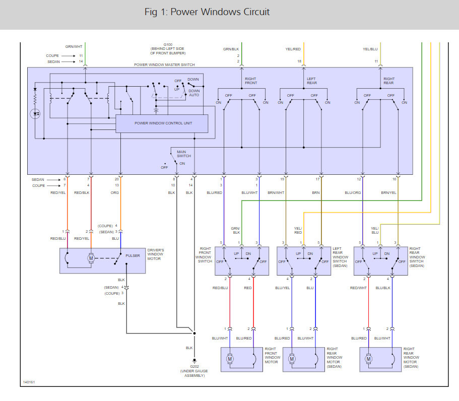

  • 55,399 POSTS

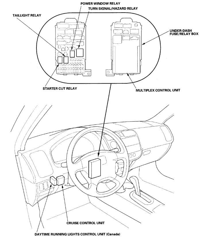

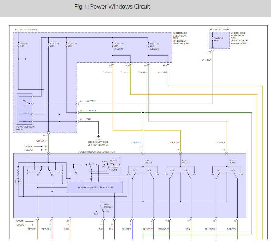

Here are the window wiring diagrams so you can see how the system works. There is a window relay that needs to be checked here is a guide and the location of the relay.
Check out the diagrams (Below). Please let us know what you find. We are interested to see what it is.

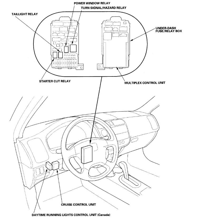

PRIINCESS
The window has been acting up and I assumed it was the motor so I took the door panel off and I saw that the window was of trck wen I put it back on track and plugged the door back into the switch part it doesn't work! I tried to test the power going to through the connectors and the one going to the motor and my door speaker are not showing and any power to them! I have replaced the motor and checked the fuses! What else could the problem be? I need to know asap my window is rolled all the way down and I need it to go back up atleast!
Jan 4, 2021 at 2:18 AM (Merged)
  • 75,992 POSTS
Check and test fuse no.11 and also the window control unit
