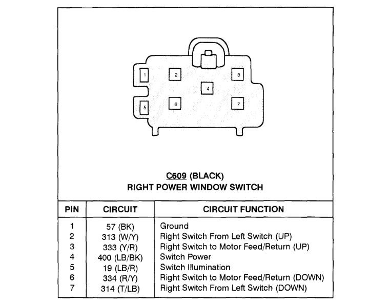

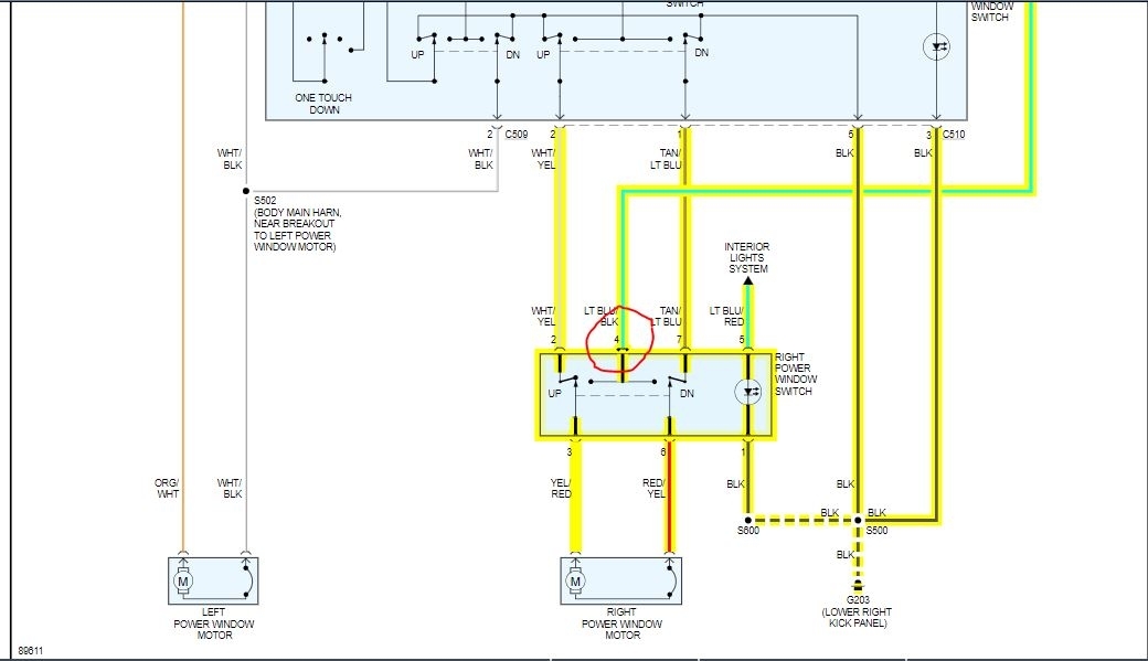

My passenger front window was broken into so I decided to change it out myself. Everything went fine but as I was rolling it up and down testing it the window stopped working. There's nothing in its way and it will go up and down with the master switch on the driver side but nothing with the passenger switch. Hoping it's not a bad motor/regulator but there was no signs of them going bad. Window going up and down slow etc.
Jul 28, 2020 at 5:19 AM
Good afternoon,
It is not the motor or regulator. If it was, it would not work from the master switch.
I attached the diagram of the system for you as well as the connector view.
With the key on, check the wire at the switch connector for power.
