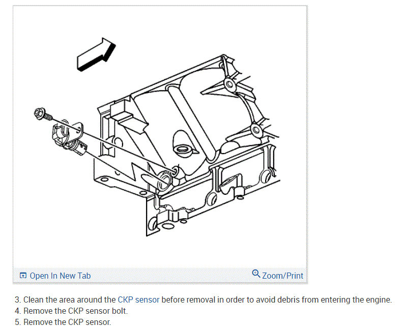

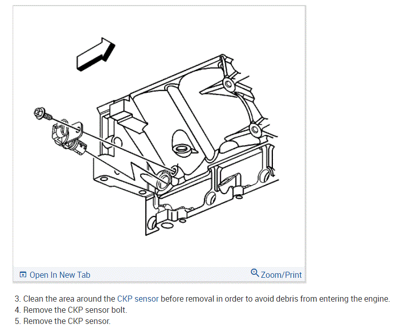

What you described sounds like a bad crankshaft position sensor. These sensors are adversely affected by heat when they start going bad. Once they cool off again, they work again.
Do me a favor. Read through this link. It discusses the most common symptoms related to a bad crankshaft position sensor. See if the things discussed mirror what you experience.
What you can do to confirm is this. Check to see if there is spark to the plugs when it stalls and won't start. If there isn't, this is my first suspect.

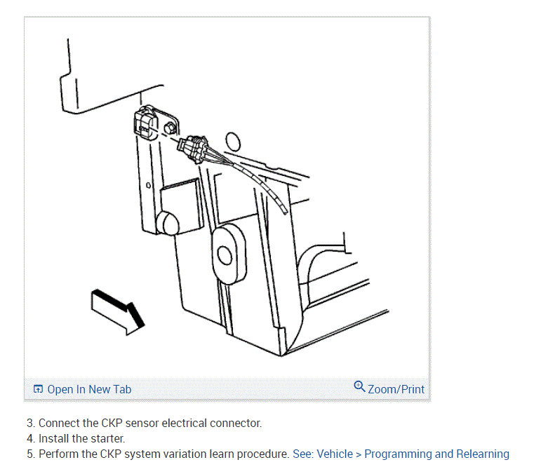

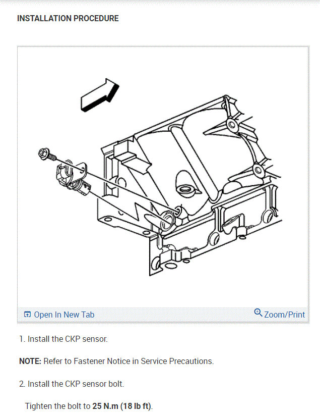

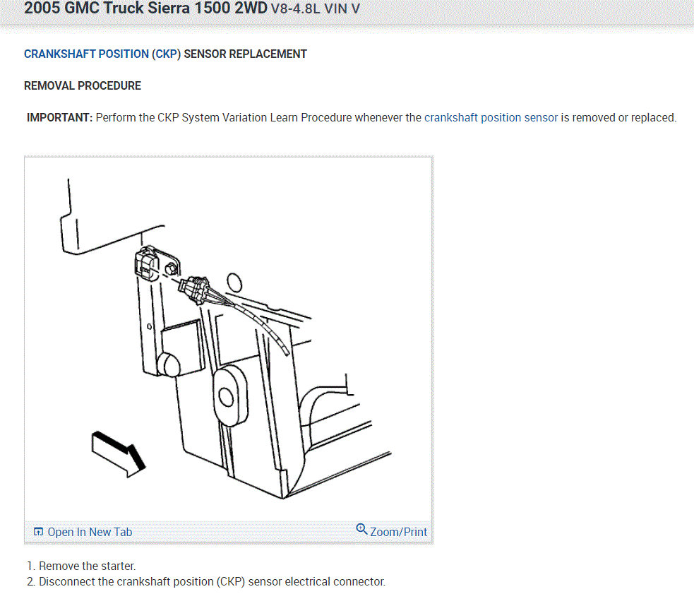

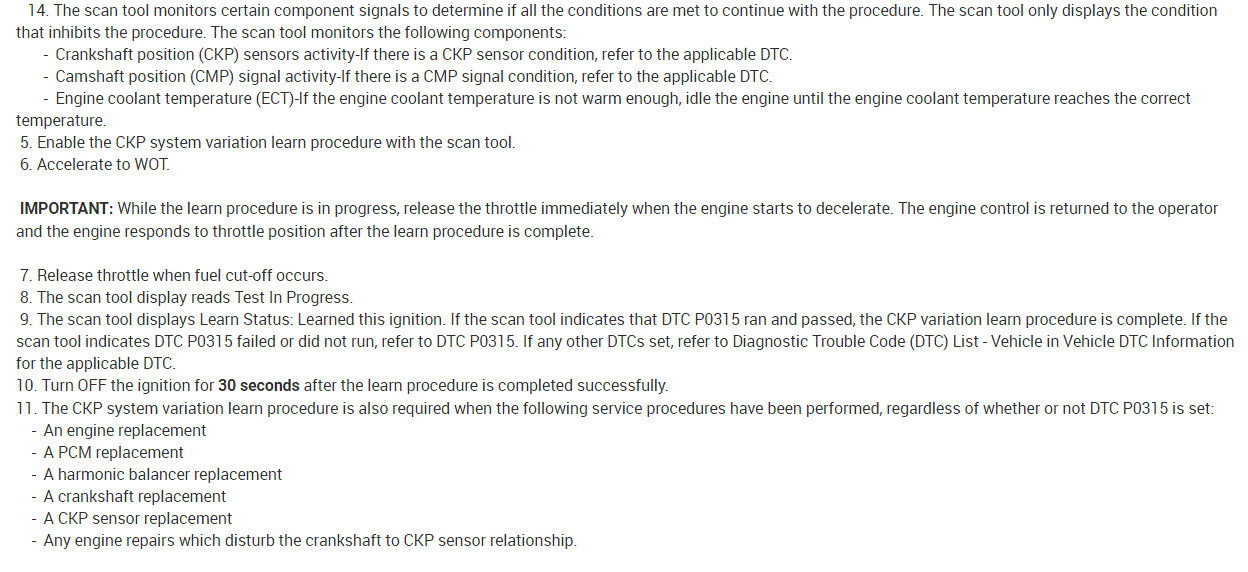

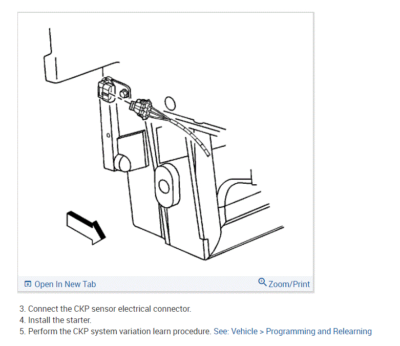

If you feel this is the problem, here is a link that shows in general how one is replaced:

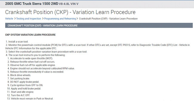

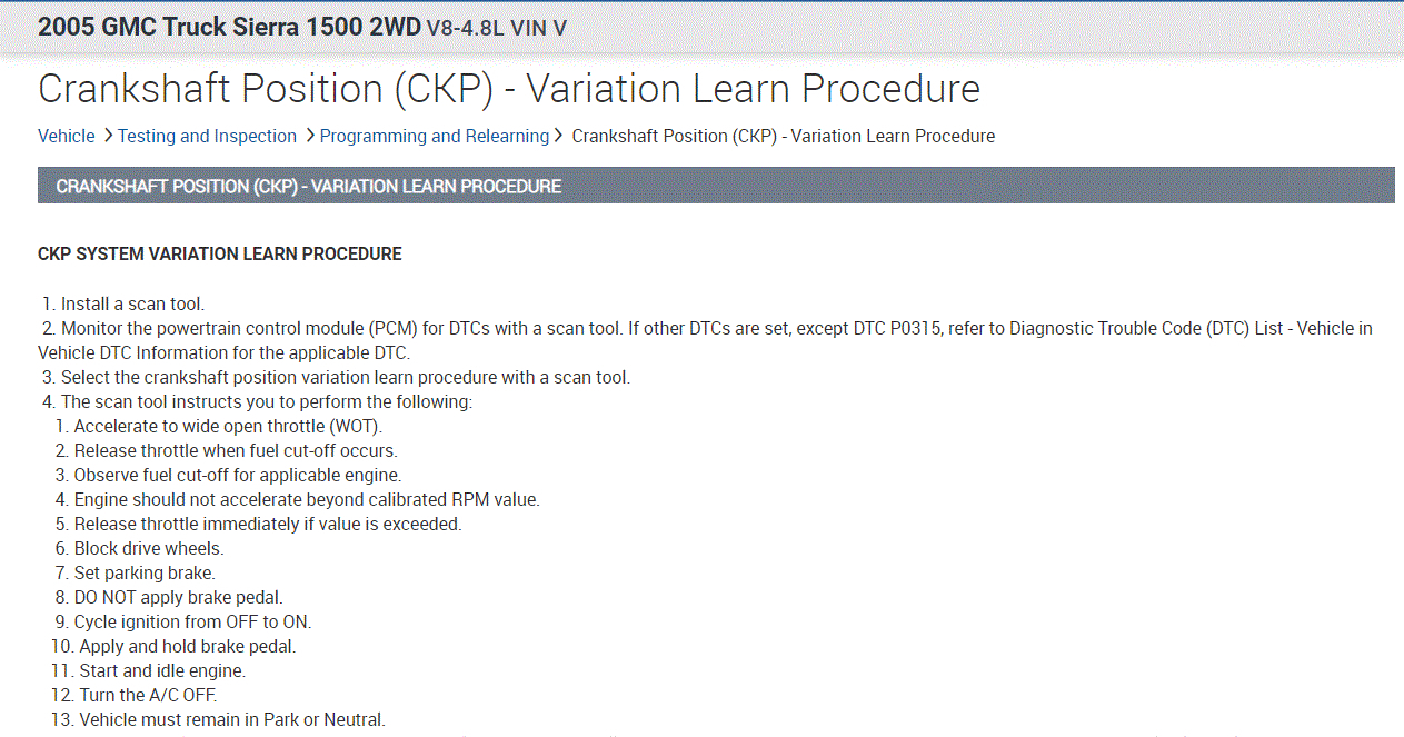

If you look at the attachments below, they provide the directions specific to your vehicle. Also, the last two pics provide the variation relearn procedures.

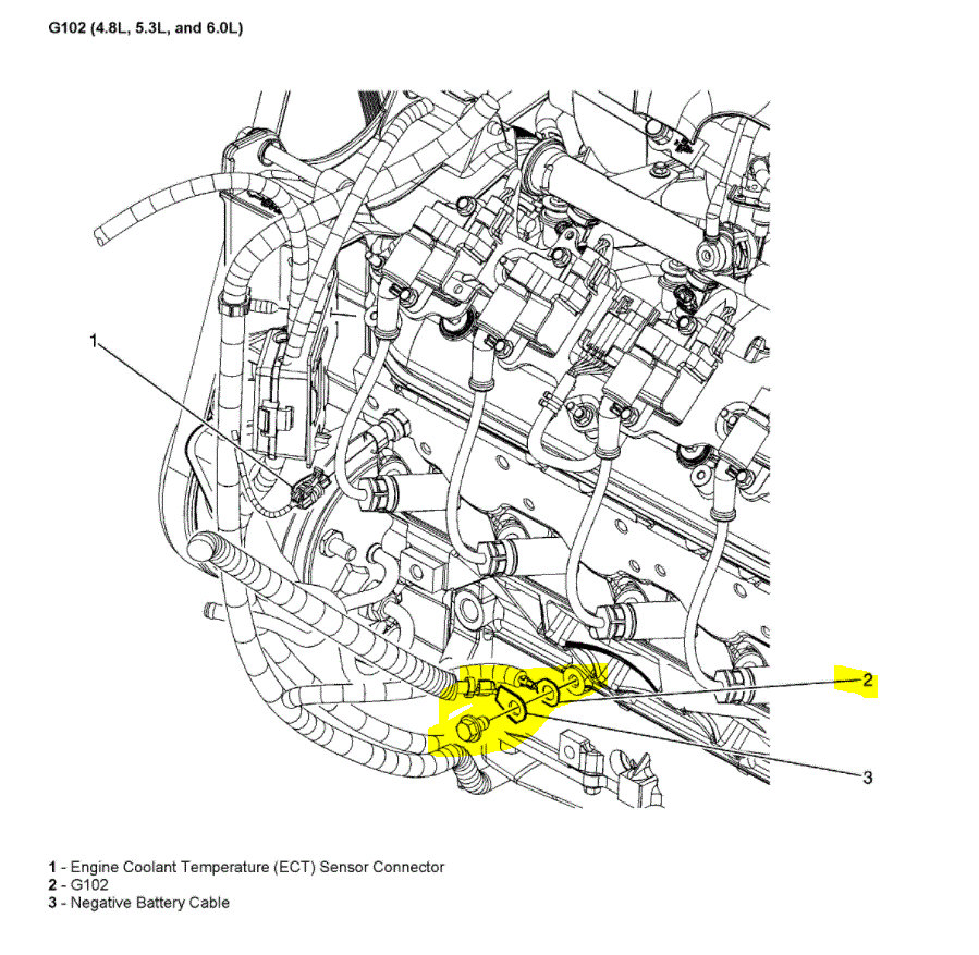

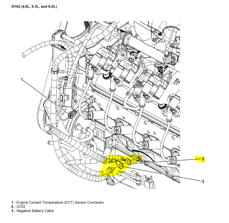

There is one more thing I would like you to check if you haven't. On the left side of the engine (driver's side), there will be a black wire attached to the engine block. It is a ground for the ignition coils. All coils are grounded by that one ground.
The grounds are known to fail due to corrosion and they can become weak and the actual connector to the engine can break. If you have a weak connection, ignition spark could be the problem. I attached a pic below showing the wire and its location that I am referring to. Make sure to check it. Move it around to confirm it's tight and the connector doesn't break. Also, make sure the wiring to it is in good condition and there isn't a lot of corrosion where it mounts.
Also, if you have a live data scan tool, please confirm the coolant temperature sensor is sending the correct signal. If it isn't, it too can be causing issues.
