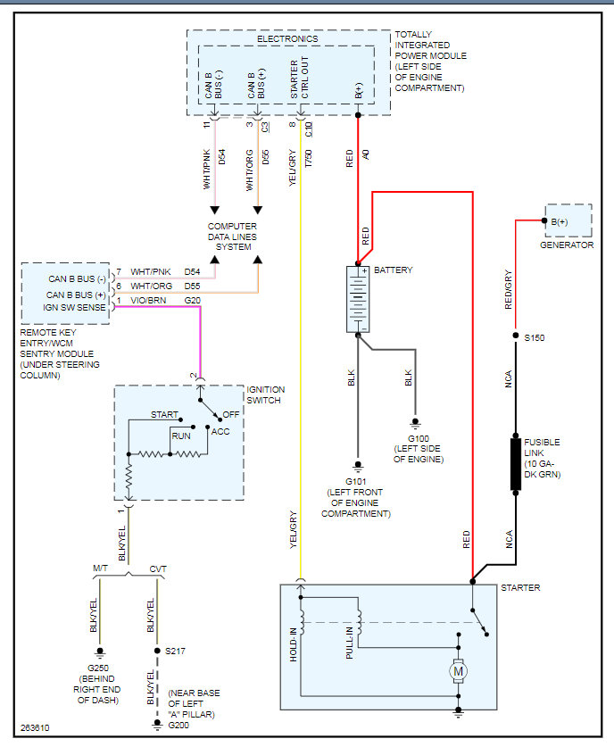

We need to check the starter for voltage on the red wire and then the yellow wire when cranking the engine. I suspect you will have voltage on the red wire and that should be there all the time.
The yellow wire should only have 12 volts when cranking the engine. If it does then the starter is the issue. If not then we have either a TIPM issue or sentry key system issue.
Also, we should check the codes just to see if there is something there that points us in the right direction.
Let us know this info and we can go from there. Thanks

Try this test. Have a helper turn the key to the start position while you check for power at the smaller wire on the starter. You should have 12v. If you do, there is still a problem with the starter. If there is no power, check the starter relay.
