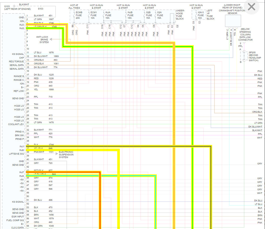

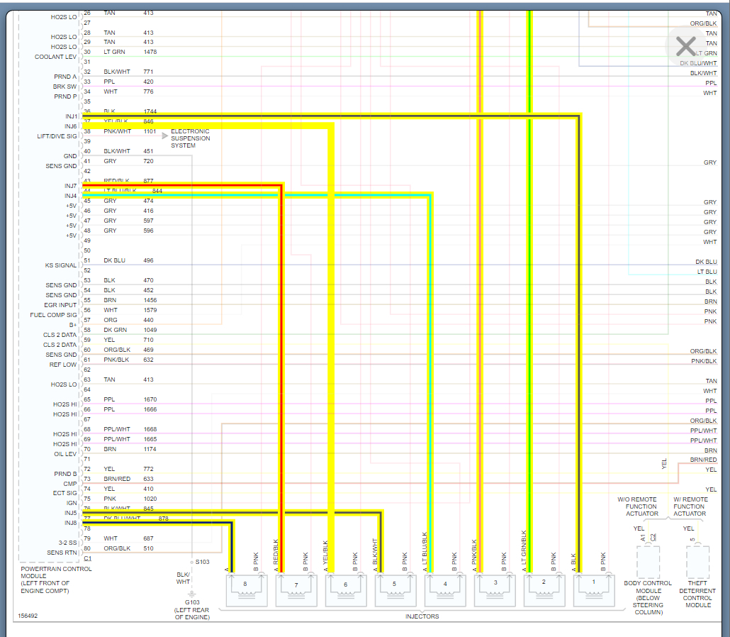

We did a motor swap. It is a 5.3L, the new engine has only 1,200 miles on it and is out of a 2002 Avalanche. Should have been a plug and play. We have done several similar motor swaps for other people and they turned out great. We are not getting so lucky with ours. We have been throught the VATS relearn procedure twice. The first time with the avalance computer. It seemed to relearn it successfully, no security codes with either computer now. We started off with the avalanche wiring harness, when it would not start, we changed it back to the original wiring harness. We now have the original wiring harness and computer back in the truck. We have fuel to the rails, power to the injectors, but no pulse. We have been fighting this for a few days now, and nothing works. The only sensor that has not been changed back to the original one, is the cam sensor. The motor that came out of the truck actually still ran like a champ. We decided to do this because the original motor and transmission had 175,000 miles on them and we had bought the motor about 3 years ago, and just recently had a transmission rebuilt for the one that was starting to have some minor issues. This was a perfectly running truck when we parked it in the shop last weekend and started this project. We are at our wits end trying to figure out what is wrong...

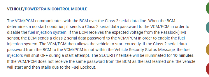

When you say you have been through the vehicle theft learn system does the theft light remain on or flash?
If it does then that explains what is happening and we have not figured out why the theft system is active.
I suspect we are going to have to start with checking for codes to find out if we have any codes that will help with point to the issue.

Here is a guide that will help with resetting the system which may do what we need to get this reset:
https://www.2carpros.com/articles/how-to-reset-a-security-system
However, if none of this works then we need to know what codes are there and go from there.
