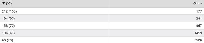

another key if security system is still hooked up then check fuses under hood check resistance of crank sensor should be 800-1200 ohms and do a wiggle test on connection as it may be bad or poor. check coolant sensor for ohms as well see pics even though you replaced pump check at rail with a gauge auto parts rent it. 41-47 psi key on
