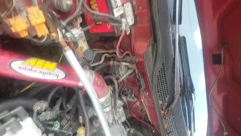

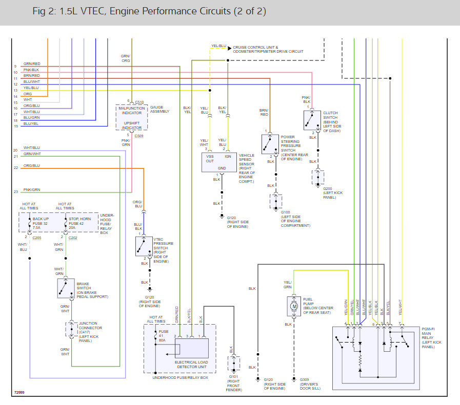

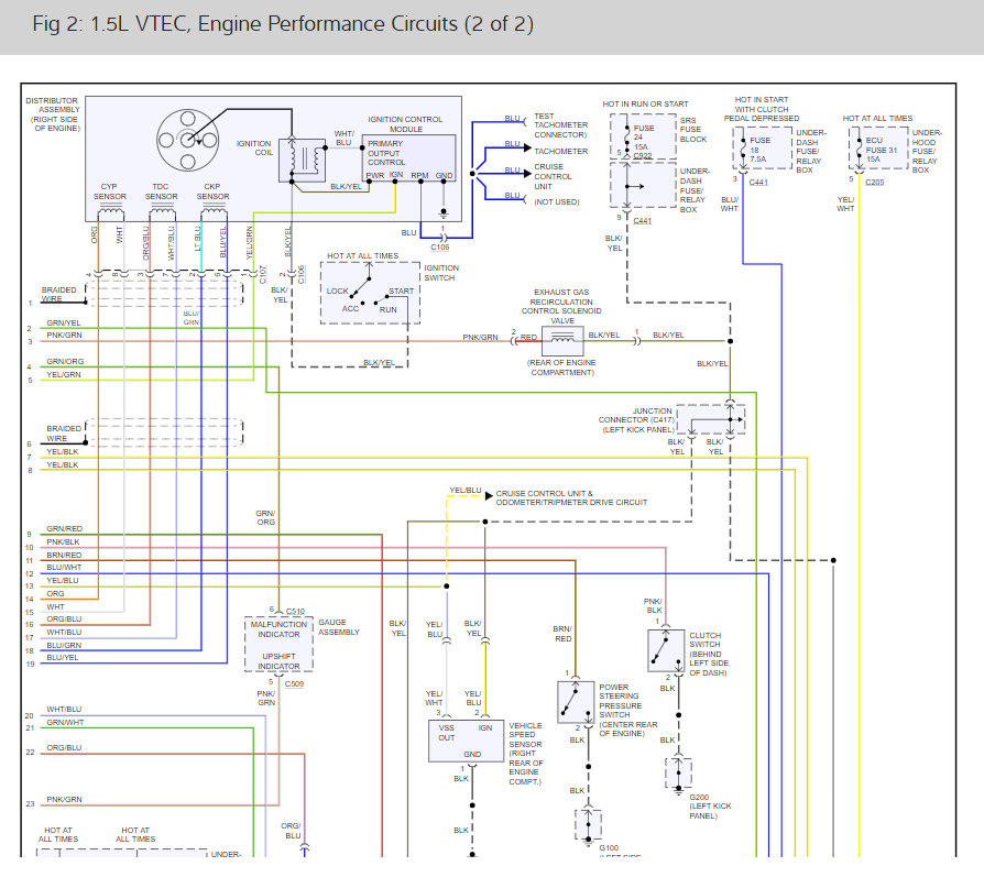

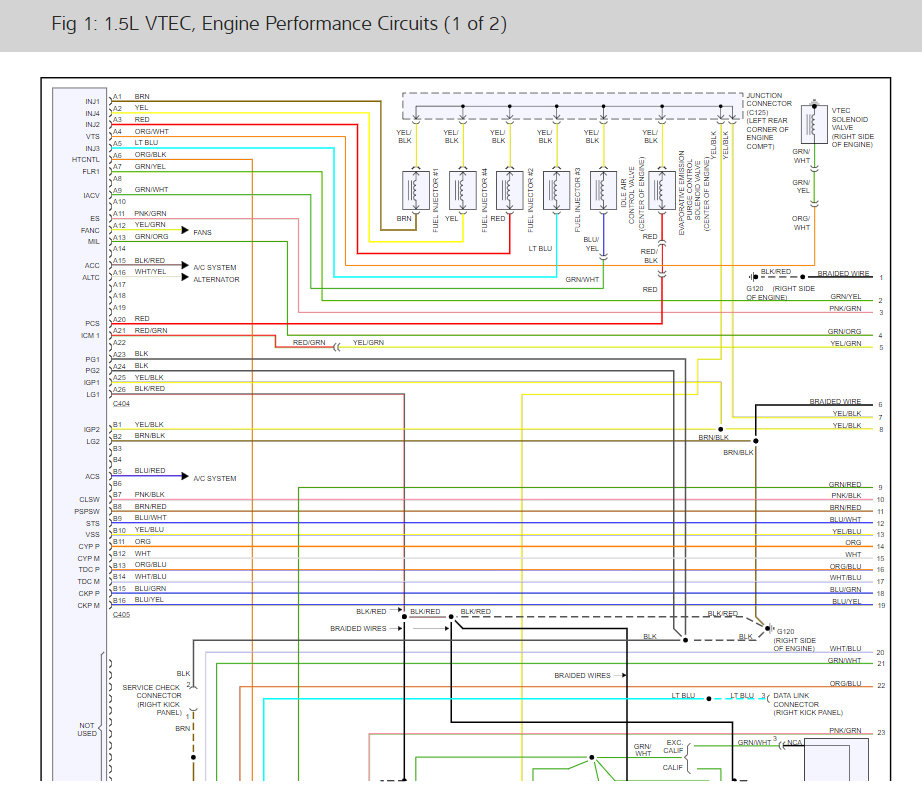

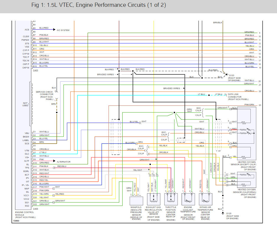

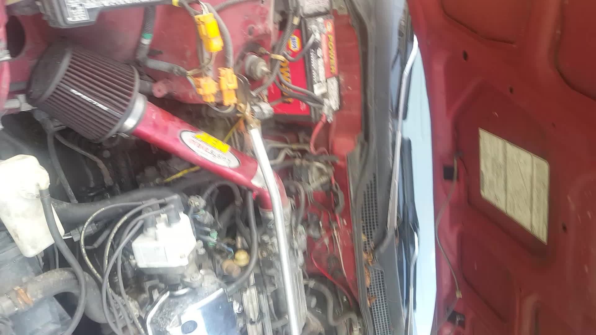

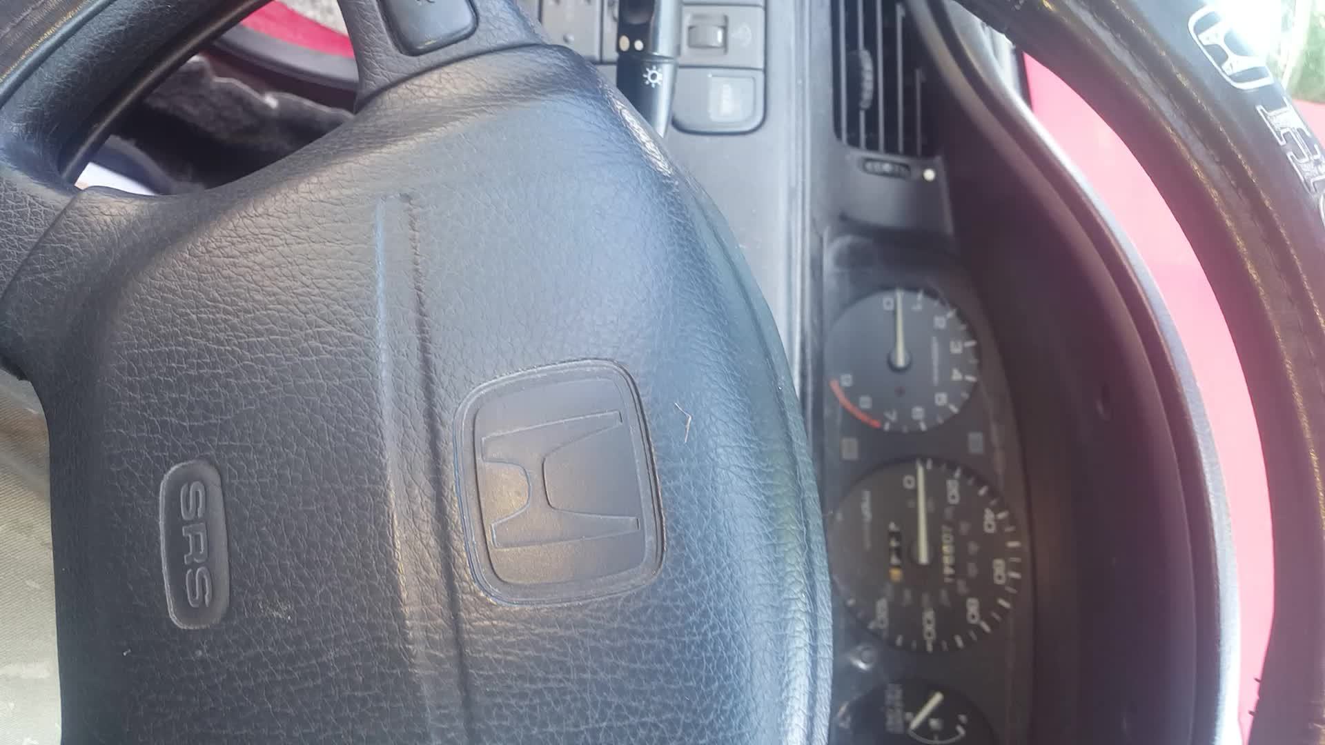

I have a jdm d15b vtec. it will not rev past 4,000 rpm's. if I jump power to vtec solenoid it will rev to 5,500 it has a 7,000 rpm red line. I've checked for codes and there are none. I've tried swapping ECU and still same problem.
Aug 28, 2019 at 12:49 PM
  • 55,721 POSTS

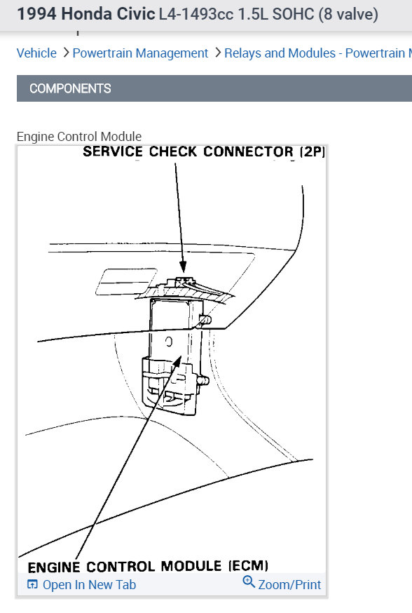

If it doesn't blink it means there are no codes. have you checked the engine oil level? Vtec will not work if the oil is low. Can you check it and get back to me?
Aug 31, 2019 at 5:48 AM
JOHN6996
Yes, oil is full.
Aug 31, 2019 at 11:18 AM
  • 55,721 POSTS
Also the engine must be at operating temperature before Vtec will work doe the engine have a thermostat?
Sep 1, 2019 at 3:50 AM
JOHN6996
Yes, it has a working temperature gauge that goes into the normal range. I also pulled and checked the screens I do notice that it hunts for idle wen it's warmed up sometimes but no code for the IAC working.
Sep 3, 2019 at 2:59 PM
  • 55,721 POSTS
It sounds like the PCM is bad. To be sure lets check the wiring between the Vtec and ECU. here is a guide and the engine wiring diagrams so you can see which wires to test:

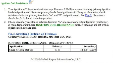

RJASON11
  • 5 POSTS
Thank you for your time. My Civic has 178K miles on it. When the engine is cold, especially in the mornings, it has plenty of power and response. On a hot afternoon, after sitting in the sun, it's a little less power. The main symptom is almost exactly 8 minutes into my drive, the idle goes down (from 800 to 550 roughly), the engine gets noisier (valve sounding, I think), and I lose a significant amount of power. The idle change is well past the FITV stage, and a good 5 minutes past the engine being brought up to operating temperature. Based on my fuel gauge being much higher (2/3 full) than it usually is after 160miles on this tank, I'm guessing it's running lean, or that the timing is off. If I stop the car, wait five minutes, and start it again, the problem persists. So, the power loss is clearly a matter of temperature. If I wait 3 hours, I have power again, for 8 minutes. I'm going to test the fuel pressure, check timing, and replace the oxygen sensor this weekend. I don't want to throw 20 parts at it, so I'm hoping you can help me prioritize things. Cooling system works great, timing belt/water pump are new, throttle body is clean, TPS tests perfectly. After turning off my car, CAT is 280 degrees before and 380 degrees aft. Vacuum stabalizes at 18 pretty responsively. My car doesn't have an EGR. Not likely main relay, because it seems more engine temp dependent, than cabin temp dependent. PCV is new. Oil is GTX 5W30 and is in good shape. Fuel pump primes. Coil meets Haynes resistance specs. Distributor is only two years old. Disconnecting MAP stalls engine. Spark plugs have gas carbon on ring, white ceramic looks great, tip looks a bit on the white side. The valves were adjusted recently. Air filter looks great.
Another note. The idle seems to stabalize at a different level every time. The RPMs drop, hang a little at 900, then continue to 700, or 800, or 600, depending on the mood of the car. I noticed that when the car has power this idle tends to settle more in the 800 or 900 and when it's lost power it settles in the 600 area.
The power loss can be described as similar to the loss you get when turning on the AC, only double that. It isn't jerking, or stalling, it just feels light on the pedal. An inch of accelerator movement, might only slightly, slowly, begin to think putting some torque on the wheels. Golf carts have more power.
So, I'm thinking Knock Sensor, replace all vacuum lines, Ignitor, Improper timing belt installation, ECT sensor, or Crank Sensor. As a novice, I'd love to have an expert help me. I have a feeling the symptom of having power when cold, but not when hot can narrow the sensor/timing troubleshooting down.
THANKS AGAIN for your time.
Robert Jason
Aug 8, 2020 at 4:22 AM (Merged)
RJASON11
  • 5 POSTS
Fuel filter is new also. Injectors were cleaned with B-12 in the tank. Combustion chambers were cleaned with water sprayed into the brake line vacuum.
I also ran a compression test. Compression is a bit higher than the 185 spec in the manual, more around 205, but all cylinders had close readings +/- 7 psi.
For good measure I made sure the valve cover GND wire, and the sensors GND wire on the thermostat had a solid connection. Battery tests good cold and running.

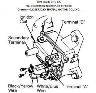

KHLOW2008
  • 41,812 POSTS
Hi Robert,
Sorry for the delay in asnwering as your question got me scratching my head as well.
The ECT readings are within specs so should not be a problem.
Vacumn leakages would not cause power losses unless it is substantial which would be easily detected.
For fuel to be causing the problem, it would more likely to happen during sudden acceleration or only at a higher engine rpm and this can be caused by fuel supply amount and pressure.
If it happens during initial acceleration, it would more likely to be pressure related, which does not seem to be the case here.
If the power loss is when you are pushing the rpm higher up and it takes forever to reach the peak, then it could be due to insufficient amount of fuel getting to the injectors.
Running overly lean for prolonged periods is definitely not good for the engine. Many people would like to be in your shoes, getting more mileage, lol.
If the ignition coil is providing weaker sparks, it should be running rich instead of lean. The ignitor provides the sparking and you do not have problems with starting and engine running so should not be responsible.
Knock sensors are only for the VTEC models.
You did not mention anything about the the ignition timing setting, is it set at 16 degrees at 620 to 720 rpm at idling?
The high compression rate seems odd, as the standard is only 185 psi. Was the head ever refaced or repaired?

Hi Robert, Thank you for the feedback. From the 3 items listed, I would say the ignition coil has the highest probability. When ignitor goes bad, it would more likely cause difficult startinig and engine stalling rather than power loss. If it is electrical, it would be more consistent and would happen under any condition. That leaves us with the ignition coil. Test the sparks, they should be bright blue and not dull yellow. Test the coil resistance to see if they are within specs.
https://images.2carpros.com/forum/automotive_pictures/192750_IgnitionCoilResistance94Civic_1.jpg
https://images.2carpros.com/forum/automotive_pictures/192750_IgnitionCoil94Civic_1.jpg
