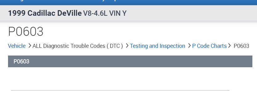

The codes are P0603 and P1604.
Friday, May 10th, 2019 AT 9:41 AM
SCGRANTURISMO
  • 4,897 POSTS

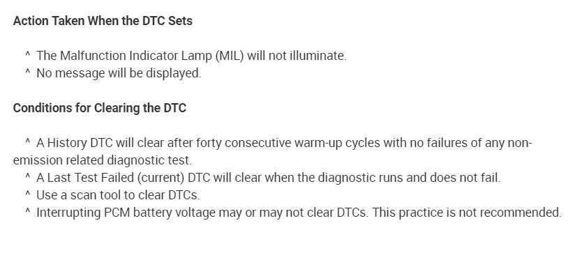

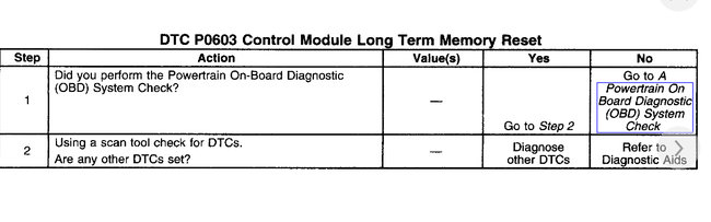

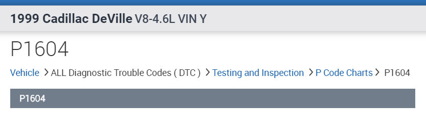

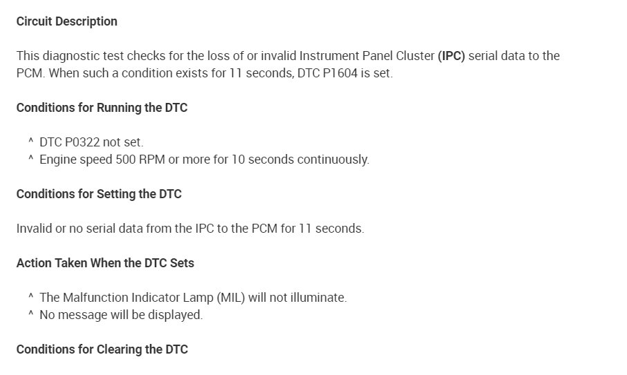

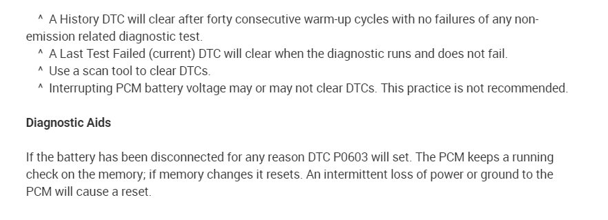

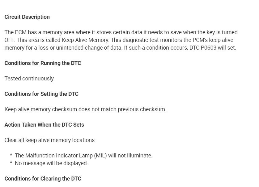

Hello again,
Here is the information that you requested on both DTC's P0603 and O1504. Please go through these guides and get back to us with what you are able to find out.

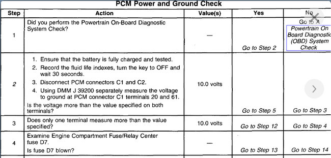

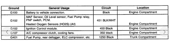

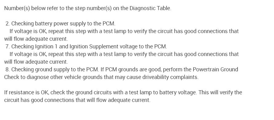

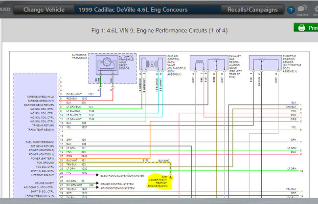

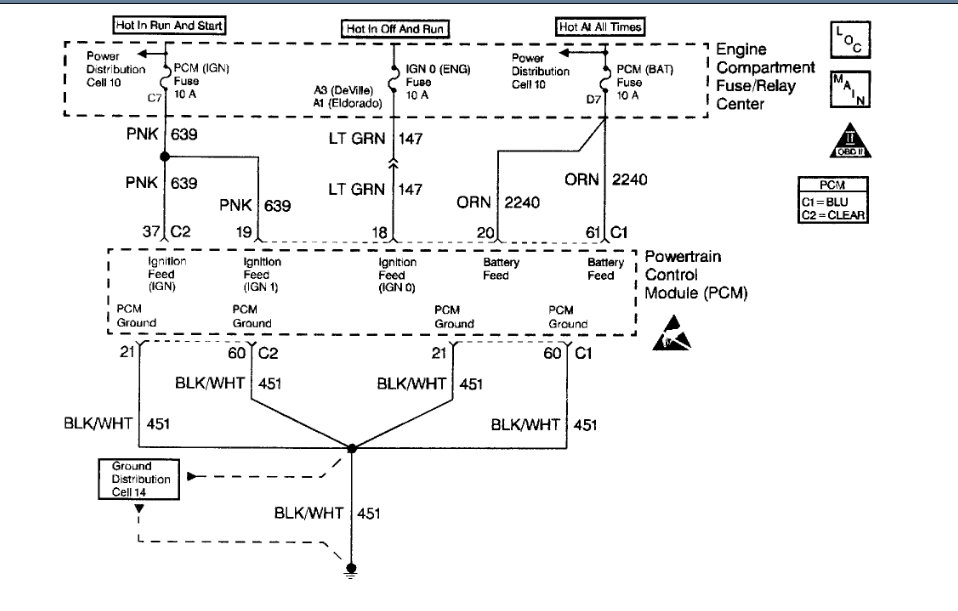

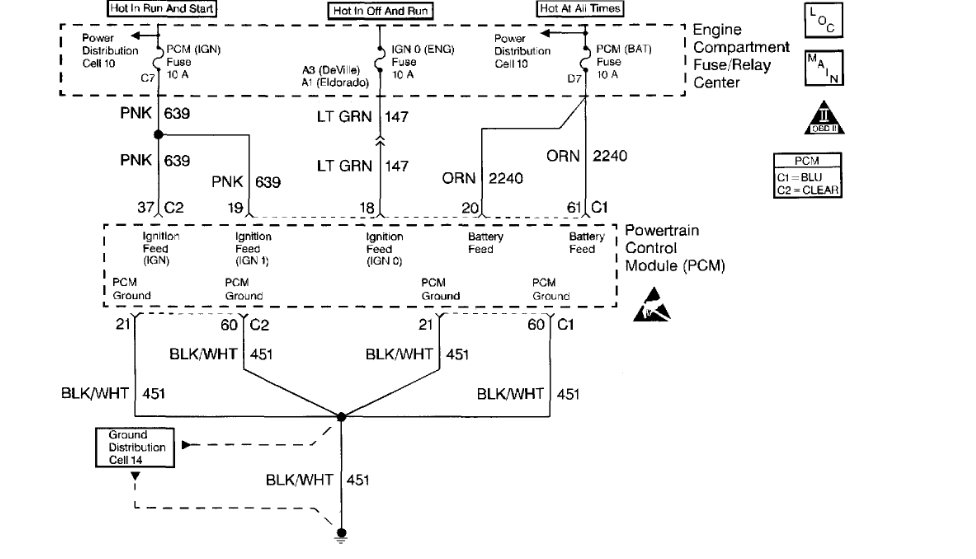

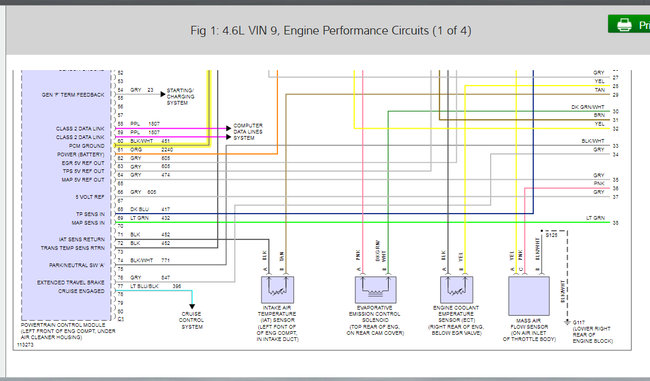

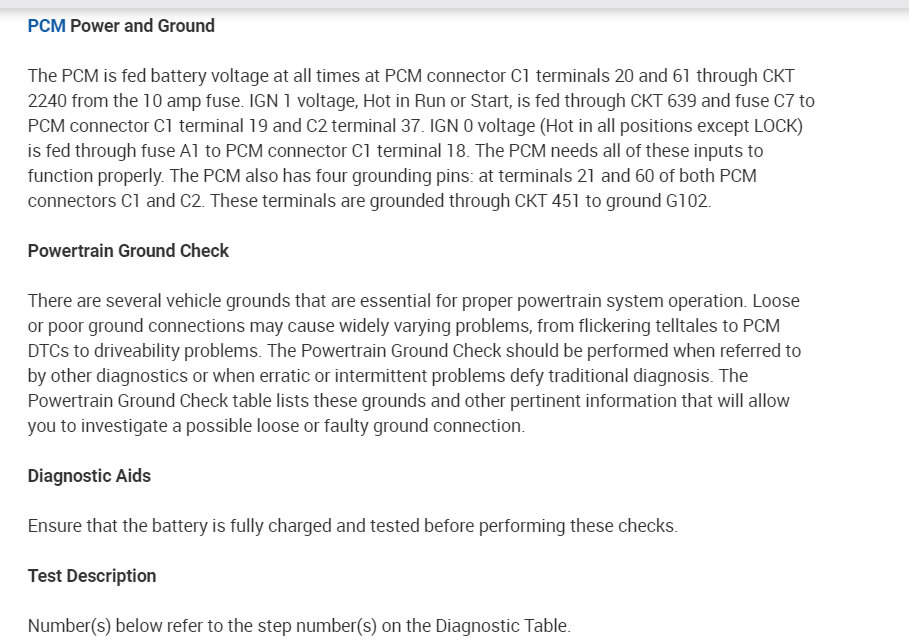

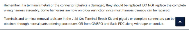

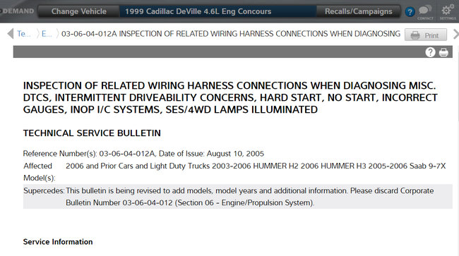

Hello again,

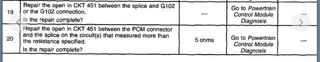

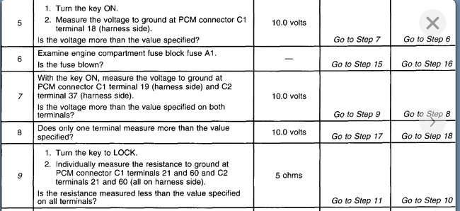

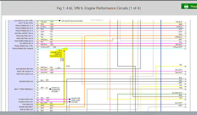

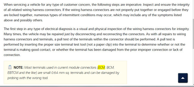

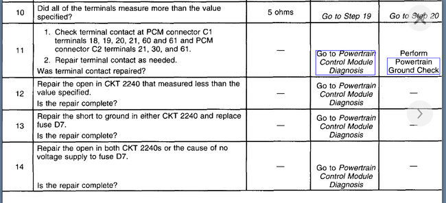

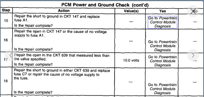

Okay. Just to be sure it's not just a bad ground, I have included a PCM wiring diagram as well as a factory PCM Ground and Power Troubleshooting Guide in the diagrams down below. A bad ground can cause a variety of problems, and a new PCM would make no difference with a bad ground, so let's check it out to make sure. Please go through the guide and get back to us with what you are able to find out.
Thanks,
Alex
