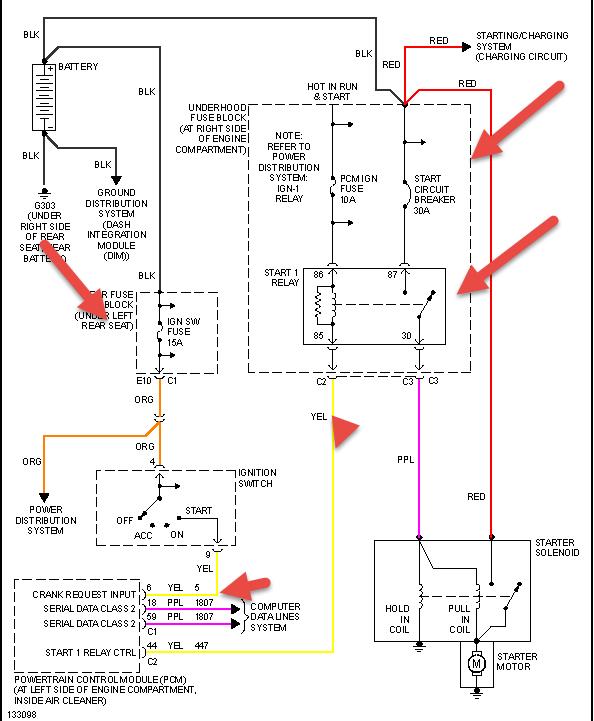

HMAC300
  • 48,601 POSTS
Okay, hopefully you have checked all the fuses, etc. There is a crank circuit breaker before the relay that can kick off and not give the relay power. However, there is a yellow wire from the ignition switch to the PCM it goes to number six on the PCM. then it leaves the PCM at C2 to go to the relay. The ignition switch fuse is in the fuse block under the rear seat. Also, clean the battery ground which is under the rear seat by the battery. It could be loose as well.

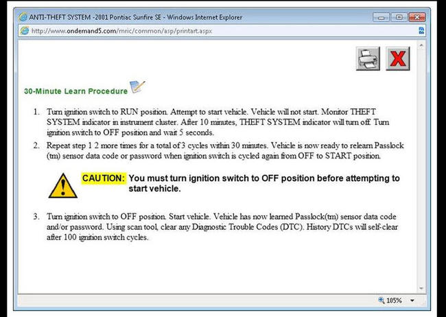

HMAC300
  • 48,601 POSTS
Try resetting security system if still does the dash light thing have it scanned.It may be a body module or dash.

6TOBYDOG
  • 5 POSTS
Well I tried that procedure twice and had the same results. I had this same problem with I think it was a 1994 Buick Park Avenue, it was a little white wire off the ignition, but not sure if this is the same setup on my 2000 Deville. Do you know or have anymore ideas? Thank you so much for your help.

HMAC300
  • 48,601 POSTS
See picture for start diagram and check what I have pointed out. You have three fuse block on this car. One under hood and one under left rear seat and one in trunk. Make sure you check all the fuses especially under hood and rear seat. You may have a bad dash module as well but would need scanning for that.
