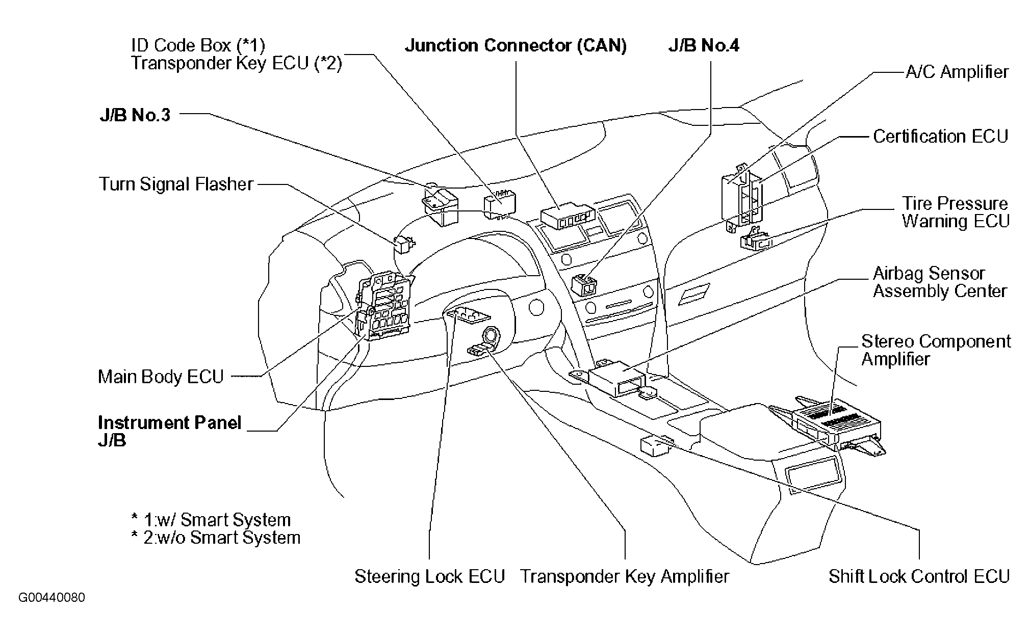

Also, start checking every fuse in the panels under the hood and under the left hand side of the dashboard (drivers side).

the sub model is LE. i check all the fuses under the hood i did not find any blown. i could not find the fuse box under the dash. can you send me pictures of the fuse box?

it is located up under the dash, center of the driver's seat. here is a diagram.

i do not see anything say fuse box in the diagram. will i be interfering with the air bag?

yes, and if you have pulled wires out of the ignition module/coil pack or whatever. Theres no telling if you have shorted out the ECM with wires touching or connecting them to the wrong wires and sending voltage back on circuits it shouldn't be on. There could also be more blown fuses you have yet to find. And yes there is a fuse panel under the dash, its J/B (junction Box)/.
