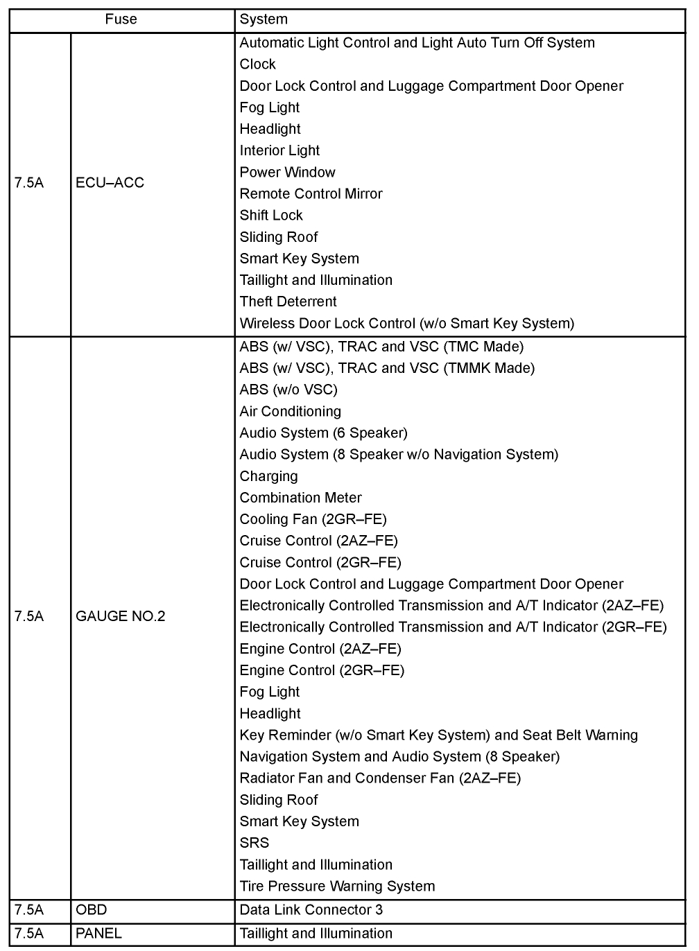

The connector to the coil was loose on number two coil. I replaced new spark plugs and when I disconnect the connector from the coil the connector broke. the engine was starting before I did that, but now it wont start; no firing, no fuel pump coming on. I do not know what could have happened. if the connector wires touch each other will that cause the engine not to fire and fuel pump not working? What all do I need to check to fix the problem? why it not firing and fuel pump not coming on? Please help.

Have you tried to scan the computer for codes? That should be your first step. Here is a link to show you the process.

no i have not scan the computer since the engine not firing or fuel pump not working. the engine was starting until the wire connector to the coil number two broke. where are the fuses located? i would like to check the fuses first to see why the spark plugs are not firing and the fuel pump is not coming on. i do not have a scanner i always take the car to advance part store. they scanned the computer yesterday the car was in working order these or the codes: P0C0210, P0215, P0300, P0301, P0303, P0304.

Fuse box will be in engine compartment.

do this car just have only one fuse box it don't have one inside the car do a fuse work the fuel pump or do it show a fuel pump fuel?

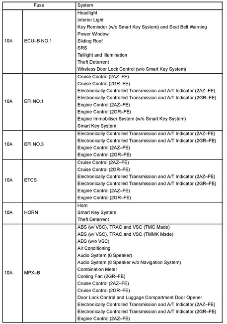

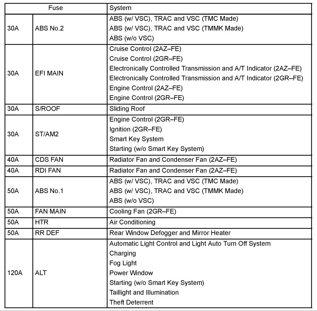

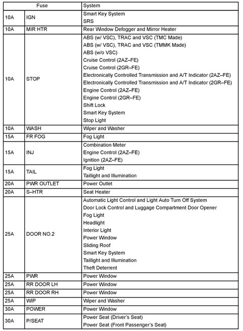

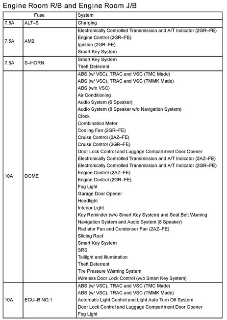

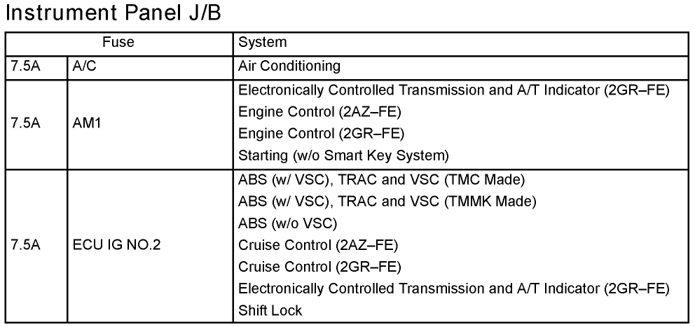

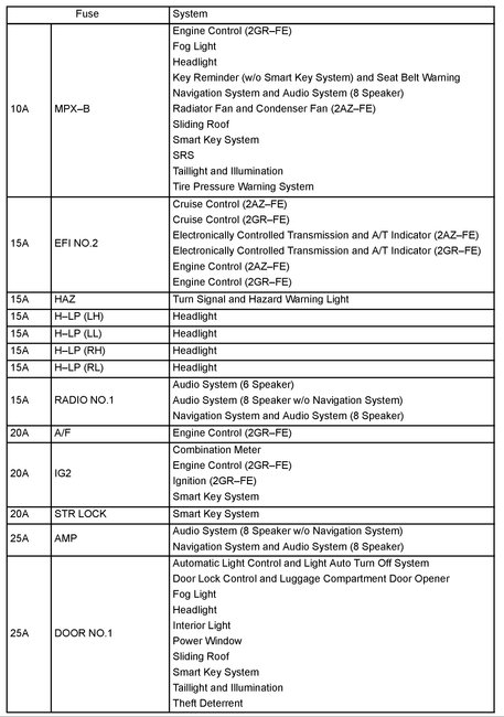

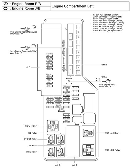

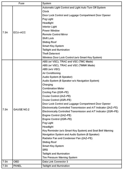

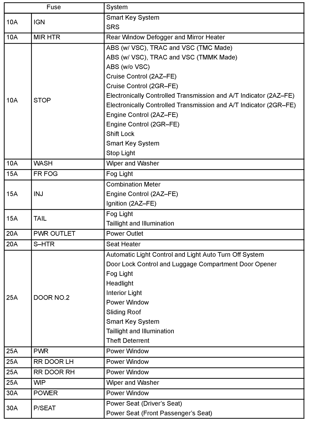

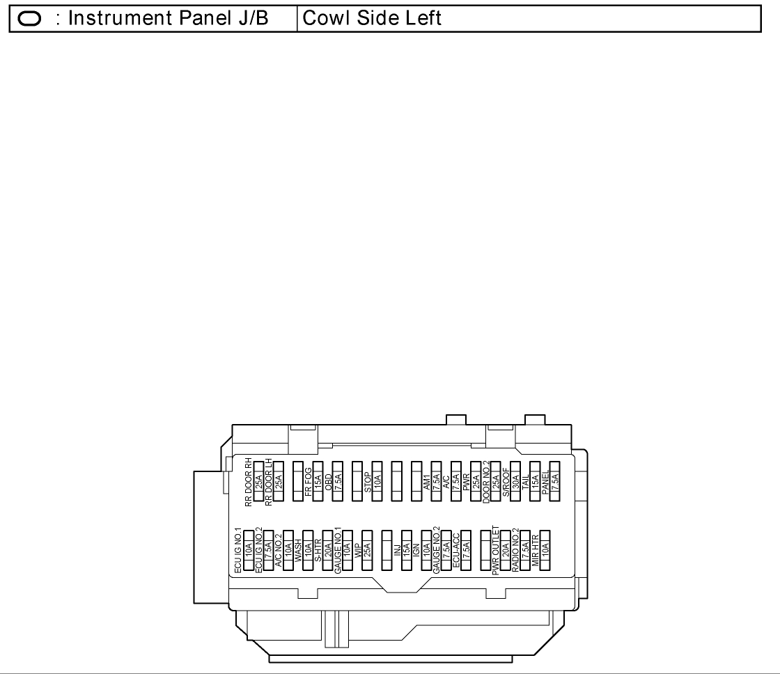

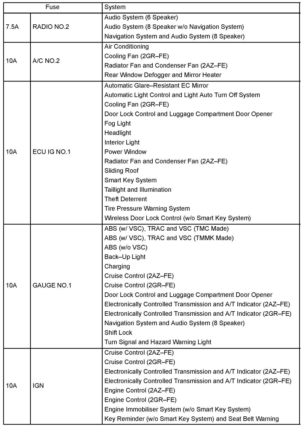

Anything with ignition or fuel will be in the engine compartment. Fuses inside the vehicle will be for body like illumination, radio, sunroof, etc... But here are some images.
Oct 19, 2016 at 11:59 AM
JIS001
  • CAR REPAIR CONTRIBUTOR
  • 3,412 POSTS
Pay close attention to the EFI main fuse. That is what powers up the computer.
