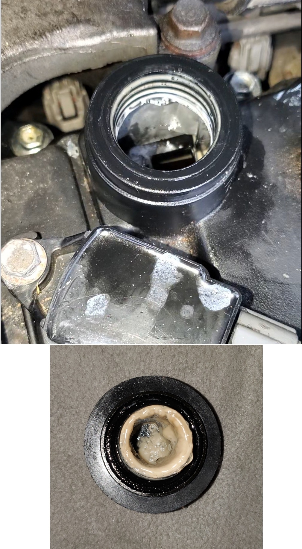

I assumed i had a blown head gasket because my radiator had a leak, and my car ran hot. The next day i changed the oil and filter because it was like chocolate milk and bought a new radiator and Bars Head Seal (Blown Head Gasket Repair). Put that in and topped it with coolant, started the car and let it run with the heat on for 15-20 minutes (until the temperature gauge started rising) and the coolant reservoir was bubbling up and the brand-new oil is chocolate milk looking again. What else can i do to try and fix it?

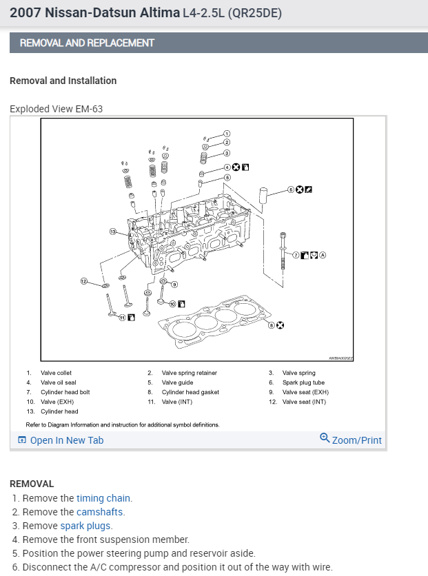

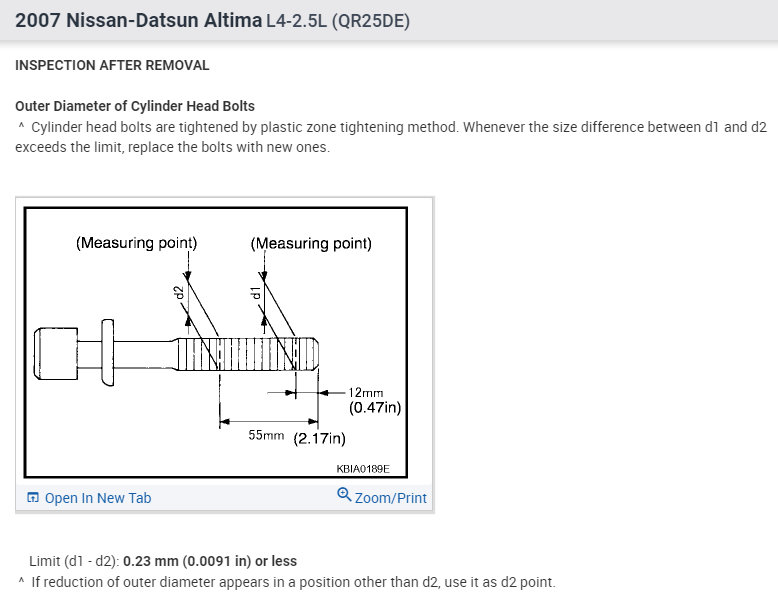

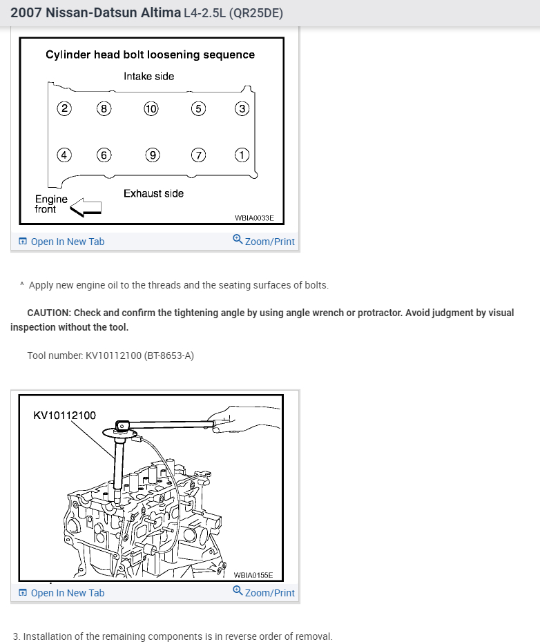

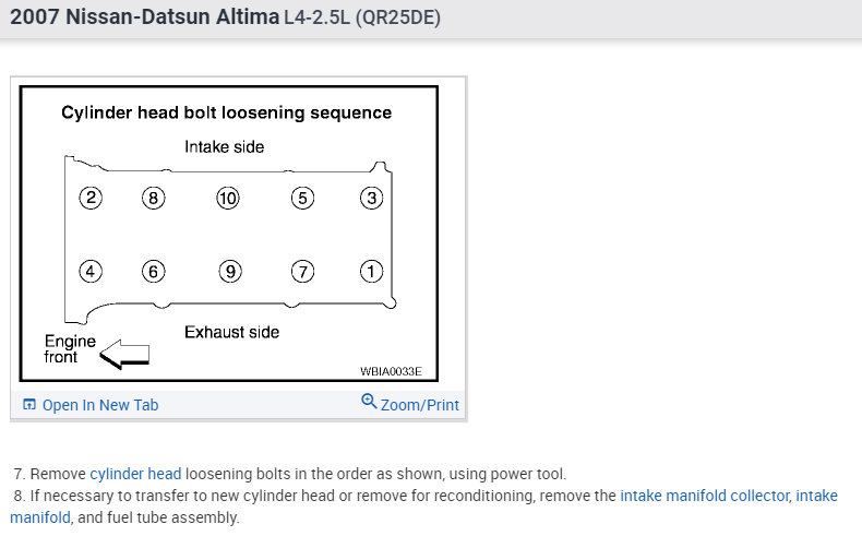

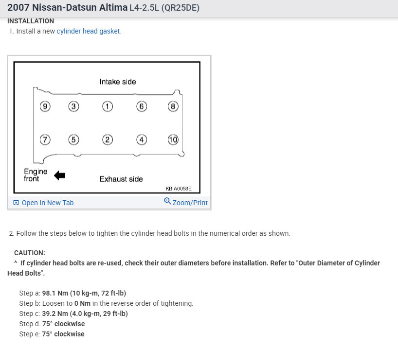

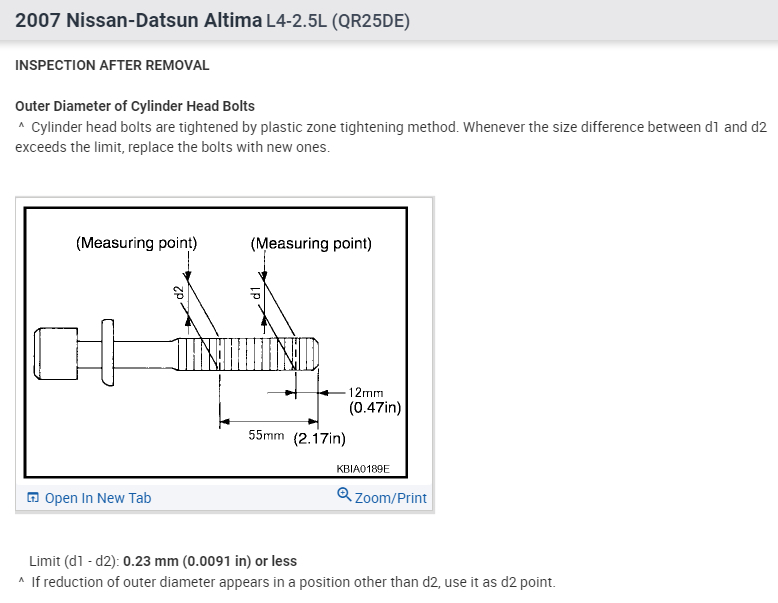

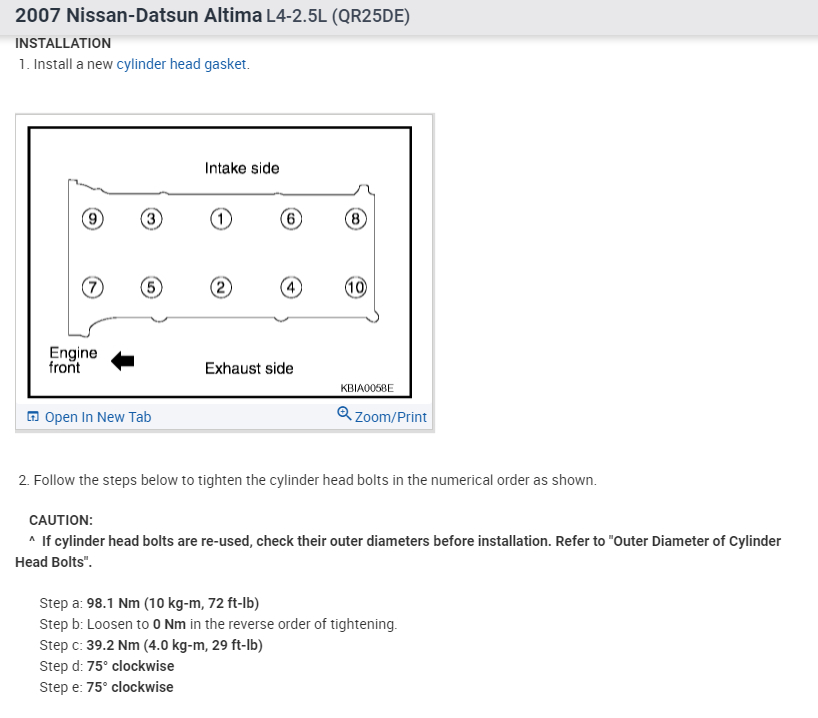

Overheated engine can warp the cylinder head which will leak coolant into the engine. When a head gasket fails the best repair is to replace the head gasket and possibly machine the cylinder head if needed.
Keep in mind that those chemical sealer works sometimes but not consider as a fool proof option.
Please let me know of any questions or concerns.

Unless the blown head gasket is repaired the engine will keep overheating. As it appears that the Bars head seal is not able to fix the leak. As you know these leak sealers are not fool proof and only works sometimes.
