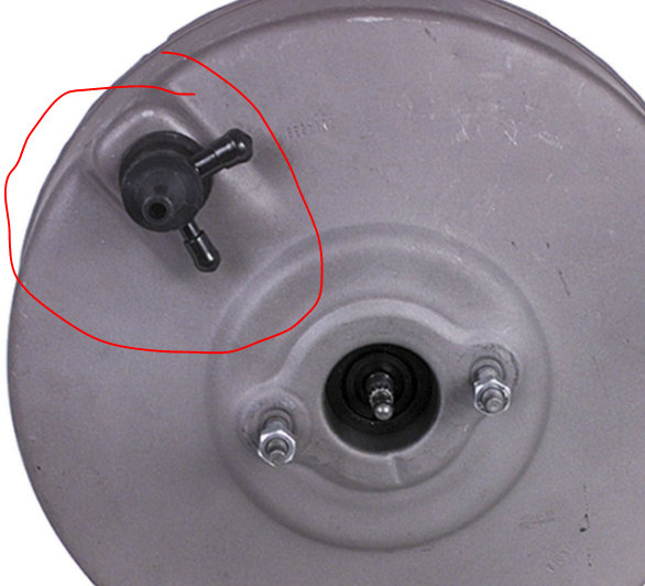

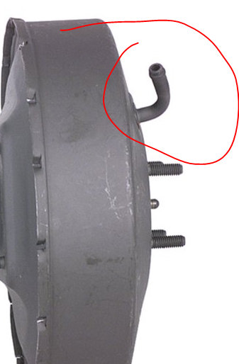

Where is this check valve located on the brake booster?
Thank you Sir.
Oct 22, 2021 at 5:01 AM
SQM
  • 6,383 POSTS
Depending on the type of booster the check valve can look different.
Can you upload a picture of the brake booster?

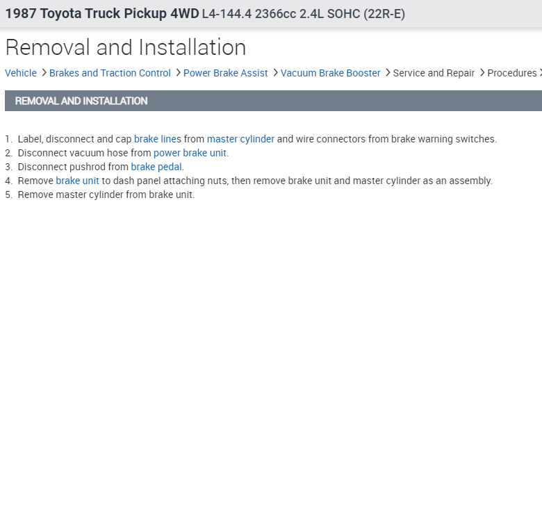

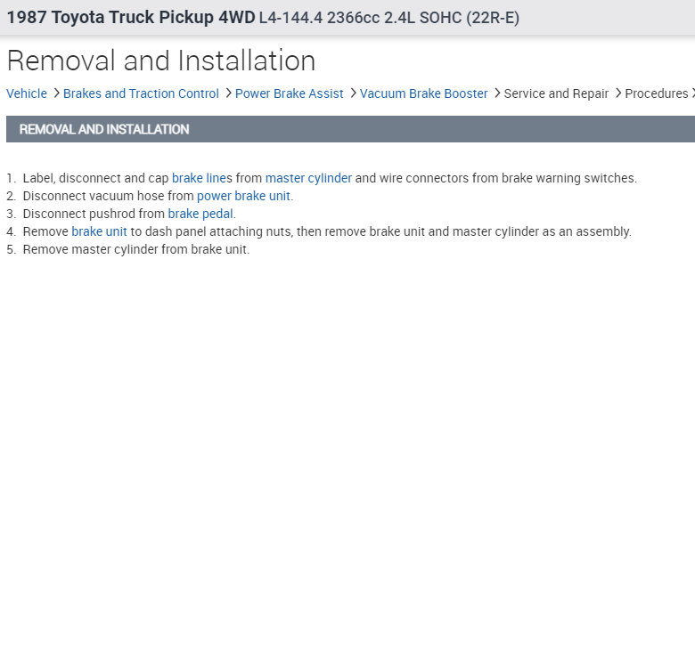

No worries. Those pictures are the two different type of boosters for that truck.
