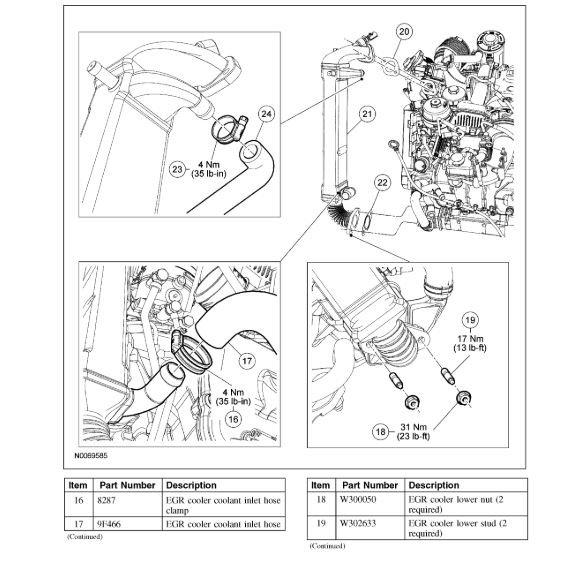

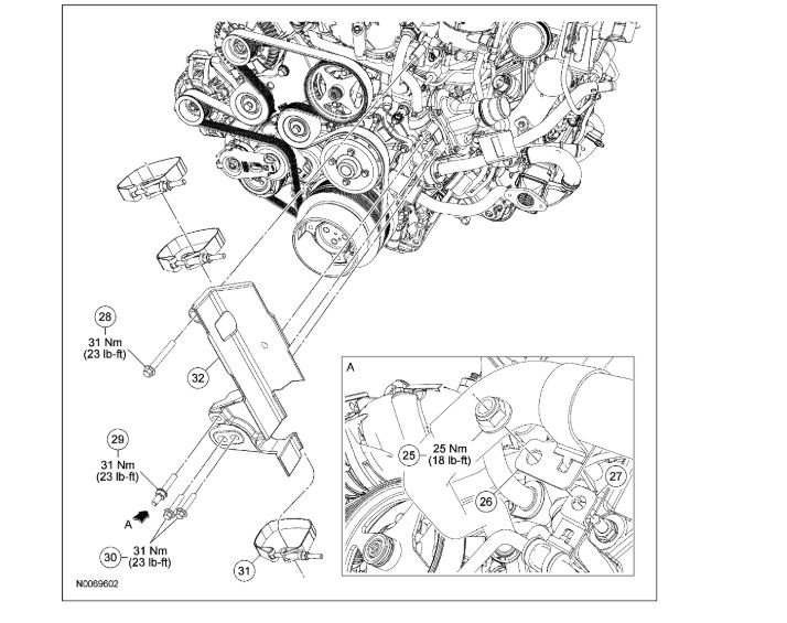

Good afternoon,
The most common cause is the EGR cooler. When it leaks, coolant gets into the exhaust and cause the engine to smoke white.
Can I have the complete VIN so I can find out whether you have a vertical or horizontal cooler?
Jan 2, 2020 at 12:35 PM
JOSEPHBEST23
  • 7 POSTS
It's vertical. but would that cause the turbo to whine?
Jan 3, 2020 at 9:23 AM
No, but the coolant passing through the turbo would cause it. It is thinning out the oil.
Jan 3, 2020 at 11:17 AM
JOSEPHBEST23
  • 7 POSTS
Okay, thanks. I hope that wouldn't be an automatic turbo change?
Jan 3, 2020 at 11:47 AM
Pretty much. The bearings have been damaged for the water in the system.
