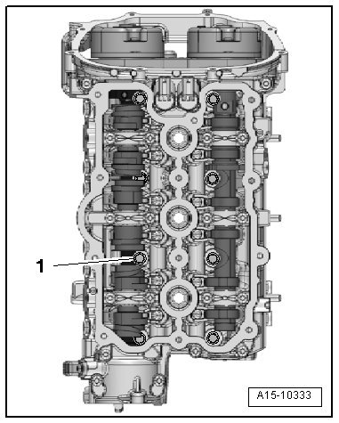

- Remove the intake manifold lower section. Refer to => [ Intake Manifold Lower Section with Fuel Rail, Removing and Installing ] See: Intake Manifold > Removal and Replacement > Intake Manifold Lower Section with Fuel Rail, Removing and Installing.
pic 1

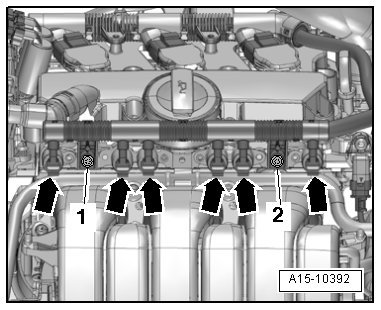

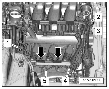

- Disconnect the connectors on the fuel injectors.

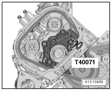

- Remove the left and right timing chain covers. Refer to => [ Left and Right Timing Chain Cover, Removing and Installing ] See: Timing Cover > Removal and Replacement Left and Right Timing Chain Cover, Removing and Installing.

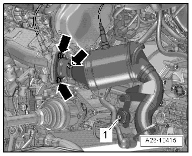

Vehicles without a secondary air injection system:
pic 2

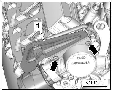

- Remove the left front muffler. Refer to => [ Front Muffler, Removing and Installing ] See: Muffler > Removal and Replacement > Front Muffler, Removing and Installing.
- Remove the nuts - arrows - and the bolt - 1 -.
- Remove the left catalytic converter from the exhaust manifold and lay it aside.
The installation location is shown with the engine removed.

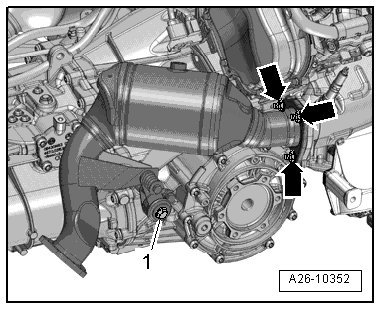

- Remove the right front muffler. Refer to => [ Front Muffler, Removing and Installing ] See: Muffler > Removal and Replacement > Front Muffler, Removing and Installing.
- Remove the nuts - arrows - and the bolt - 1 - and move the catalytic converter to the side.

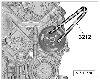

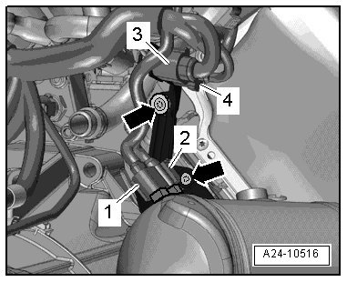

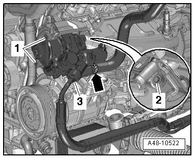

- Remove the bolts for the coolant pump ribbed belt pulley, using a Wrench - Pin Type (3212) to counterhold.
- Remove the bolts - 1 - and - 2 - and lay the power steering pump aside.

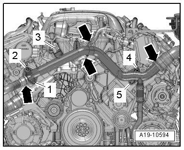

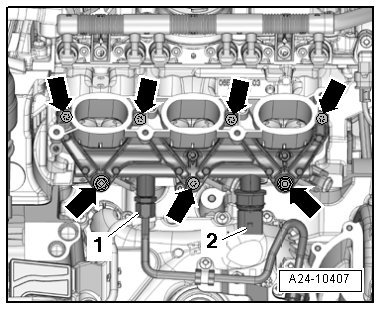

- Remove the bolts - 1, 2, 4 and 5 - on the front coolant pipe.
Ignore the - arrows -.

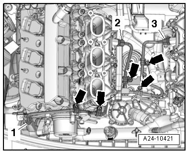

- Remove the threaded connection - 1 - and the union nuts - 2 - and - 3 -.
- Remove the bolts - arrows - on the retaining plates and the high pressure line.
- Remove the threaded connection - 2 - and move the fuel supply line to the side.

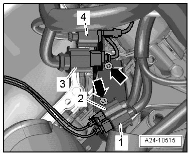

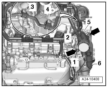

- Disconnect the connectors - 1 - and - 6 -.
Ignore - items 3, 4 and 5 - and - arrow -.
- Disconnect the right and left electrical connectors - arrows - on the camshaft adjuster actuators.

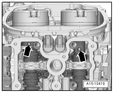

- Remove the cylinder head cover. For the left side. Refer to => [ Left Cylinder Head Cover, Removing and Installing ] See: Valve Cover > Removal and Replacement > Left Cylinder Head Cover, Removing and Installing and for the right side refer to => [ Right Cylinder Head Cover, Removing and Installing ] See: Valve Cover > Removal and Replacement > Right Cylinder Head Cover, Removing and Installing.
- Disconnect the connector - 3 - on the Camshaft Position Sensor (G40).

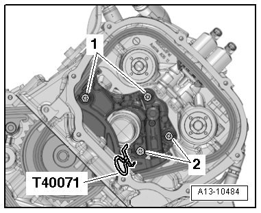

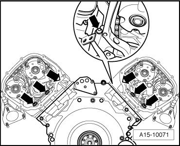

- Remove the left and right timing chain covers => [ Left and Right Timing Chain Cover, Removing and Installing ] See: Timing Cover > Removal and Replacement > Left and Right Timing Chain Cover, Removing and Installing.
- Remove the bolts - arrows - and the bracket for the left connectors.

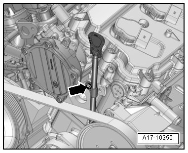

- Remove the bolt - arrow - and remove the oil dipstick with the guide tube.
pic 13

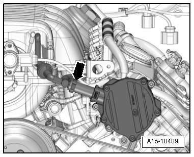

- Remove the vacuum hose from the vacuum pump - arrow - and free it up.

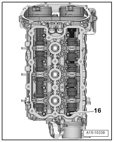

- Remove the bolts - arrows - on the rear of the cylinder head.
pic 15
Left cylinder head: 3 bolts.
Right cylinder head: 4 bolts

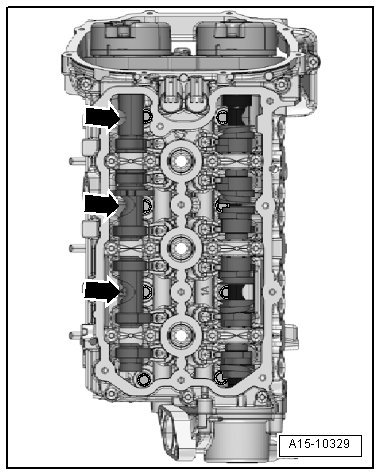

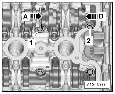

The cams on the intake camshaft partially restrict access to the cylinder head bolts, such as bolts - 1 - and - 2 - shown in this example.
oic 16
The slider on the camshaft must be pressed in the direction of - arrow A - using a plastic wedge to remove the bolt - 1 -.
The slider on the camshaft must be pressed in the direction of - arrow B - using a plastic wedge to remove the bolt - 2 -.
Risk of damage.
The camshaft slider must only slide in the base-circle phase, that is the rocker arm on the slider that will be moved must not be loaded with a cam. When loosening the cylinder head bolts, follow the sequence described in the following instruction.
There is a risk of it breaking.
The camshaft sliders must not slide on the thin ribs.

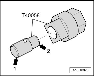

- Insert the Crankshaft Socket (T40058) guide pins as follows:
pic 17
The large diameter - arrow 1 - faces the engine.
The small diameter - arrow 2 - faces the adapter.

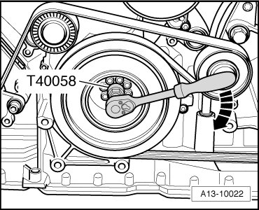

- Rotate the crankshaft in the direction of engine rotation - arrow - using the Crankshaft Socket (T40058) until the camshaft position shown in the following illustration is reached.
pic 18
The openings - arrows - on the exhaust camshafts must face toward the outer side of the engine as shown in the illustration.

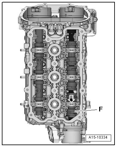

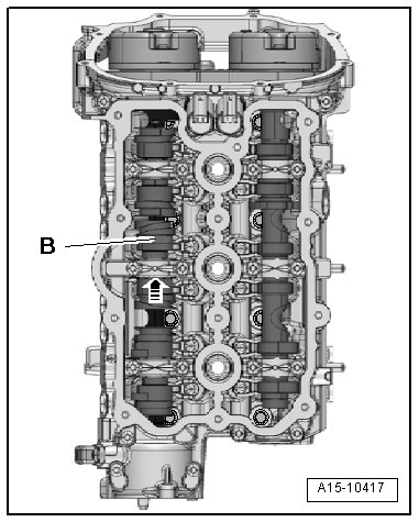

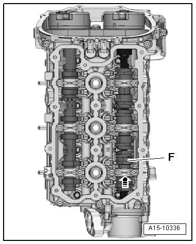

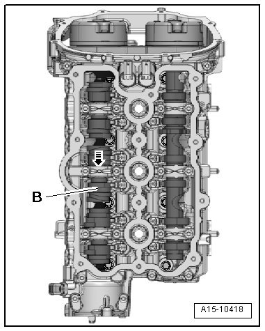

- Slide the unloaded camshaft slider - B - as far as the stop in the direction of the - arrow -.
pic 21
- Slide the unloaded camshaft slider - F - as far as the stop in the direction of the - arrow -.

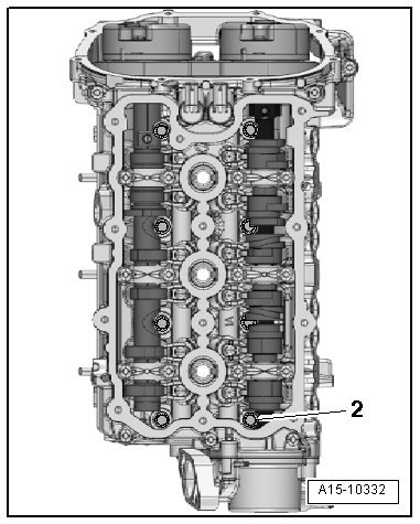

- Remove the bolt - 1 -.
pic 25
- Remove the bolt - 2 -.

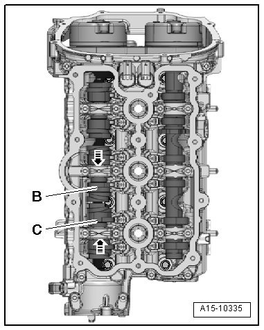

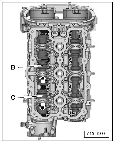

Left cylinder head:
pic 28
- Slide the unloaded camshaft sliders - B - and - C - as far as the stop in the direction of the - arrow -.

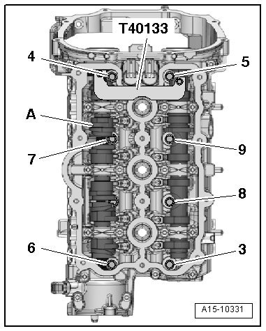

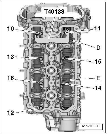

- Remove the bolts - 3 through 9 - while sliding the unloaded camshaft slider - A - accordingly.
- Remove the cylinder head.
pic 33
- Remove the bolts - 10 through 16 - while sliding the unloaded camshaft sliders - D - and - E - accordingly.

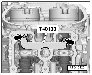

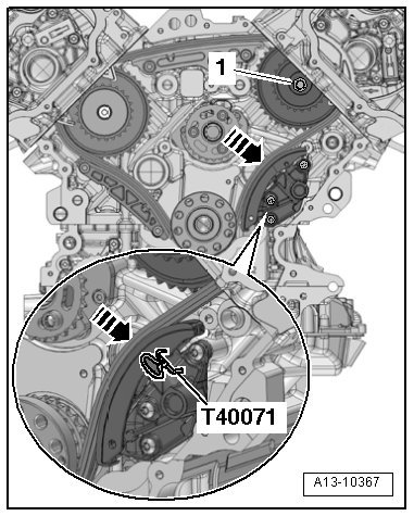

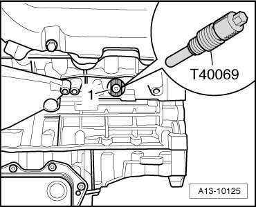

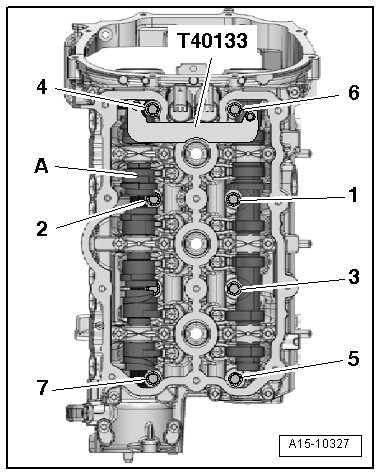

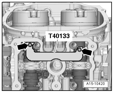

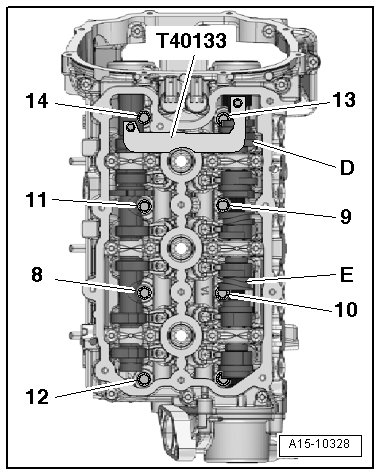

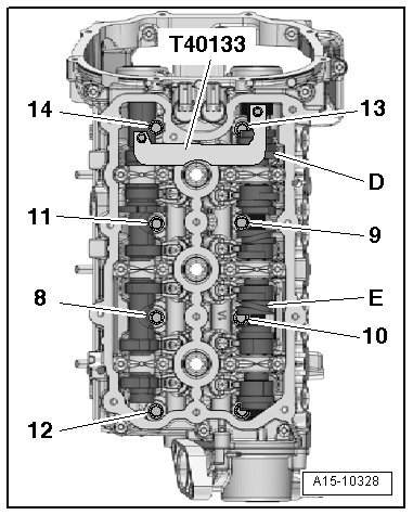

- Before installing the cylinder head, set the crankshaft and camshafts to "TDC" and install the Camshaft Clamp (T40133) on both cylinder heads and tighten to 25 Nm - arrows -.
pic 34
The Camshaft Clamp (T40133) is correctly positioned when the holes for the cylinder head bolts remain free.
Crankshaft Locking Pin (T40069) must be screwed into the crankshaft.
pic 35

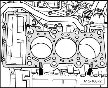

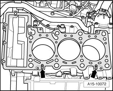

- Set cylinder head gasket in place.
pic 36
Pay close attention to centering pins - arrows - in cylinder block.
Cylinder head gasket installation position: "open" (top) marking or part number toward cylinder head.

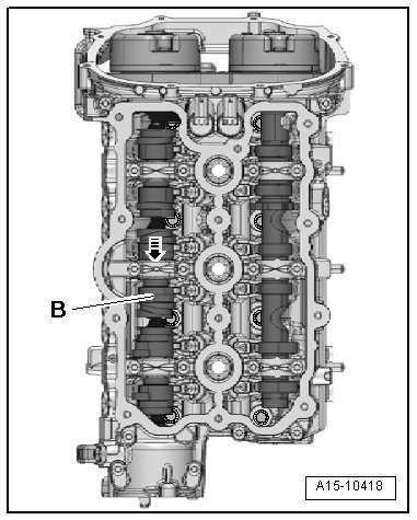

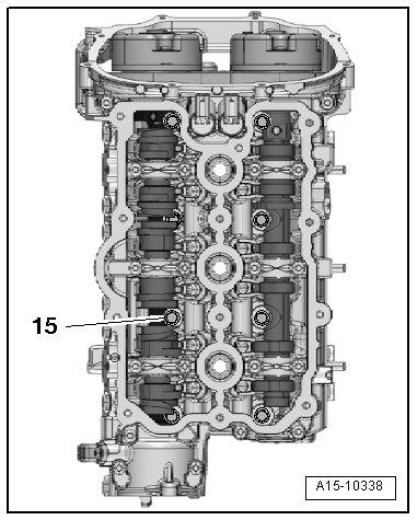

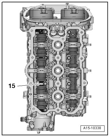

Left cylinder head:
pic 45
- Insert the bolt - 15 - and tighten it in 3 steps. Refer to => [ Overview - Cylinder Head ] See: Cylinder Head Assembly > Removal and Replacement > Overview - Cylinder Head.
pic 46
- Insert the bolt - 16 - and tighten it in 3 steps. Refer to => [ Overview - Cylinder Head ] See: Cylinder Head Assembly > Removal and Replacement > Overview - Cylinder Head.
Continuation for both cylinder heads:
pic 47
- Turn the crankshaft one full revolution (360°) in the direction of engine rotation - arrow - using the Crankshaft Socket (T40058).
The openings - arrows - on the exhaust camshafts must face toward the outer side of the engine.
pic 48
Left cylinder head:
pic 49
pic 50
pic 51
- Tighten the bolts - arrows -.
Do not tighten cylinder head bolts after repairs.
Install in reverse order of removal. Note the following:
- Install oil dipstick guide tube. Refer to => [ Oil dipstick guide tube - tightening specifications ] See: Cylinder Head Assembly > Removal and Replacement > Overview - Cylinder Head.
- Position the camshaft timing chain on the camshafts. Refer to => [ ] See: Timing Chain > Removal and Replacement > Camshaft Timing Chain, Removing from Camshafts.
- Install the cylinder head cover. For the left side. Refer to => [ Left Cylinder Head Cover, Removing and Installing ] See: Valve Cover > Removal and Replacement > Left Cylinder Head Cover, Removing and Installing and for the right side refer to => [ Right Cylinder Head Cover, Removing and Installing ] See: Valve Cover > Removal and Replacement > Right Cylinder Head Cover, Removing and Installing.
- Install front coolant pipe. Refer to => [ Front Coolant Pipes, Removing and Installing ] See: Coolant Line/Hose > Removal and Replacement > Front Coolant Pipes, Removing and Installing.
- Install the power steering pump.
- Install the left catalytic converter: for vehicles with manual transmissions. Refer to => [ Left Catalytic Converter, Removing and Installing ] See: Catalytic Converter > Removal and Replacement > Left Catalytic Converter, Removing and Installing. For vehicles with the multitronic 0AW or automatic transmission 0B6. Refer to => [ Left Catalytic Converter, Removing and Installing ] See: Catalytic Converter > Removal and Replacement > Left Catalytic Converter, Removing and Installing.
- Install the right catalytic converter: for vehicles with manual transmissions/manual transmission 0AW. Refer to => [ Right Catalytic Converter, Removing and Installing ] See: Catalytic Converter > Removal and Replacement > Right Catalytic Converter, Removing and Installing. For vehicles with the automatic transmission 0B6 or automatic transmission 0B6. Refer to => [ Right Catalytic Converter, Removing and Installing ] See: Catalytic Converter > Removal and Replacement > Right Catalytic Converter, Removing and Installing.
- Install the front muffler. Refer to => [ Front Muffler, Removing and Installing ] See: Muffler > Removal and Replacement > Front Muffler, Removing and Installing.
- Install the plenum chamber bulkhead.
- Install the high pressure line, fuel supply line and the lower section of the intake manifold. Refer to [ Overview - Intake Manifold Lower Section with Fuel Rail ] See: Fuel Rail > Removal and Replacement Overview - Intake Manifold Lower Section with Fuel Rail.
- Install the ribbed belt. Refer to [ Ribbed Belt, Removing and Installing ] See: Drive Belt Removal and Replacement Ribbed Belt, Removing and Installing.
- Install the upper coolant pipe. Refer to [ Upper Coolant Pipes, Removing and Installing ] See: Coolant Line/Hose Removal and Replacement Upper Coolant Pipes, Removing and Installing.
- Change the engine oil.
- Replace the coolant. Refer to [ Coolant, Draining and Filling ] See: Cooling System Procedures Coolant, Draining and Filling.

pic 52
If the running direction is reversed on a used camshaft timing chain, it could be damaged.
Paint arrows to mark the left and right camshaft timing chain running direction so they can be installed again. Do not mark camshaft timing chain with punch, notch or something similar.
- Remove the Locking Pin (T40071) and the left camshaft timing chain.
- Remove the bolts - 1 - and - 2 - and the right chain tensioner.
pic 53
- Press the timing mechanism chain tensioner guide rail in the direction of the - arrow - and secure the chain tensioner using a Locking Pin (T40071).
pic 54
- Loosen the drive chain sprocket bolt - 1 - 1 turn.
- Tilt the drive chain sprocket with the mounting pins to the side slightly and remove the right camshaft timing chain upward.
Installing
Tightening specification. Refer to => [ Overview - Camshaft Timing Chains ] See: Timing Chain > Removal and Replacement > Overview - Camshaft Timing Chains.
If the tensioner was removed from the chain tensioner, then pay close attention to the installed position: the hole in the bottom of the housing faces the chain tensioner and the piston faces the tensioning rail.
Replace the bolts which are being tightened with an additional turn.
Risk of damaging valves and piston crowns.
If camshafts are rotated, crankshaft may not rest with any piston at "TDC".
- Position the left camshaft timing chain according to the markings made during removal as shown in the illustration.
pic 55
- Press the guide rail for the left camshaft timing chain tensioner down and secure the chain tensioner using a Locking Pin (T40071).
- Guide the right camshaft timing chain on the drive sprocket mounting pins while noting the markings made during removal.
pic 56
- Tighten the mounting pin bolts - 1 -.
- Remove the Locking Pin (T40071).
- Insert the chain tensioner at the right cylinder head and position the camshaft timing chain.
- Tighten the bolts - 1 - and - 2 -.
