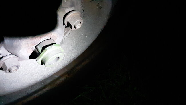

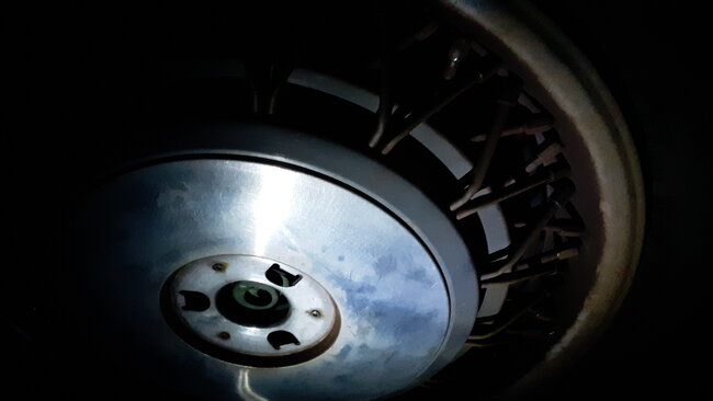

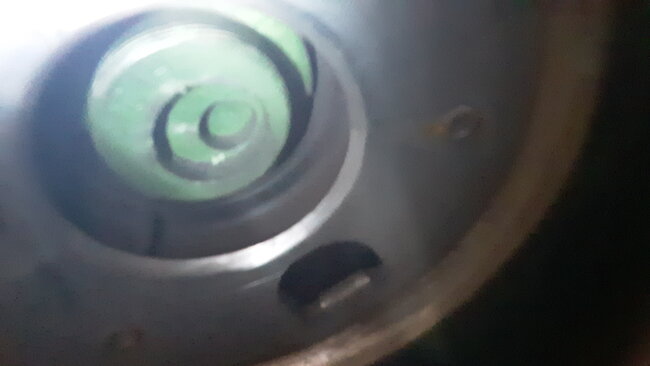

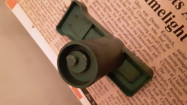

Working with the car listed above, I was all set to remove the wire wheel cover from both front wheels and begin the operation.
Using the special Buick tool to remove the cover, I had no problem with the passenger side wheel. But when I moved to the driver's side, the tool did not seat itself properly, and the does not move all the way inside the tool channel, for some reason. (See photo, below, of Buick OEM removal tool)
Of course, I made sure the raised post on the tool was exactly positioned over the cover's tool channel pilot hole before attempting to un-thread the plastic nut.
Because the tool kept slipping out of the hole, I halted operations until I had a better way to remove the driver side wheel cover's plastic nut.
Any suggestions on how to use the GM tool on a wheel cover whose tool channel does not permit me to seat the tool properly?
(To loosen the plastic cover assembly nut, I have sprayed the area with isopropyl alcohol, hoping it would penetrate the plastic nut threads. Liquid Wrench may work, but both the wheel nut and its threaded hub are of nylon, so I am not sure that would help.)
Photos are attached (from left to right)--
Photo 1-- shows plastic wheel cover unlocking tool. Note raised post on off-center/eccentric tool shaft.
Photo 2-- shows overall wheel cover assembly
Photo 3-- shows wheel cover assembly, with shaft for insertion of wheel cover tool. Note the shaft has the same off-center/eccentric shape to match the tool.
Photo 4-- shows nylon/plastic nut to fasten the plastic wheel cover assembly. This nut was removed successfully from the passenger front side but was re-threaded to show nut dimensions.
Removal of the driver side nut is the current problem, because the removal tool does not enter fully into the tool hole and slips out. I risk tool deformation if I continue to apply greater force to the tool.
Thursday, September 21st, 2023 AT 9:55 AM
ALPHAA10
  • 214 POSTS
Joe,
I finally un-threaded the plastic nut fastening the wheel cover. The green plastic security tool (photo 1, above) is designed supposedly to prevent theft of Buick / GM "wire" wheel covers, but effectively prevents the owner from tire maintenance / repair, and access to the front brakes.
The plastic wrench is not particularly sturdy, and stripping its tiny plastic post could prevent roadside tire replacement. Do you know of a sturdy metal equivalent to the GM wheel cover wrench?

LOL no problem whatsoever. Normally, we try to keep the threads specific to one topic. That way, they are more helpful to others.
So, since you already reposted, here is what I can tell you. The probability of finding a steel one is slim. Check to see if there is a part number on the original one and Google search it. If you are unable to find one, do this. When reinstalling the hubcap, first clean the threaded area on the bolt and the hubcap. Then, use anti-seize on the bolt's threads. Snug the hubcap enough to prevent it from coming loose, but don't overtighten it.
If you do this, the plastic one should do the job for a long time. If, on the other hand, it becomes corroded, it may break.

It so happens I had planned to use NeverSeize on the plastic threads, if I ever managed to solve the wheel cover wrench problem. Unexpectedly, the wrench finally turned the nut-- but not without more damage to the wrench pilot post, as I had anticipated.
The wrench is labeled "PA66 CAV4", a wheel cover lock wrench. The search probably will require several days, but with sustained effort, something may pop up.
