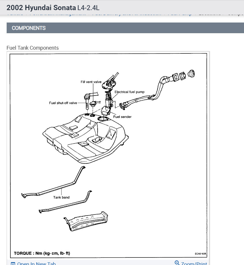

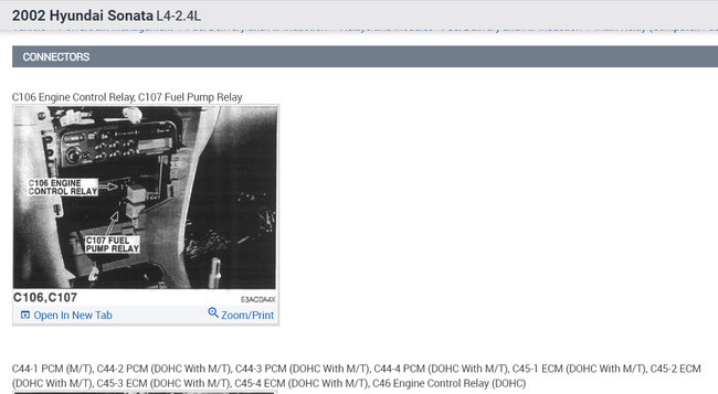

Where is the fuel pump relay located and is there a fuel pump reset switch and where is it located?
2002 HYUNDAI SONATA
168,051 MILES • 2.4L • 4 CYL • 2WD • AUTOMATIC
QUEEN4221
Ran out of gas and put gas in tank car won't start not getting fuel.
Jun 2, 2023 at 10:16 PM
  • 55,433 POSTS

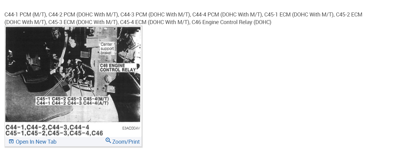

The fuel pump does not have a reset switch like a Ford does. Here is the location of the fuel pump relay, which is the engine control relay under the dash, but I have seen when you run out of gas the fuel pump goes out FYI. Here is how to change out the fuel pump in case you need it:
