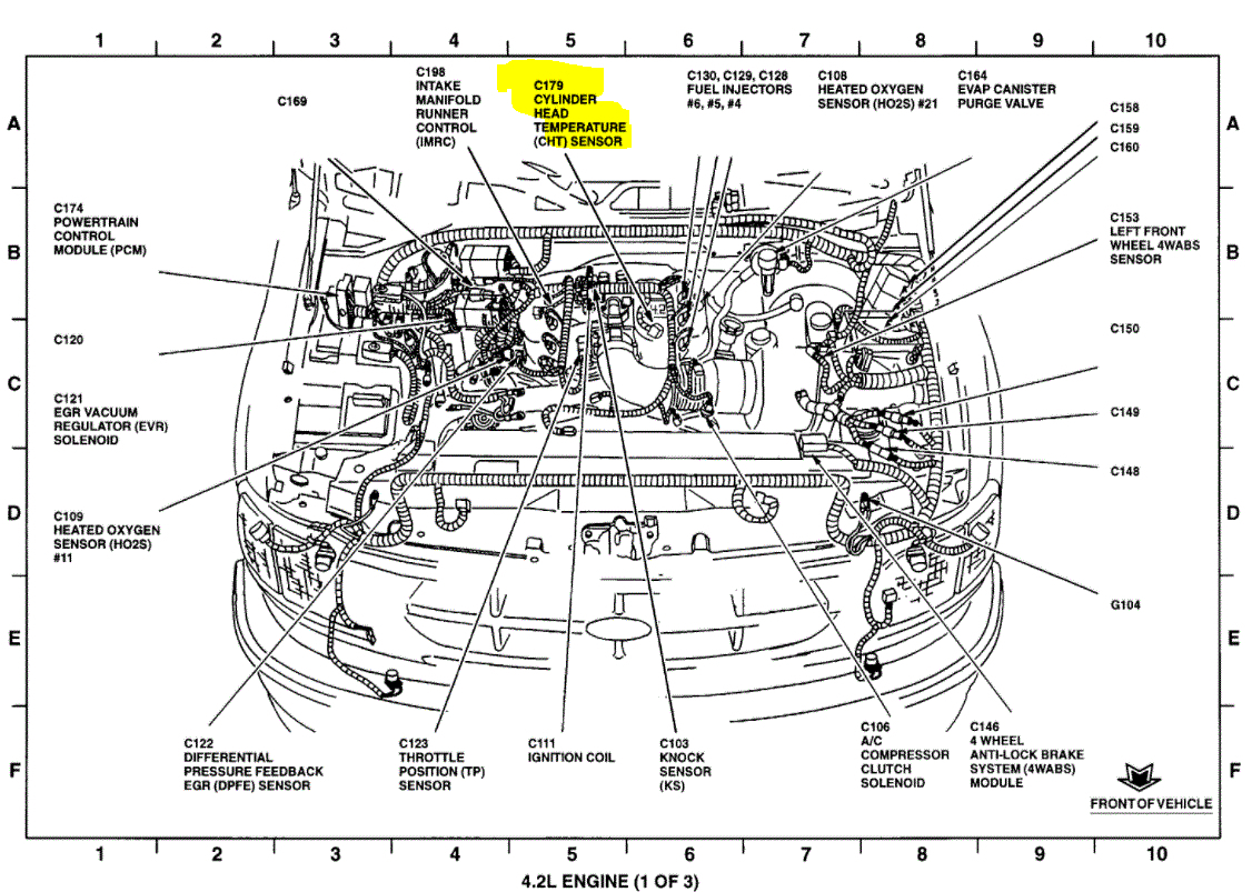

Where is the ECT sensor located?
2000 FORD F-150
185,000 MILES • 4.2L • V6 • 2WD • MANUAL
JONATHANF

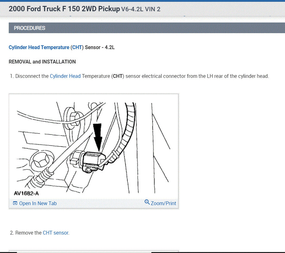

As of about 2 weeks ago i have noticed that my engine wanted to run warmer, I live in Florida, so it is always hot and year-round. I replaced my radiator, hoses, fan clutch, thermostat and housing as of 2 days ago and it still gets warm when running anywhere above 45 MPH the given temperature it stays at is about 237 when doing 50 in 4th gear. The thermostat I've put in was a 192 degree when it had a 175-degree thermostat in it. The engine's coolant temperature at idle is roughly 220-226. 42l, v6 Essex-engine.

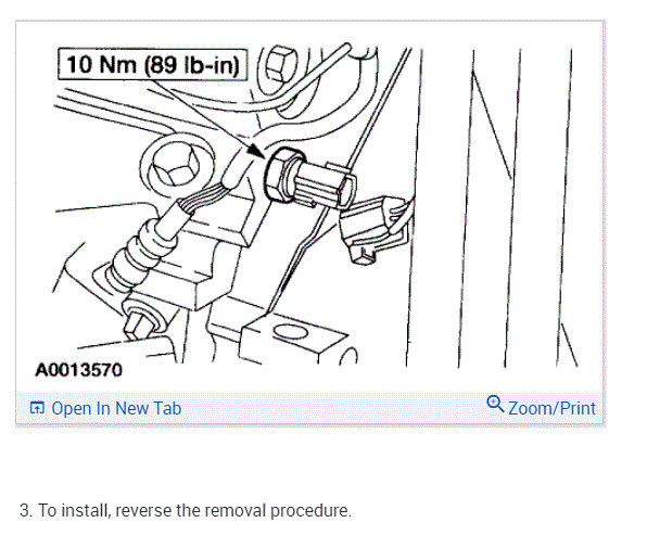

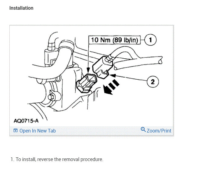

The engine coolant temperature sensor is near the thermostat housing. See pic 1 below. Pics 2 and 3 are the removal and replacement of that sensor.

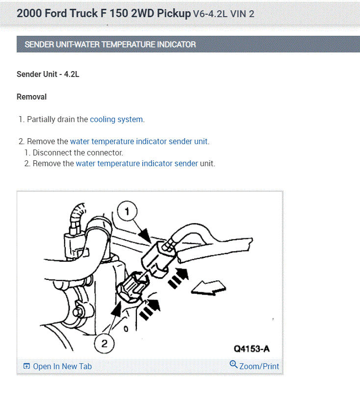

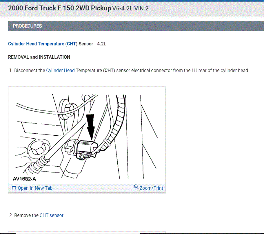

Additionally, there is a cylinder head temperature sensor at the rear of the left cylinder head. I attached directions for the removal and replacement of that as well. (Pics 4 and 5)
