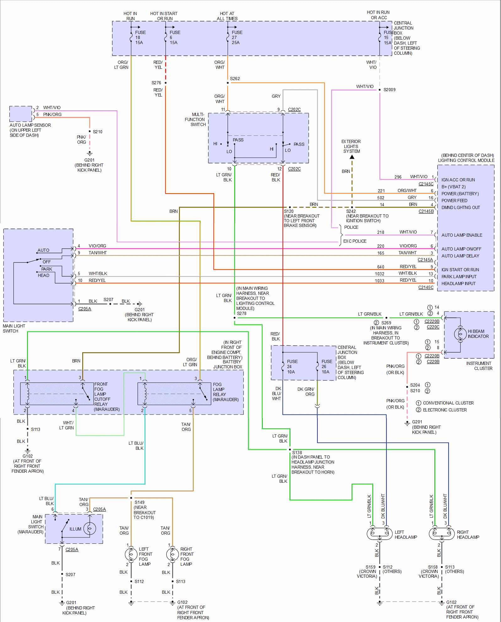

Yes the lights come on as soon as the key is in any position except off. (ON or ACC). They stay on all of the time until the Ignition is put into the off position. They stay on when the car is starting, when it is just sitting in park even with the parking brake on. The only way to turn them off is by turning off the ignition. I tried removing the two low beam fuses and then I only had the passenger side headlight on at a lower output (like a DTR light should be) all of the time. Removing the high beam/cornering light fuse made no difference. It is really confusing.
Monday, April 23rd, 2018 AT 8:27 PM
STEVE W.
  • 13,577 POSTS

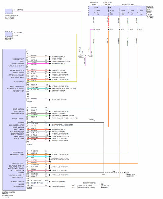

I was reading the recall on this. You had this issue before they replaced the LCM. The recall was because the LCM would fail resulting in no lights. I wonder if the previous owner had the unit fail and added a wire to turn the low beams on because the LCM was deemed too expensive or possibly the parts were not available? That would explain not having the high beams working as the LCM failure only shut off the headlights, the rest of the system still worked.
If you switch the lights on with the light switch do the high and low beams switch correctly or do the low beams still stay on when you select the high beams?
When you turn on the key it is only the low beam lights that come on correct, or can you switch low/high?
I attached a different version of the wiring diagram and the LCM circuit.
We will figure this out.

What you said in the first paragraph of your response makes a lot of sense to me. If I switch the lights on with a light switch the low beams come on but I can change them to high beams. When I turn the key on the low beams come on but I can switch them to high beams.
I cannot read the two wiring diagrams even when I put on the magnifier. I will search for any suspicious looking wires under the dash or the hood tomorrow that could have been added. Thank you very much.

I figured out a way to make the diagrams readable. It might help me find any added wires.
