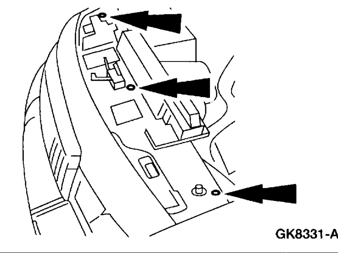

Where exactly is the DRL (Daytime Running Lights) Module on the car listed above? Also, can it be disabled?
Apr 11, 2018 at 7:49 AM
Good evening.

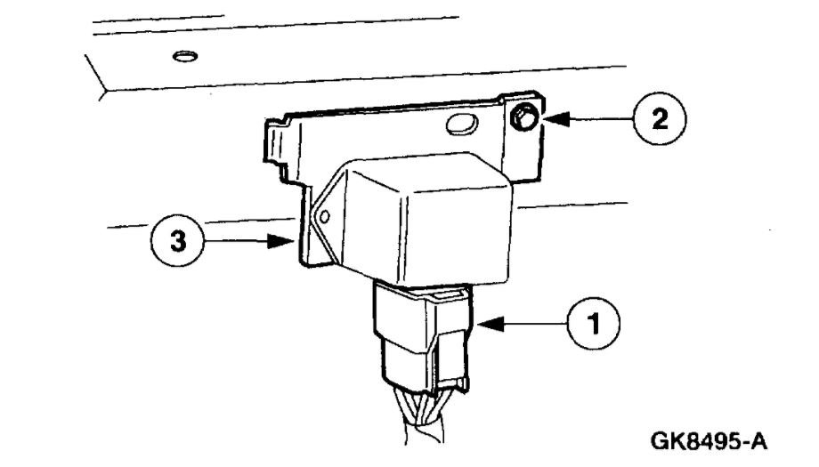

The location is under the hood under the plastic cover for the headlight. procedure below and picture attached.
Why do you want to disable it?
REMOVAL:
1. Remove the battery ground cable.
imageZoom/Print

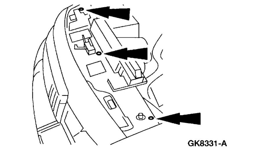

2. Remove the sight shield.
^ Twist the clips.
imageZoom/Print
3. Remove the Daytime Running Lamps (DRL) module.
1 Disconnect the electrical connector.
2 Remove the bolt.
3 Remove the DRL module.

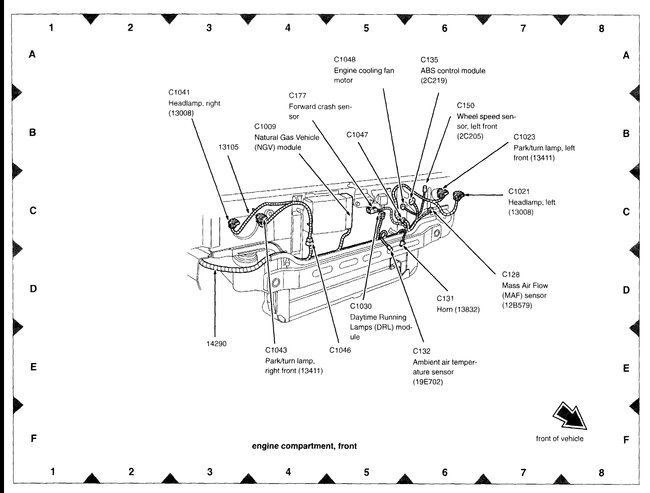

center of the grille area on the radiator support.
You are welcome.
Apr 11, 2018 at 9:52 AM
REX STERLING
  • 21 POSTS
I removed the sight shield but still could not find it.
Apr 11, 2018 at 10:05 AM
remove the whole shield along the front.

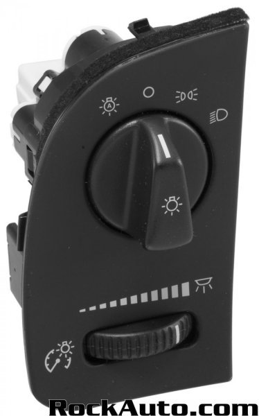

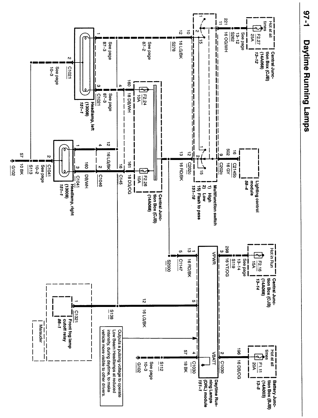

It sounds like your car has the automatic lamps option not DRL's. The DRL system uses a pulsing voltage to turn the lights on at a lower power setting than the normal lights. As you say there is no change it looks like you have the auto option.
That switch should have four positions, Fully counterclockwise - Auto, one click clockwise = off, second click = parking lamps and finally headlamps at the full clockwise position.

Yes, that is the switch that I have. The head and tail lights both come on after dark when the switch is on auto, as they should. But my headlights stay on all of the time even when it is light out and the switch is on the off position (but the tail lights do not come on then). That is why I think it is a DRL problem. If I have to I will interrupt the low beam fuses with a toggle switch because I do not want my lights on all of the time. I am hoping that there is an easier way. Any ideas? Thanks for all of your time and effort.

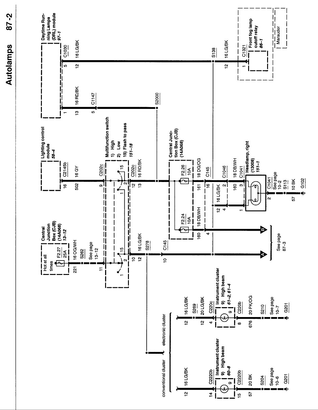

This is supposed to be the wiring for that car with auto headlamps. It does show a DRL module but not like the Crown Victoria has.
I wonder if the issue is not a bad lighting control module itself. It basically uses voltage signals from the switch to turn on the lights. It would be easy for a component to fail and stay on, especially a safety item like lights.
A dealer level scan tool can talk to the LCM and can test its functions as well as check it for error codes, it can generate a lot of them to do with lighting and other items as well. It would not be the first odd GEM failure mode.
It is also possible it is a wiring problem, The DRL module could have broken free and be stuck in the rad support with shorted wires. Or the wiring from the light switch to the LCM could be triggering it to stay on.
Just a couple items to consider.
Apr 14, 2018 at 10:40 AM

It is part of the LCM. The non automatic headlights use a different switch and control circuitry, shown in the picture. Did they find something wrong with the LCM or?

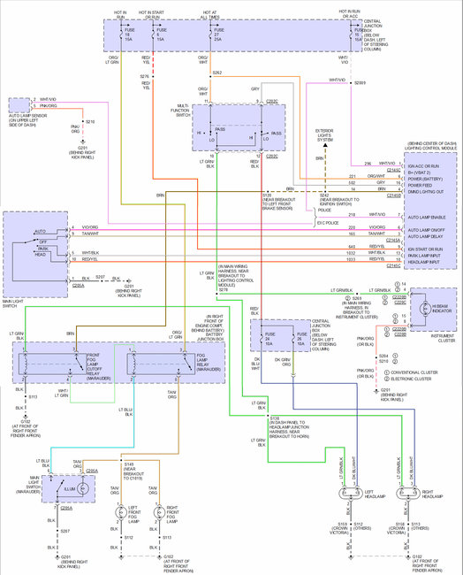

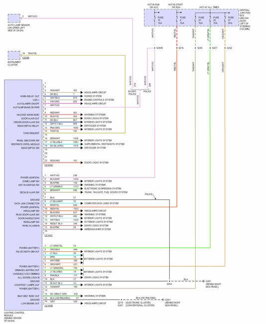

I was reading the recall on this. You had this issue before they replaced the LCM. The recall was because the LCM would fail resulting in no lights. I wonder if the previous owner had the unit fail and added a wire to turn the low beams on because the LCM was deemed too expensive or possibly the parts were not available? That would explain not having the high beams working as the LCM failure only shut off the headlights, the rest of the system still worked.
If you switch the lights on with the light switch do the high and low beams switch correctly or do the low beams still stay on when you select the high beams?
When you turn on the key it is only the low beam lights that come on correct, or can you switch low/high?

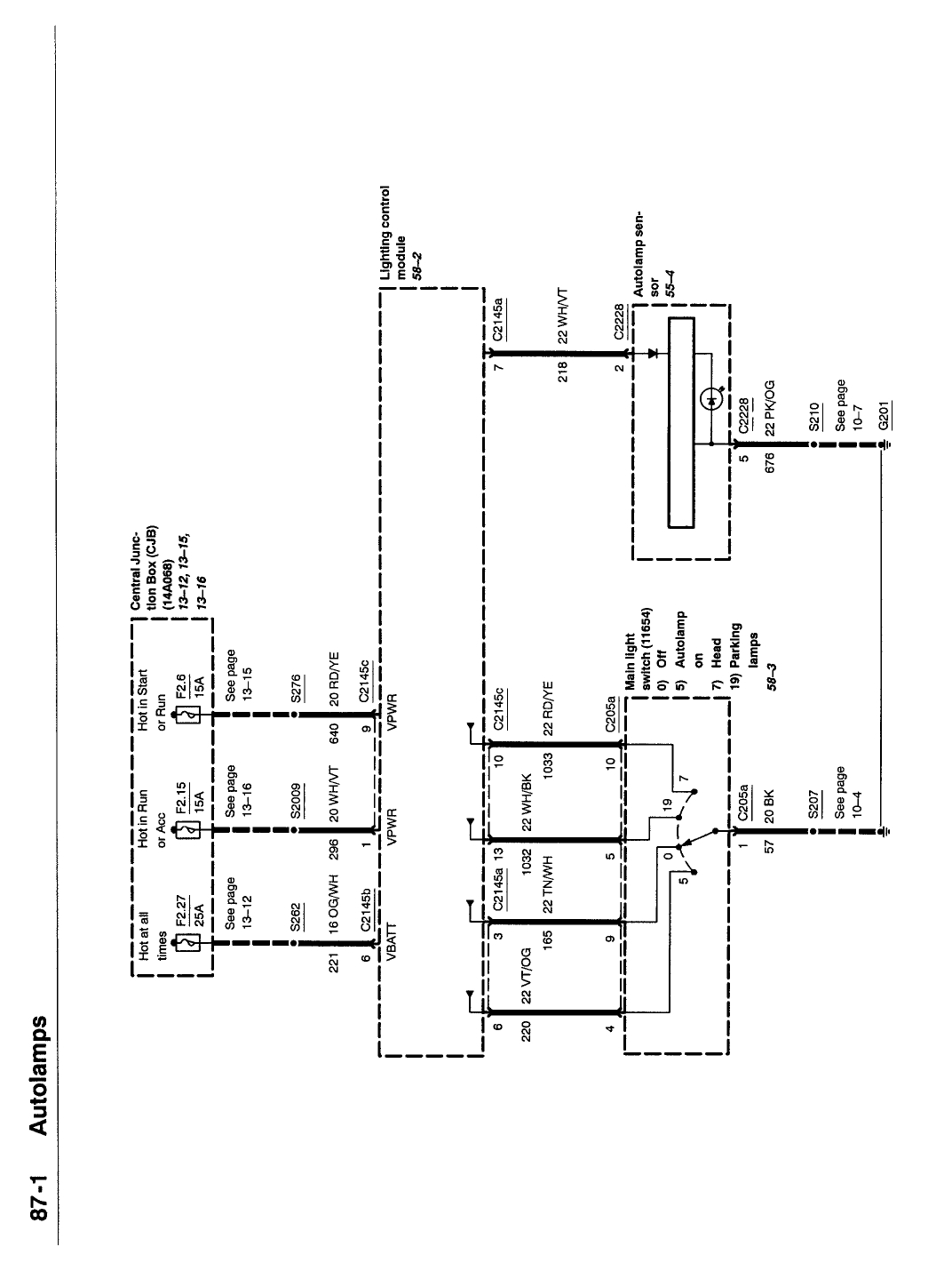

I attached a different version of the wiring diagram and the LCM circuit.
We will figure this out.
Apr 24, 2018 at 5:57 AM
REX STERLING
  • 21 POSTS
What you said in the first paragraph of your response makes a lot of sense to me. If I switch the lights on with a light switch the low beams come on but I can change them to high beams. When I turn the key on the low beams come on but I can switch them to high beams.
I cannot read the two wiring diagrams even when I put on the magnifier. I will search for any suspicious looking wires under the dash or the hood tomorrow that could have been added. Thank you very much.

I figured out a way to make the diagrams readable. It might help me find any added wires.
Apr 24, 2018 at 12:51 PM
STEVE W.
  • 15,322 POSTS
I have seen things like that on different vehicles, some item fails and gets "repaired" in a way that drives the next guy crazy. The police option on that car eliminates the light sensor and turns on all of the lights as soon as the key goes to accessory or on.
On the diagram, if you right click it and select to open it in a different window it should come up with a zoom button to make it larger.
Apr 25, 2018 at 4:34 AM
REX STERLING
  • 21 POSTS
Thank you Steve. My lights work fine now. I found the extra wire that the previous owner had run to the headlights and disconnected it (and protected the end of the jumper from shorting out). Your advice saved me a lot of misery and possibly expense. Once I found the wire, I felt silly that I had not seen it before. This problem was driving me nuts. Thanks again for all of your time and effort on this and for not just giving up. You are the best.
