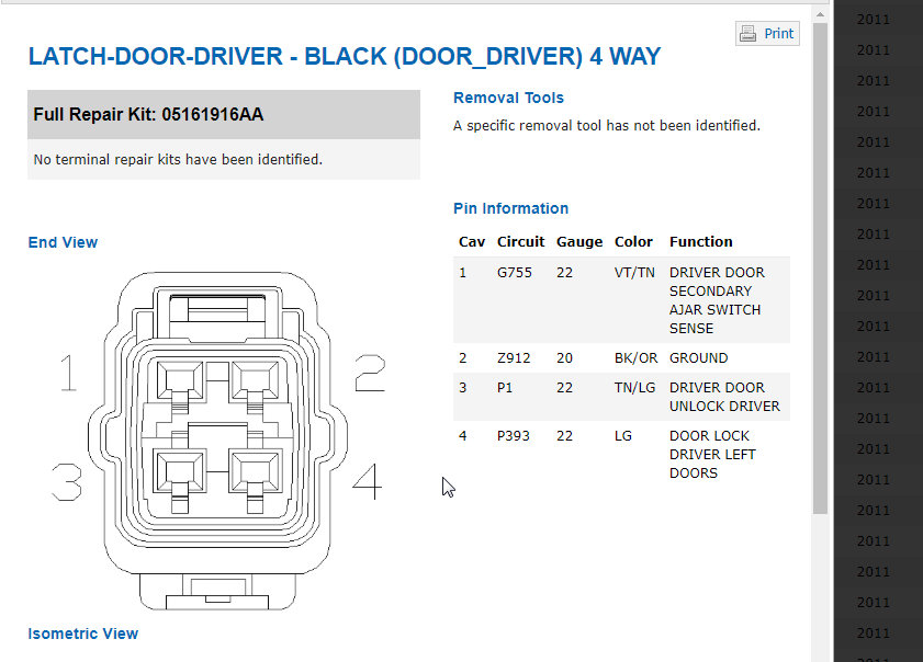

No. If the harness is damaged, you only need to fix the harness.
If it is just the connector then you don't need to do the entire harness. This website sells most all the connectors with wiring pigtails so all you need to do is cut off the damaged connector and splice on the new one.
http://connectors.dcctools.com/results.htm

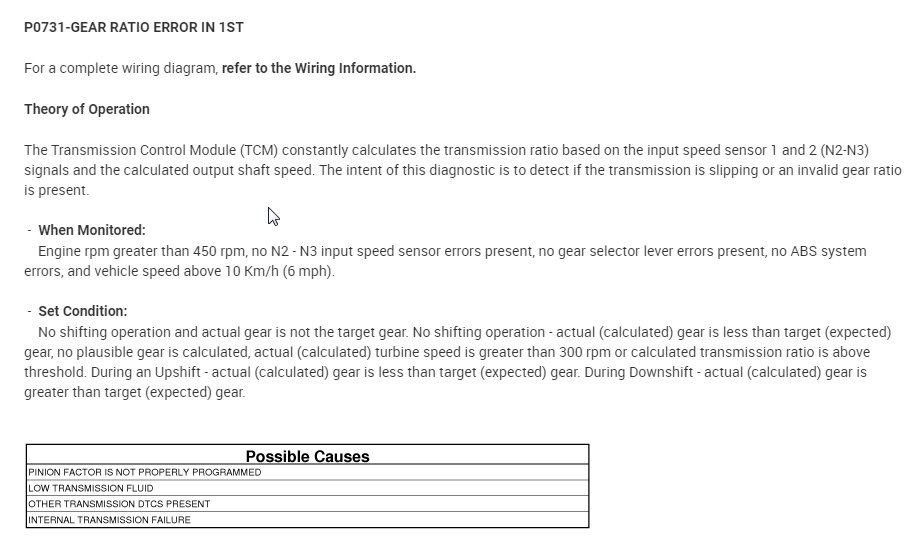

Transmission stopped engaging all gears including park upon a hard acceleration at a stop light.heard whining sound and felt like somerhing was spinning when tried to put in drive or reverse. Pulled code with diagnostic reader: P0731 . Saw online a TSB for "loss of power"- mode, but the mil never illumiated. How do i fix this?
Dec 15, 2019 at 8:54 AM
We need to start a new post with this info. We need to keep it to one topic to each post so that others can find the solutions for each issue. They won't find a transmission issue under an RKE post.
I attached the first part of this code. Either the fluid is low, there are other codes, or you have an internal transmission issue. Based on your other symptoms I suspect you have a transmission failure.

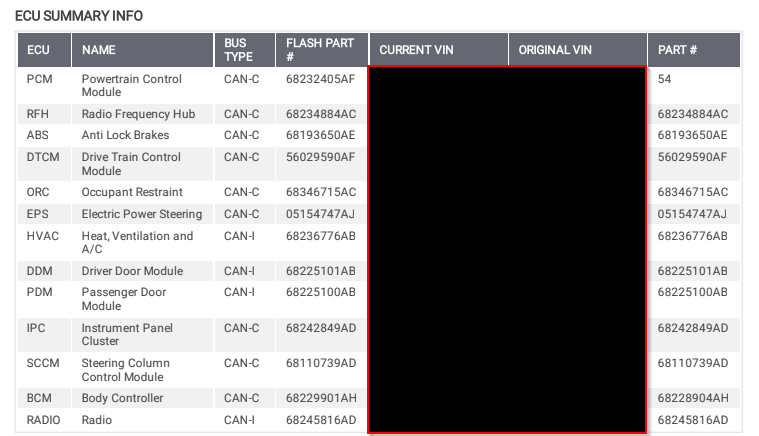

Why would the flash part number for the PCM in a scan report be different than the part number?
Dec 28, 2019 at 3:37 AM
The part number for the actual part is just a catalog number that Mopar assigns to it. The flash part number is the software number that goes into the PCM from the scan tool. So technically speaking the flash part number is not an actual "part" number. It would be better called a software number.
Just like you can have different iPhone 10's with different ios numbers.
So you could check different Challengers and they will all have the same part number of the PCM but could have different software numbers depending on if they had all the updates completed. If a vehicle never had an update completed then it will have the same software number it was built with. If it gets updates the number will change.
The only exception to this is if they made an improvement to the PCM itself and then they will change the PCM part number to distinguish the difference. So it is possible to have cars with different PCM part numbers but only if the actual component is replaced with a later version.

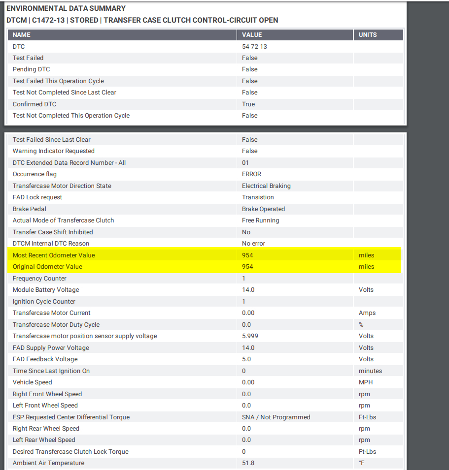

The 'flash part number' for PCM is an "old" flash part number according to chrysler scan tool availability. The same PCM shows its actual 'part number' as "54" . 54 doesnt come up for any part number for any PCM anywhere. Is this normal?
Dec 30, 2019 at 8:26 AM
Are you looking at Witech? If so, this tool simply looks at the module software number and compares it to the current version on the server at Chrysler. If there is a later version it shows an update available.
If you are looking at the part number for the PCM on Witech and all it shows is 54 then this does not sound normal. This part number should be the OEM part number for the PCM.

What would be the circumstance that would show the part number for PCM in multiple scan reports as 54?
Feb 4, 2020 at 6:06 PM
This is just a scan tool compatibility issue. Basically it is just not getting a response on the part number that it recognizes so it displays it as a "54." I see it all the time. I attached a scan report from a vehicle I was working with a dealer on today and it has the same thing. Nothing to worry about.
