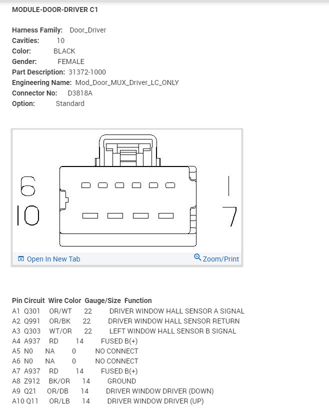

Will original RKE fob still work after installing different door module?
Nov 24, 2019 at 1:16 AM

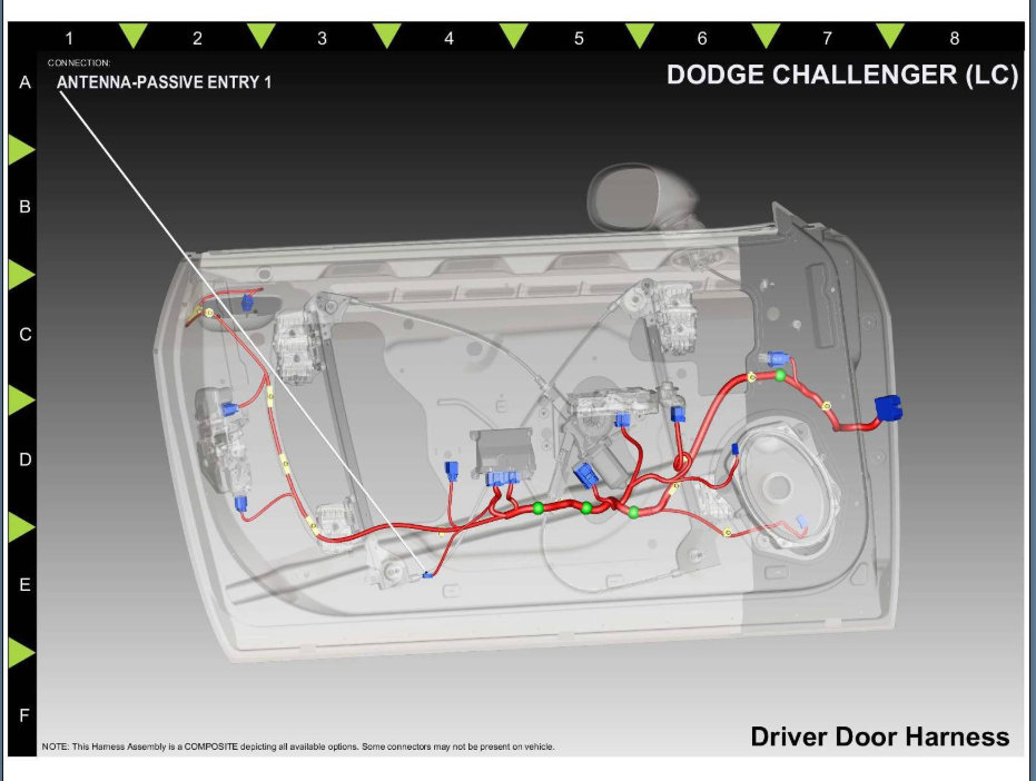

The driver door module only effects window operation not RKE operation. This system has an antenna in the door that communicates with the WIN directly.
I believe you can switch door modules because they are told what the VIN is and do not require programming. However, just make sure it is the same part number as yours or it could be equipped differently and your window operation may not work right.
Nov 24, 2019 at 3:55 PM

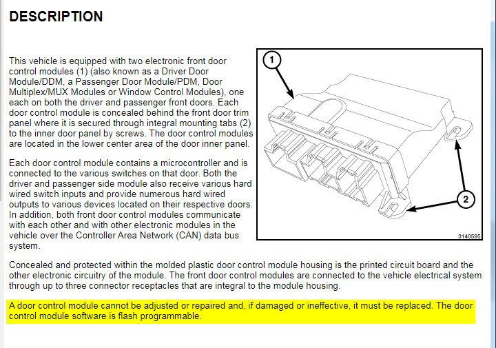

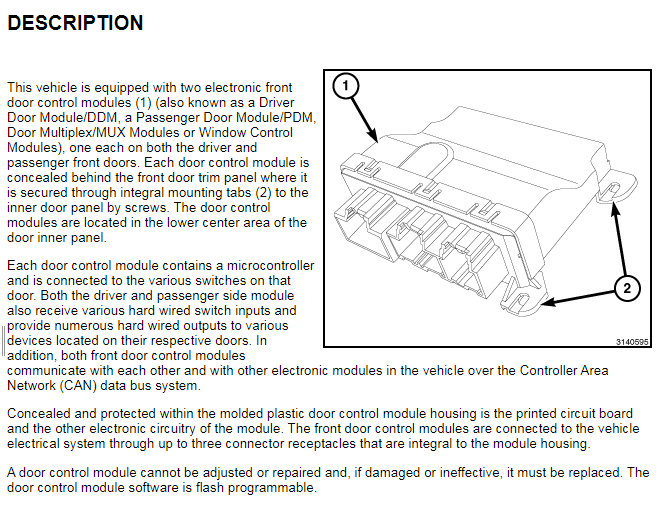

So the replacement driver door module does not need to be initialized/programmed to system/ECU If same part number?
Nov 25, 2019 at 3:10 PM
SHAMAN444
  • 55 POSTS
Could installing a different door with different internal parts(ie: DDM) to car create a dtc of "RKE fob giving off scrambled messages" and showing its original mileage as the mileage of the car the different door came from?
Nov 25, 2019 at 3:14 PM

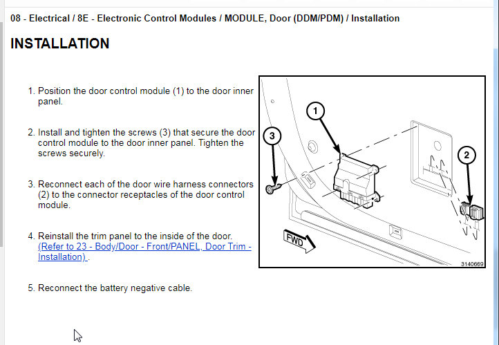

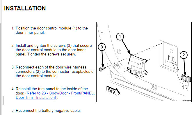

No. The DDM does not need to be programmed. If you install a door with all the components on it, it should be fine. The antenna is plug and play and the DDM does not require any programming. I have to stress if they are different part numbers from your stock ones then it will have performance issues. Otherwise you should be good.
Nov 25, 2019 at 6:28 PM

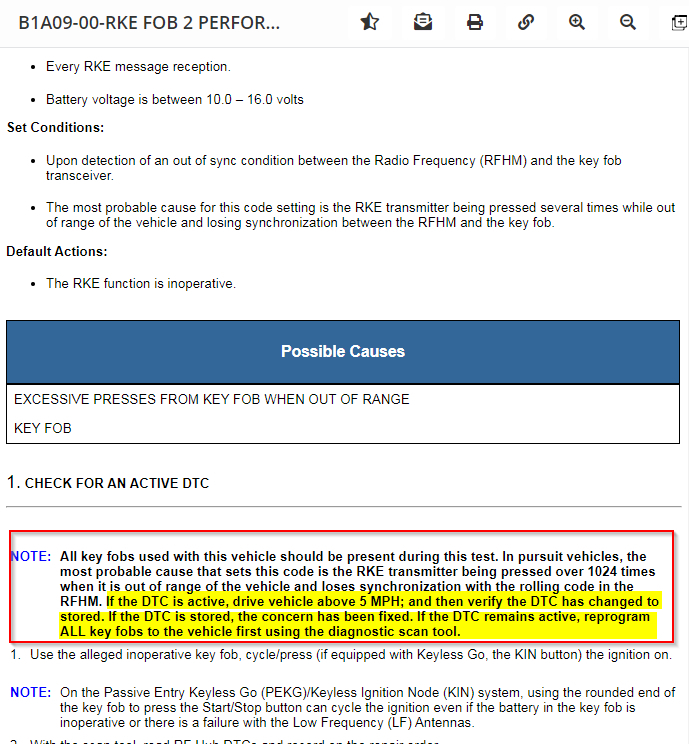

So why would RKE Fob give off a Dtc code of "B1A09-fob 2 performance" with original miles and current miles - same as car used door came from?
Nov 26, 2019 at 9:47 AM

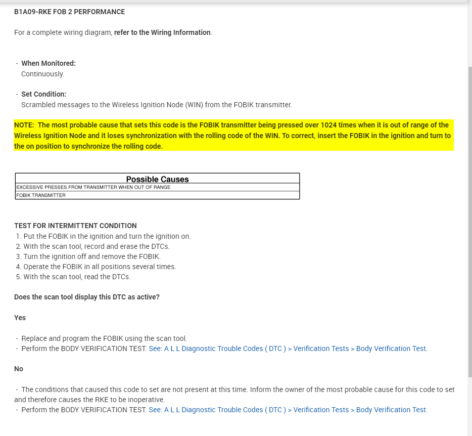

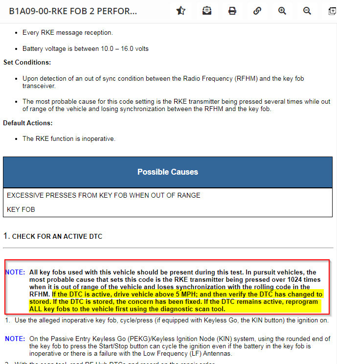

Again, this has nothing to do with the DDM. Here is the testing for this code. I suspect you have an issue with this FOBIK. Basically this is just saying that the FOBIK is out of sync with the rolling code of the WIN.

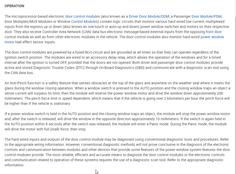

Are you able to clear the active DTC by driving the vehicle with this key?
If so, then there is nothing to worry about. As for programming a 2011 vs a 2013, this is no different. I am not sure where you are getting your info but I am not sure it is accurate. If you look at the info provided, the door modules are NOT programmed once they are flashed. So that means you install the door module in the vehicle and then you flash it with the software for that specific vehicle which tells the module how it is equipped. Once this is done, it does not have to be flashed again. However, if you install this in a vehicle that is not equipped the same then it may not function properly. However, as long as they are the same part number this will not be an issue because all the DDM is control the window operation.

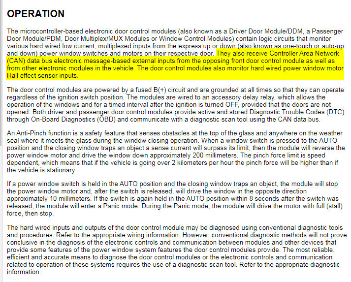

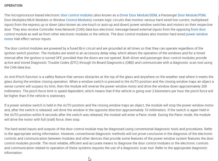

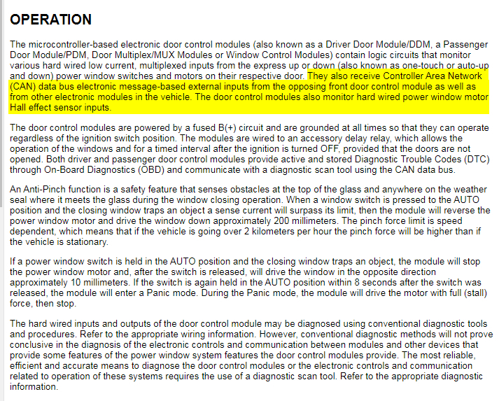

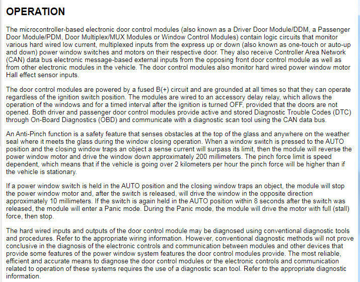

As you can see in the service info, the DDM gets additional information provided to it by other modules via the CAN bus. This is where it is getting the mileage info.
I can't imagine any of this is causing an issue so again, are the windows operating since you put this module in and have you gotten the code stored? Please read the code info. This code doesn't not have anything to do with the DDM. It says that if the code remains active replace the key.

Also- if the DDM gets it's mileage info via the can bus from other modules, how come in the scan report it says that the original mileage is actually 4 miles less then the mileage on odometer of car when the donor DDM was installed? The other modules show correct mileage at same time as this.

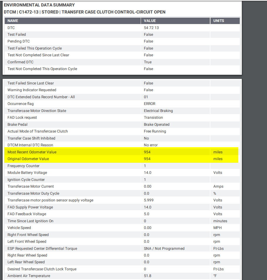

If you look at the attachment, this is a vehicle that had a code with the mileage recorded. The original odometer value is the first time this code was set. The Most recent odometer value is the last time the code was set. The purpose of these mileages is so the one diagnosing the vehicle can determine about how many miles it may take to replicate the issue.
If your DDM module is showing the mileage from the last vehicle, that is because whatever code you are reviewing was set in that vehicle. The only time the environmental data is recorded is when there is a code set.
I wanted to see the scan report so I can be sure this is what you are talking about. If it is then the mileage was recorded the first time the code was set and then the '"Most Recent" mileage is set each time the code is reset. If the code is only set one time then this mileage will be the same as it is in the example attached. If the code is Active, then goes stored, then goes active again, it will keep the original mileage from the first time it set, then record most recent mileage at the next time it set.

Okay. I figured that last night when I woke up thinking about this one. So that means we are getting closer. Now can you tell me what the mileage was for each line of original mileage and most recent mileage. Then tell me what the mileage was on the donor vehicle and the current mileage on your vehicle? With that information I think we can make sense of all this.
Just to recap, I need 4 things:
1. Original mileage from the WCM of the RKE code from the scan report.
2. Most recent mileage from the report.
3. Donor vehicle mileage.
4. Current mileage of your vehicle.
Dec 8, 2019 at 7:21 PM
SHAMAN444
  • 55 POSTS
Original mileage of WCM : 93650.
Current mileage of WCM: 93650.
Donor vehicle mileage: 93650.
Current mileage of my vehicle: 112789.
Dec 9, 2019 at 9:25 AM
Okay. So you are sure that the DDM was the only module used from this other vehicle? The reason I ask is the DDM does not retain the mileage. However, this RKE code was not even set in the DDM, it would have been set in the WCM. This means the only way the WCM would know what the mileage was of the other vehicle, is if it was in the other vehicle.
So just to try and recap. You swapped the DDM from another vehicle and had a DTC in the WCM for the key performance and this was the mileage data that you found on the scan report? If this is the case, then the WCM wound not get the mileage from the DDM because the DDM has no way of knowing what the mileage is. Again it's only function is window operation and it does not need mileage for that.

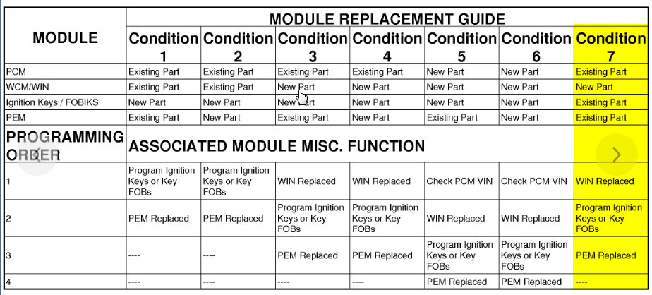

If the PCM is throwing a "no communication with radio" -DTC, does that mean the radio will not work while driving ?
Dec 10, 2019 at 4:02 PM
SHAMAN444
  • 55 POSTS

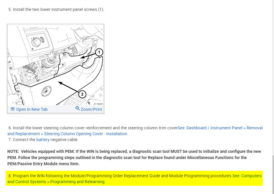

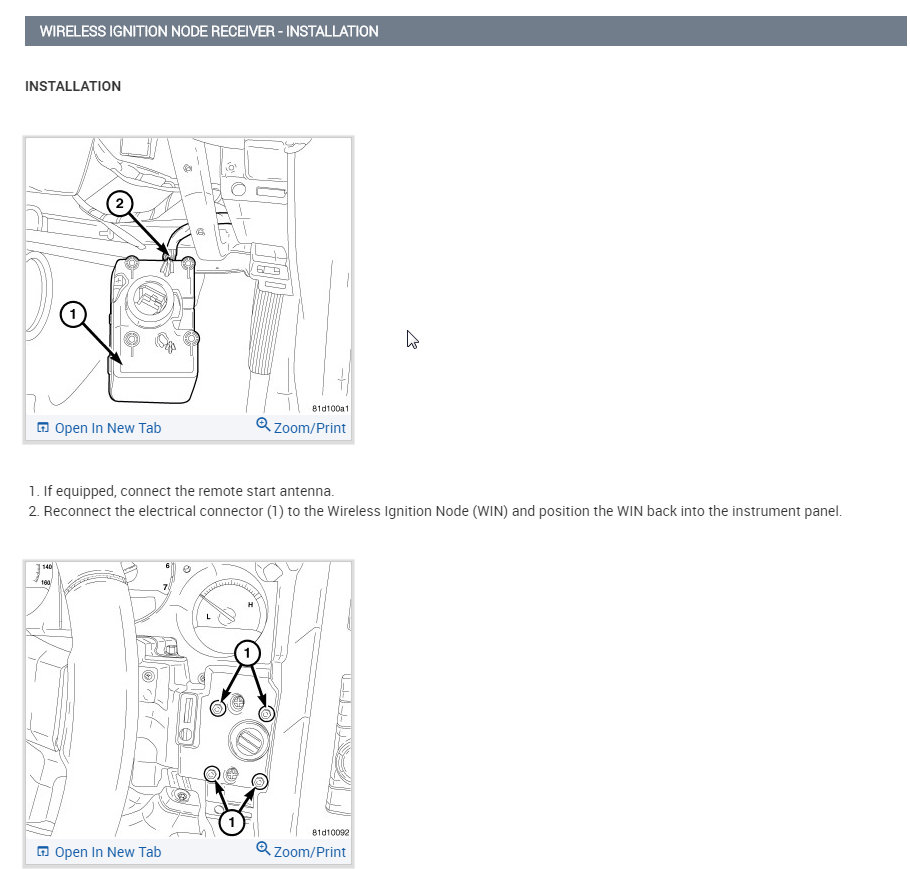

What does it require when installing a used WCM into another vehicle? Would it automatically work with car's PCM, TCM and ECU?
Dec 10, 2019 at 4:07 PM
SHAMAN444
  • 55 POSTS
Would the PEM work with anothee car's WCM?
Dec 10, 2019 at 4:12 PM
No. The PCM no communication with Radio is very common to see. Basically this means at some point the PCM was expecting to see something from the radio and it didn't get the proper "response" from the radio. I have seen these codes active and the only way you know it was checking the codes. These communication errors alone do not effect the operation of the individual component. It simply says the two modules did not communicate properly. Its like a poor cell phone connection. Both phones are still working, they just can't talk to each other.
If the WIN/WCM was used from another vehicle then yes it would need to be programmed to the PCM because the info is backed up in the PCM. This would be an easy process as it just needs the WIN replaced function and program the keys, then the PEM (passive entry) replace function (if equipped).

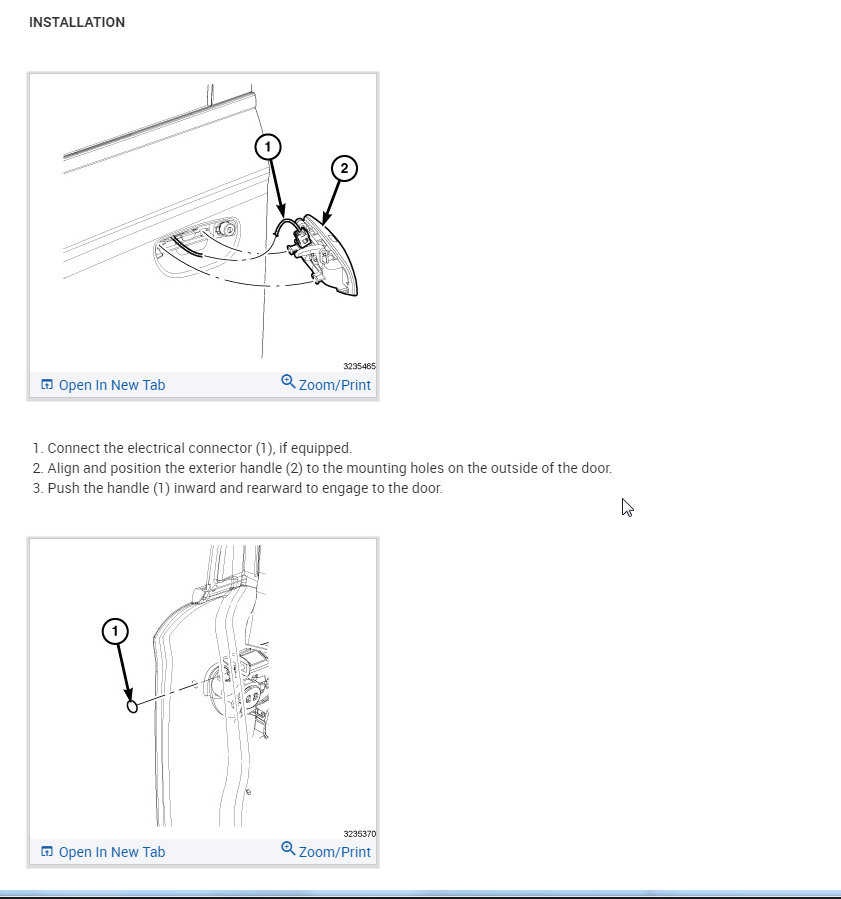

Would replacing drivers side outer door handle require replacing WCM, FOBIK and PEM?
Dec 10, 2019 at 11:08 PM
SHAMAN444
  • 55 POSTS
If the driver side door outer handle's wiring harness was damaged or broken, would that require replacing the WCM? And /or would that cause the other cars mileage to show on scan report if the wiring harness to the outer door handle was from other car ?
Dec 11, 2019 at 12:49 AM
No. The door handles are inputs only to the passive entry module and can be replaced with no programming. Basically the antenna in the door senses the programmed key is within range. The PEM tells the BCM that when your hand goes onto the handle it is ok to unlock the door. So this means the handle is only a sensor and does not require any programming.
