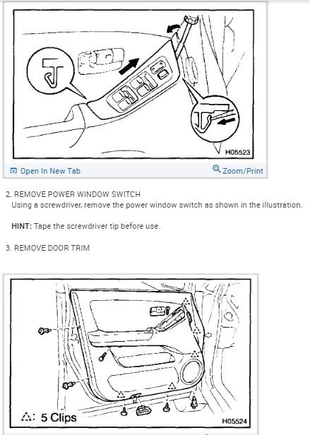

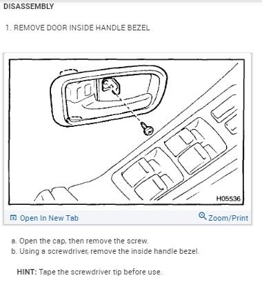

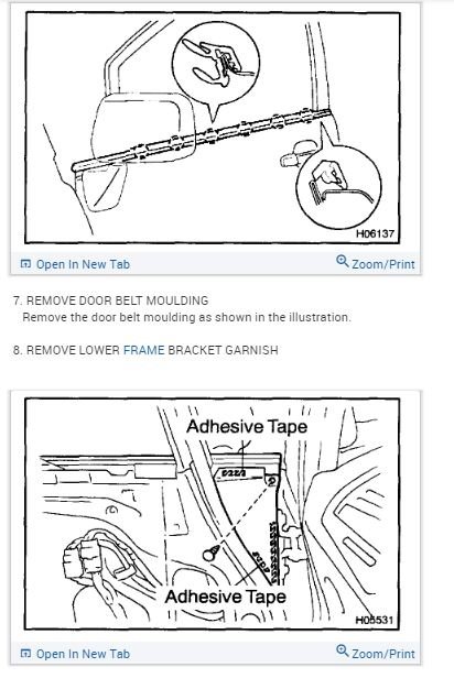

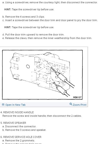

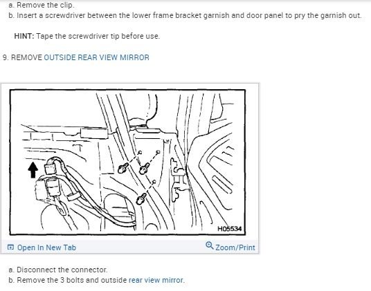

Hello and welcome to 2CarPros. A little bit of moisture getting in there really shouldn't wreak that much havoc on a latch. But if you really think that's what's happening, then here's a way to find where it's coming from. You'll start by removing the interior door panel and the insulation stuff. Make sure that the window is rolled all the way up. Shut the door (and make sure it's latched lol). Get the water hose and give it a good dousing from every direction for several minutes. Then open the door and look for wetness in there. If there's a leak, it will be evident. It would be best if you could be in the car while someone else hosed it down, but either way, it's a doable test.
But personally, I think that your latch is simply worn out. When it's cold, the moving parts are sticking a little too close together and the weakened spring can't push the arm back to where the door is latched. It won't be long before it won't latch at all. AllData does not have instructions on removing the latch, but I did find instructions on removing the panel at least. They're attached in the images below.
Check it out and report your findings. We'll go from there.
