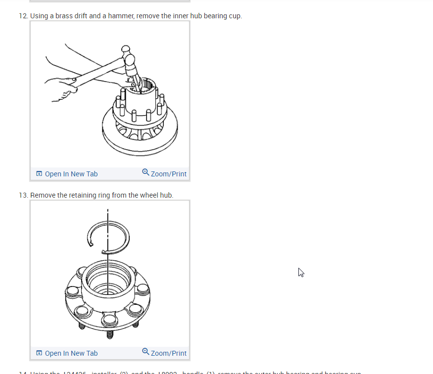

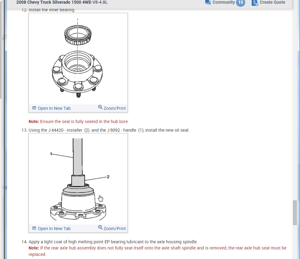

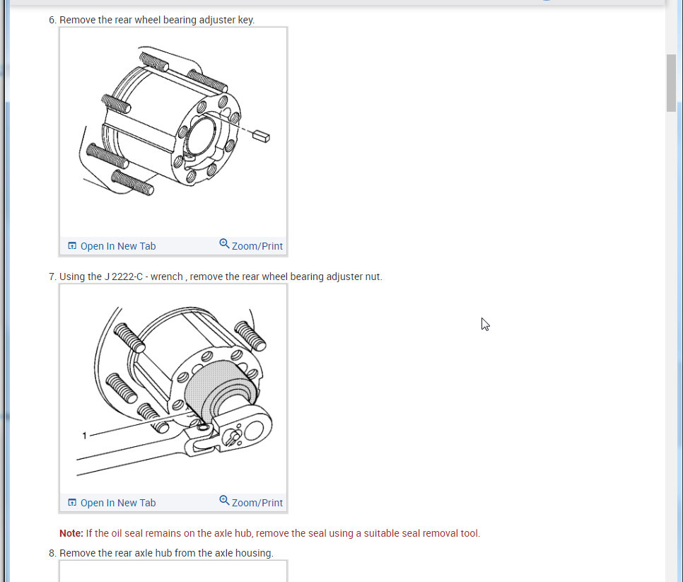

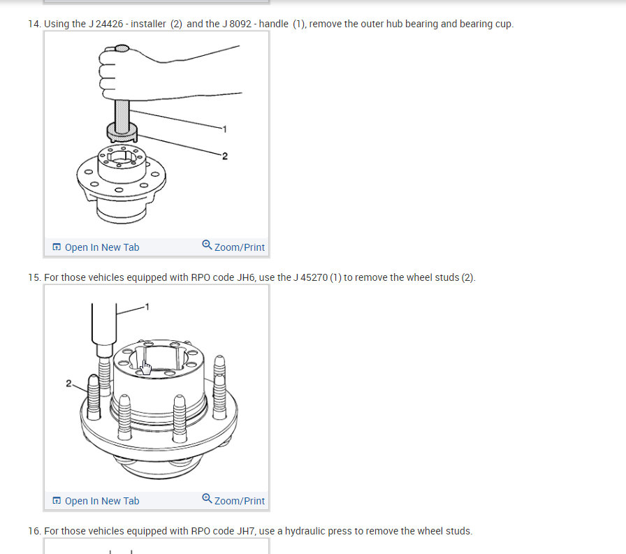

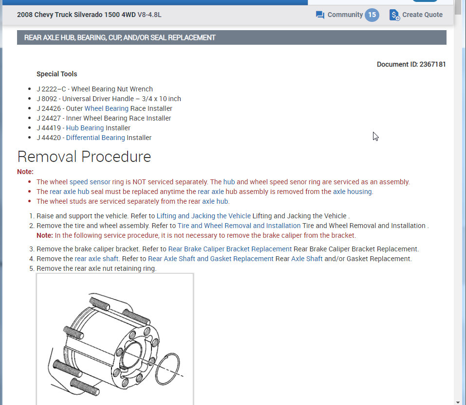

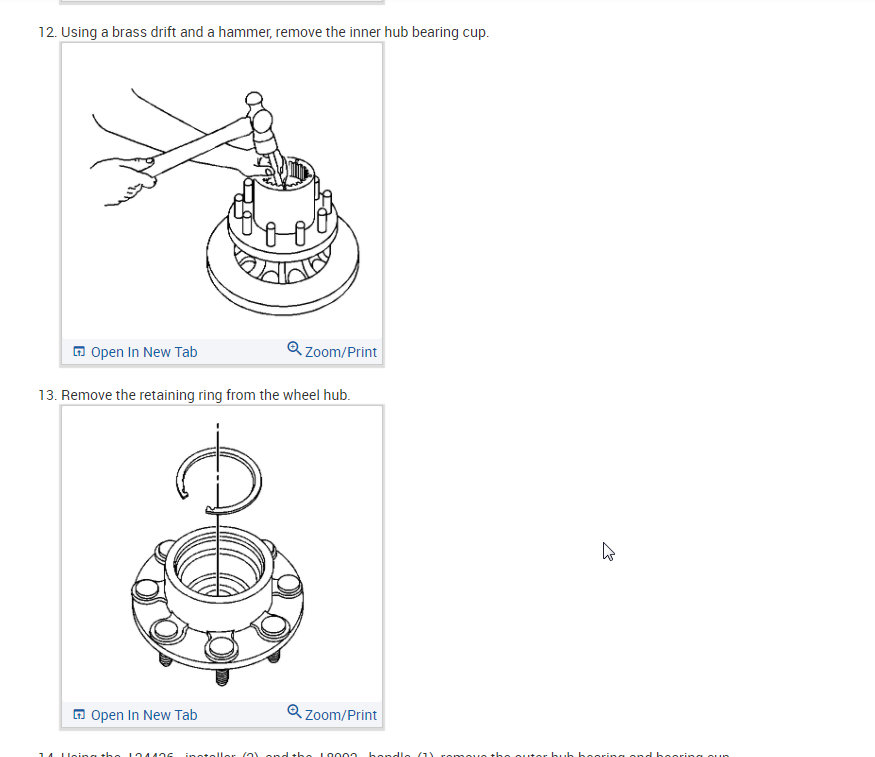

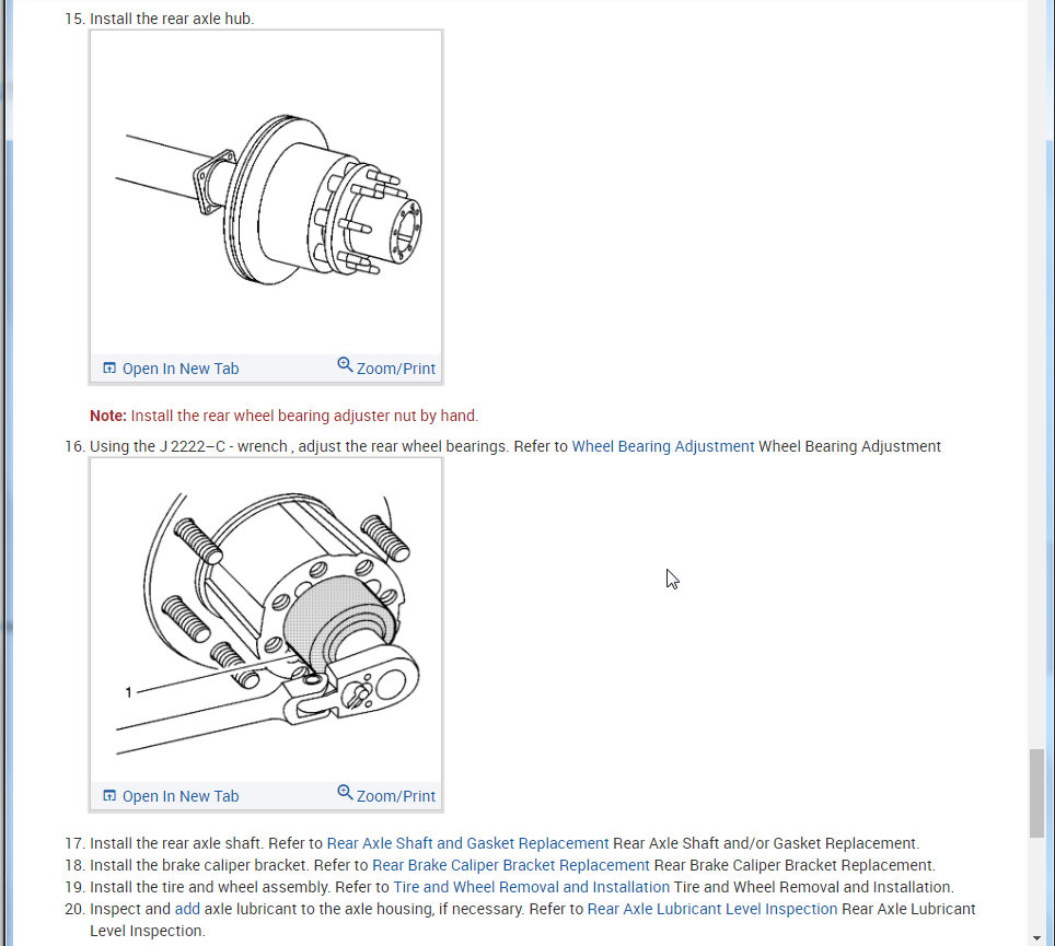

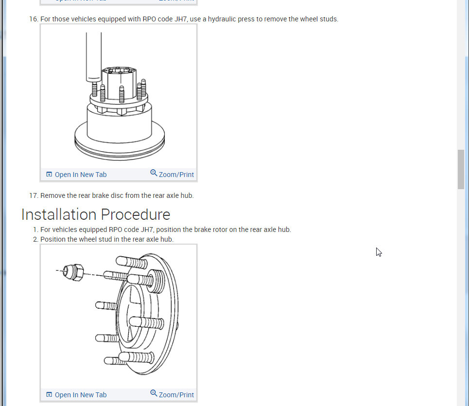

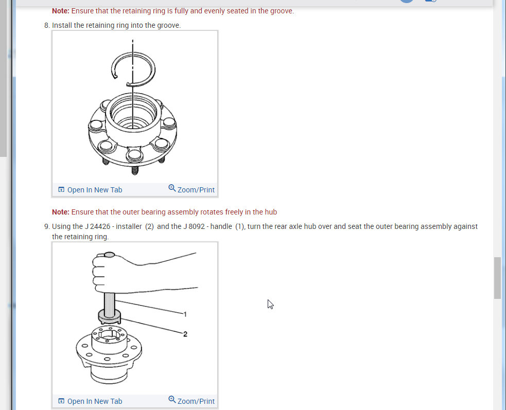

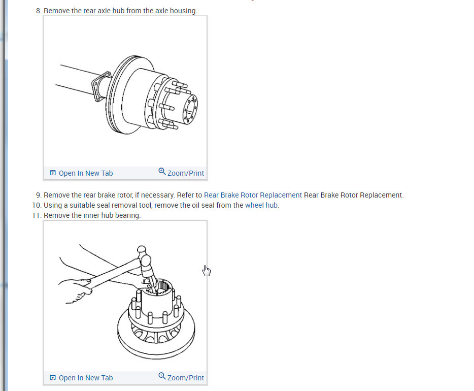

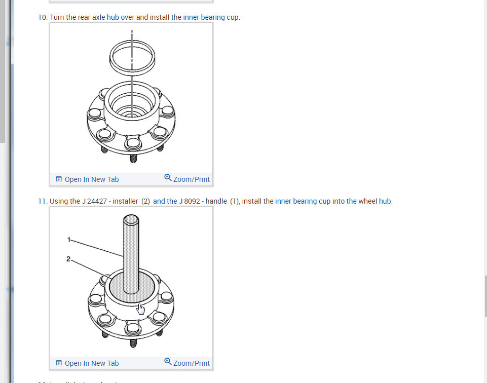

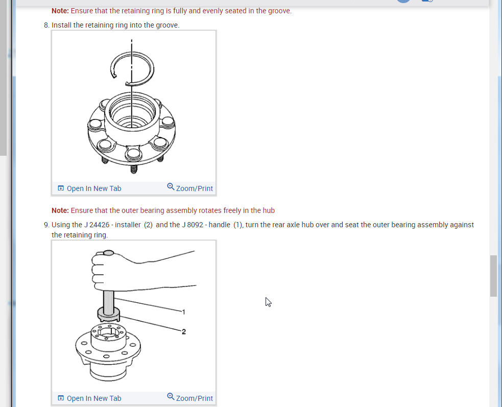

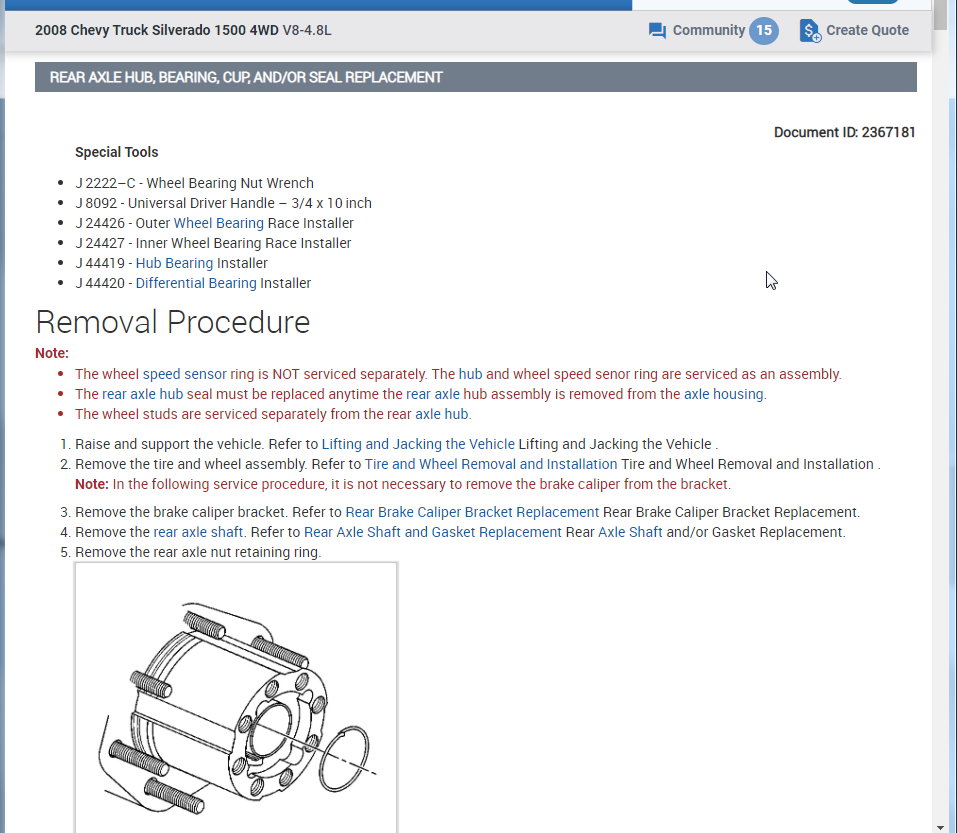

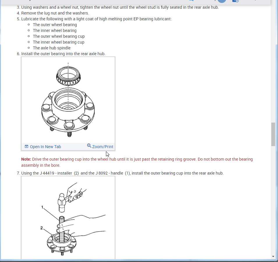

Bought the rear outer axle wheel bearing/hub assembly and my c clip will not go on. Been trying to to remove the assembly and it will not move.
Dec 14, 2020 at 1:38 AM

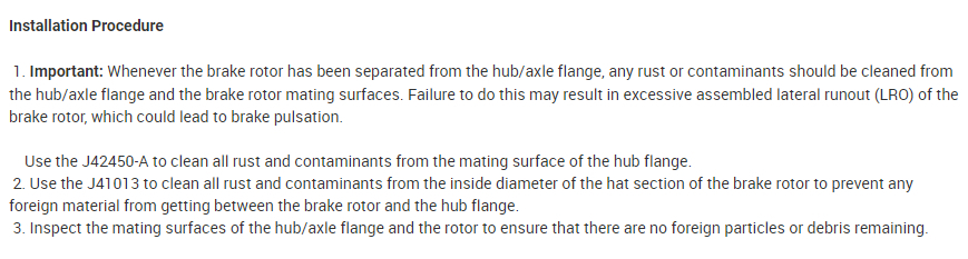

I am attaching the complete process on the rear bearing and hub assembly. Can you review this and let us know what step you are hung up on? I assume it is number 8 on the assembly and it is then I assume the bearing cup is not installed far enough.
Let us know if this is something different and if so, can you get pictures of what you are dealing with and we will figure out what we need to do? Thanks
Dec 14, 2020 at 8:28 AM

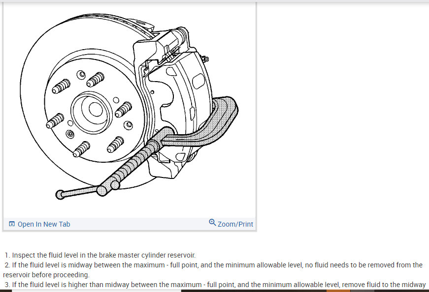

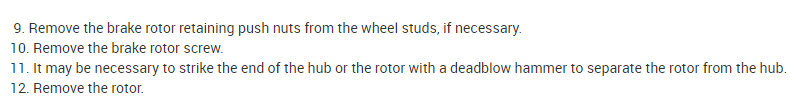

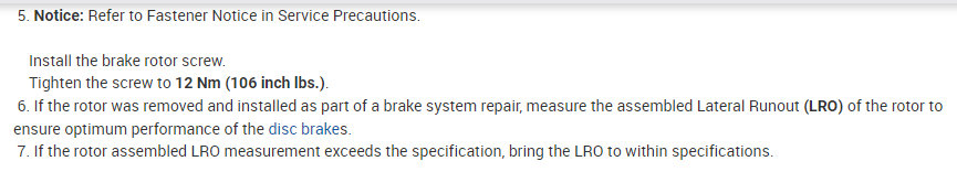

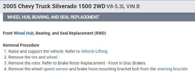

How do you replace the wheel hub assembly on my 06 chevy silverado?
Feb 7, 2021 at 1:43 AM (Merged)
DIRT-JUNKIE
[quote:6196a7acc7="djscopper"]Steering problem
2006 Chevy Silverado V8 Two Wheel Drive Automatic 50000 miles
How do you replace the wheel hub assembly on my 06 chevy silverado?[/quote:6196a7acc7]
If this is a torsion bar style suspension, meaning it doesn't have springs in the front, you take the tire off remove the brake caliper assembly, remove the large nut in the middle of the rotor, and on the back side of the rotor near your c/v axle there are six bolts remove them . Now you might have to tap the old hub out by tapping on one side then the other,it is resessed in a little. you also may have to tap on the end of the axle a little to free it up in the splines. It is fairly easy if you are mechanicly enclined, good luck.

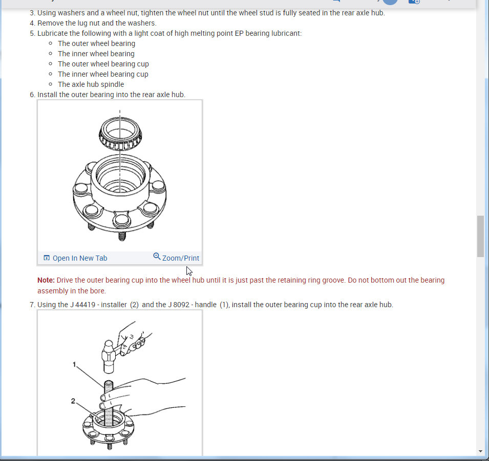

I watched your video on this subject and I am not 100% sure witch way the outer bearing race goes in cone up or down I'll try and send pictures. Pic one is up and two is down.
Feb 7, 2021 at 1:44 AM (Merged)
  • 55,433 POSTS
Hey 06 Duramax,
Thanks for watching the video, "cone up" is the way it needs to be installed, please contact us anytime with questions, thanks for using 2CarPros.com
Best, Ken

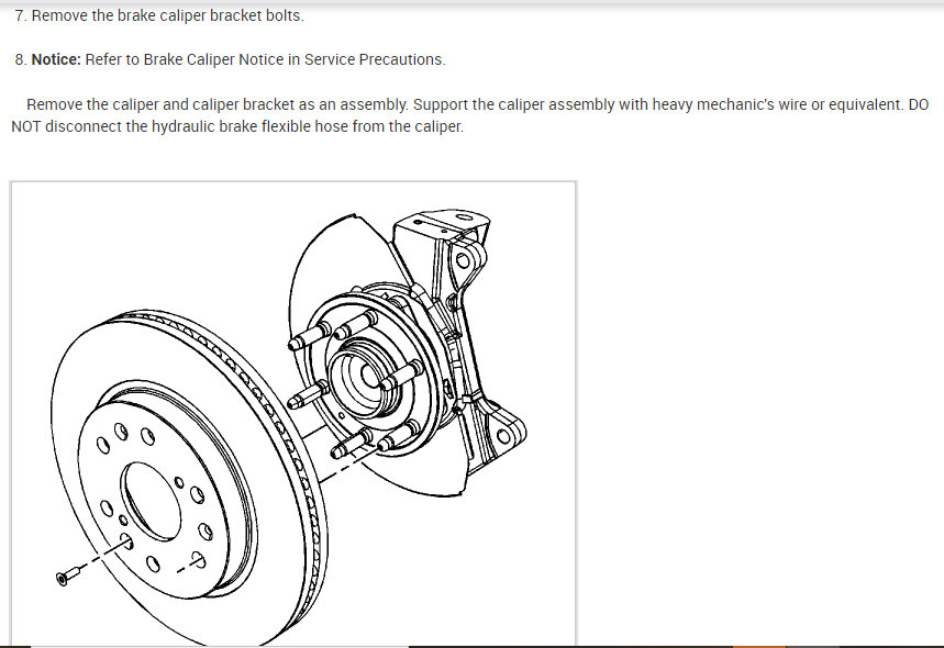

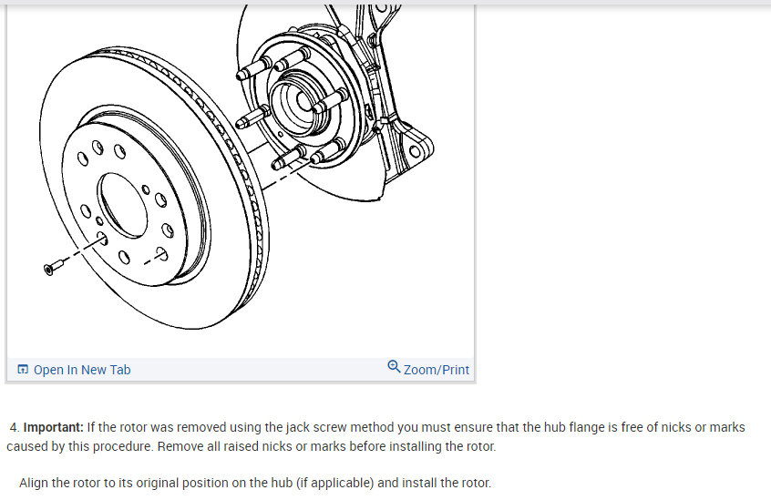

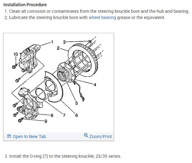

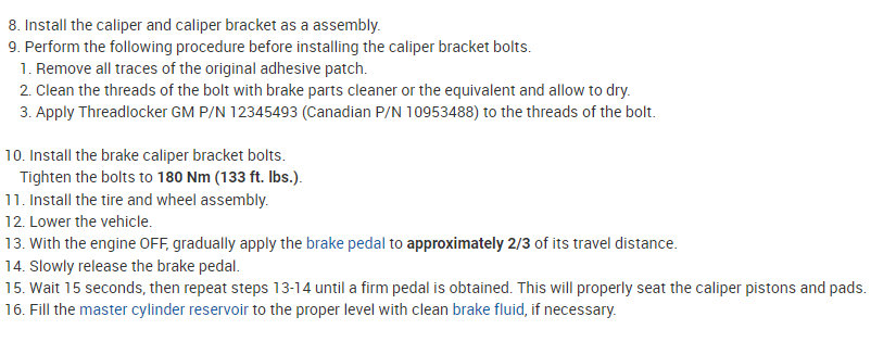

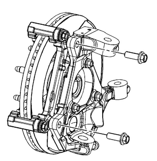

Hello, I'm Danny.

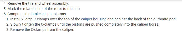

There should be no play whatsoever in the hub assembly. Here is a tutorial showing how to replace a front wheel-hub assembly:
https://www.2carpros.com/articles/bearing-hub-replacement
I've attached picture steps below showing how to remove and replace the rotors to gain access and replacing the hub assembly on your truck. Hope this helps and thanks for using 2CarPros.

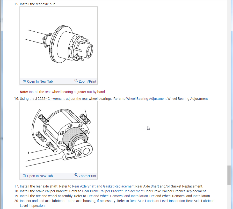

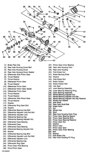

BCOHOE

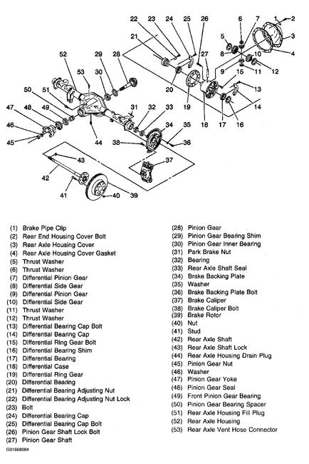

my 2002 Silverado hd left rear bearings were replaced and the outer smaller bearing got hot and come apart.my question ? The cone placement of the outer smaller cone bearing is pointing in because it can only be install in the hub from the inside. Can you also send a diagram .the axles shaft is bolted to the hub not pin in diff.Thank you and wait for your reply.
DOCFIXIT
  • 18,828 POSTS
Was Diff oil level full? oil seal replaced? DIY or did you have it done? sending pic maybe small
BCOHOE
yes. the oil was full and new seal was put in. Thank you the diagram but,its not the right one I was looking for. My truck is a 2002 Silverado 2500 hd . 6.0 liter. 10.5 diff. The rear wheel hub got two bearing.
DOCFIXIT
  • 18,828 POSTS
Without all info had to guess so here is 10.5 Suspect installation may have damaged bearing also 115 ft. lbs. torque on hub.
DOCFIXIT
  • 18,828 POSTS
oops forgot diagram
BCOHOE
when the bearing were installed into the wheel hub the outer bearing cone the taper end was pointing into the inner retaining ring, also the adjuster nut was not torqued just hand tighten until wheel started dragging than was back off and pinned. My next question is this adjustment nut should be torque to 115 pds for preload than back off?
DOCFIXIT
  • 18,828 POSTS
115 for bolts to hub the adjuster finger tighten to zero lash then with socket and torque wrench tighten to 52 lb. ft. you can back off one slot counterclockwise to insert keeper key

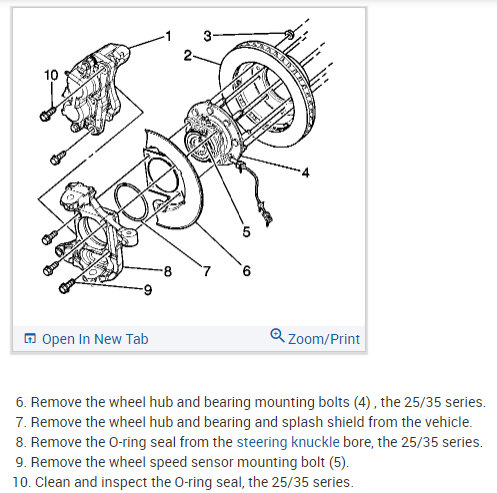

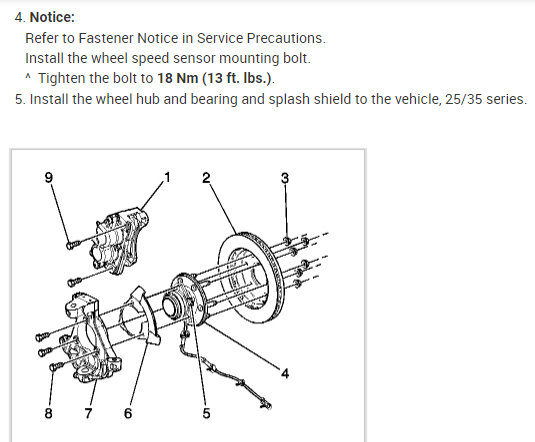

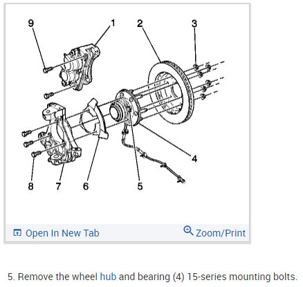

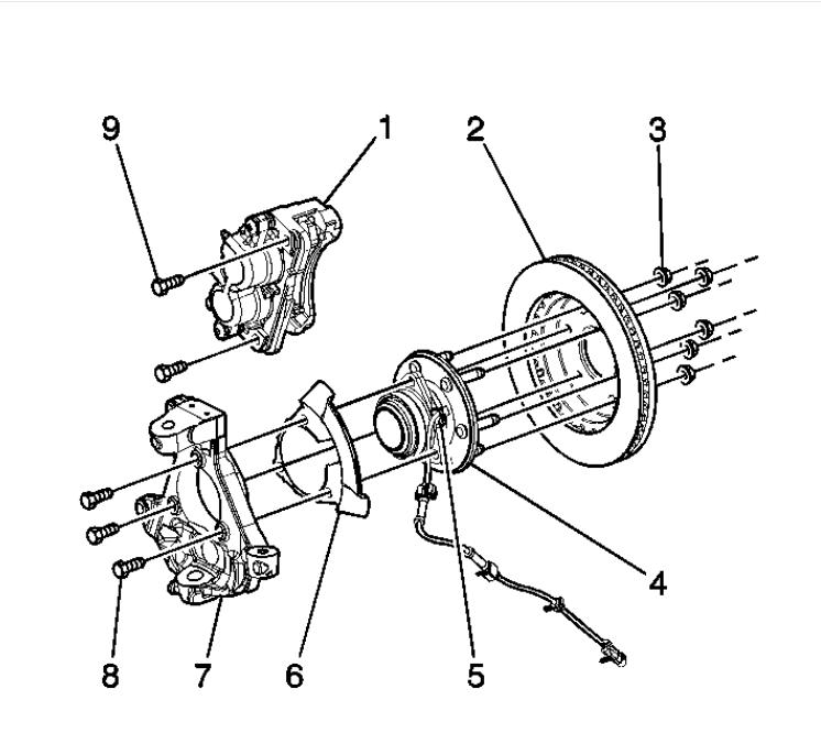

what is the procedure step by step for wheel bearing hub replacement on my 2001 chevy p/u 4wd.front driver side.its 4wd and its a sealed hub type?????????????????????????????????????????????????????????????????????????????????????????????????
HMAC300
  • 48,601 POSTS

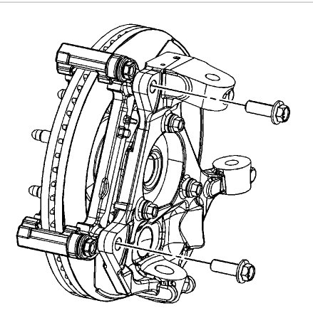

remove brake caliper, rotor, bracket, dust shield. remove brake hose and wheel speed sensor from steering knuckle. Remove dust cover and then nut an dwasher for axle. remove bolts that hold hub in knuckle. reverse for reassy. picture is of 1500 series 2500 series is a little different Retorque axle nut to 177 ftlbs for assembly and hub bolts to 133 ft lbs.

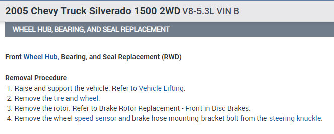

MEXABILLIE
I just had my driver side front hub bearing replaced to my 2000 chevy silverado extended cab pick up. I took it in for an alignment and they said they could not do it because the hub bearing needs to be replaced. I told them that I just had it replaced they said it was bad. Is there anything else that it could be?
Feb 7, 2021 at 1:45 AM (Merged)
  • 110,244 POSTS
I would have a second opinion. Either they are wrong and it is good, the shop didn't replace the bearing that they said they did, or they got a bad bearing. Take it back to who replaced it and have them check it.

SCOOTY62
Can't seem to get the bearing to break free, is there a trick I am missing? Caliper, caliper bridge are both off and all 3 bolts holding the bearing assembly have been removed. Have soaked with penetrant, still to no avail. Any suggestions would be greatly appreciated.
SCOOTY62
Got It,
Once you have the caliper, caliper bridge and 3 bolts holding assembly removed just get 3 M 14 x 1.50 bolts, thread them into hub from back side and and tap each one in turn with a hammer till the assembly falls out. Work like a charm :D
