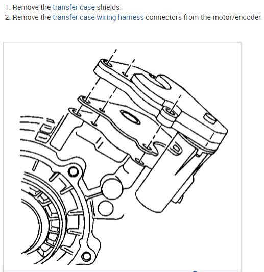

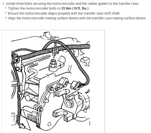

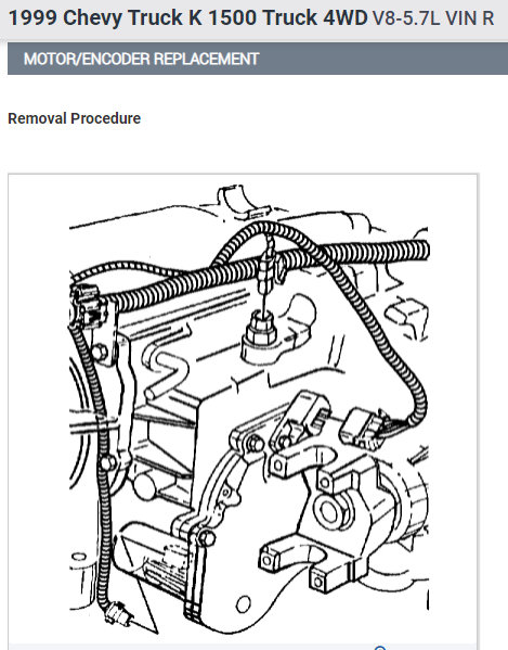

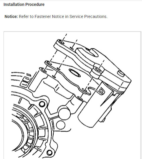

I was plowing this morning, and I got one of the front wheels into a soft gully, I rocked the truck back and forth to get out. The mud flap was pulled by the tire and riped out the fender cover over the tire about five mins later the lights on the dash that control the 4 wheel drive went out. The truck only has 2 wheel drive running. I checked the fues in the cab and engine compartment they are ok. I have riped out the fender cover befor last year and put it back in days later.
Wednesday, December 9th, 2009 AT 8:39 PM
DANNY L
  • 5,648 POSTS
Hello, I'm Danny.
There is a possibility the transfer case motor has been damaged. I've attached picture steps below on how to replace and the location of the transfer case motor on your truck. Hope this helps and thanks for using 2CarPros.
