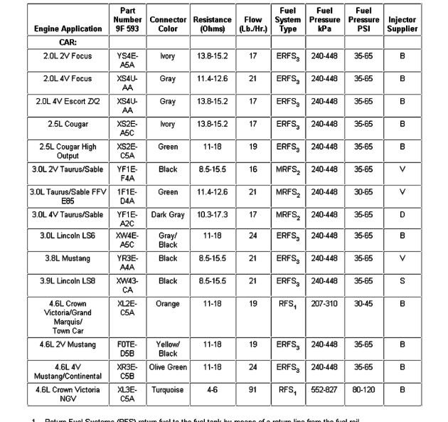

Hello. To me it sounds like a fuel delivery issue. It is possible to have the pump run but not put out enough fuel to start or run the car. I'd suggest a fuel pressure test. Go to the local parts shop and borrow a fuel pressure test gauge. They'll require a deposit so bring your wallet. Then follow the steps in the guide that I'm posting below:
Start there and let us know what you get. You should get close to 65psi with the key on, engine off and closer to 35psi with the engine idling

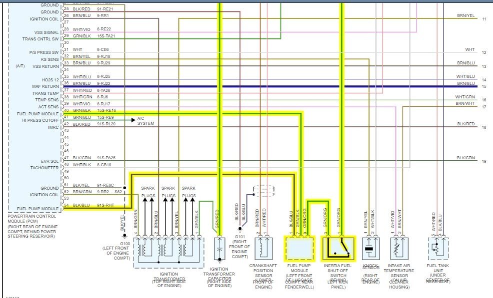

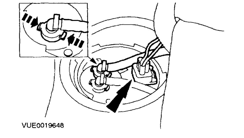

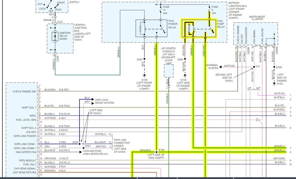

Good morning,
I would start by checking the actual fuel pressure. The pump can work but not produce pressure. You can rent a tester at a parts store.
The module only sends power to the pump It does not regulate the pressure.

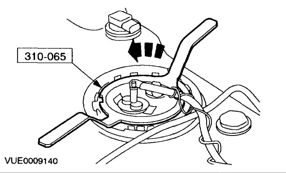

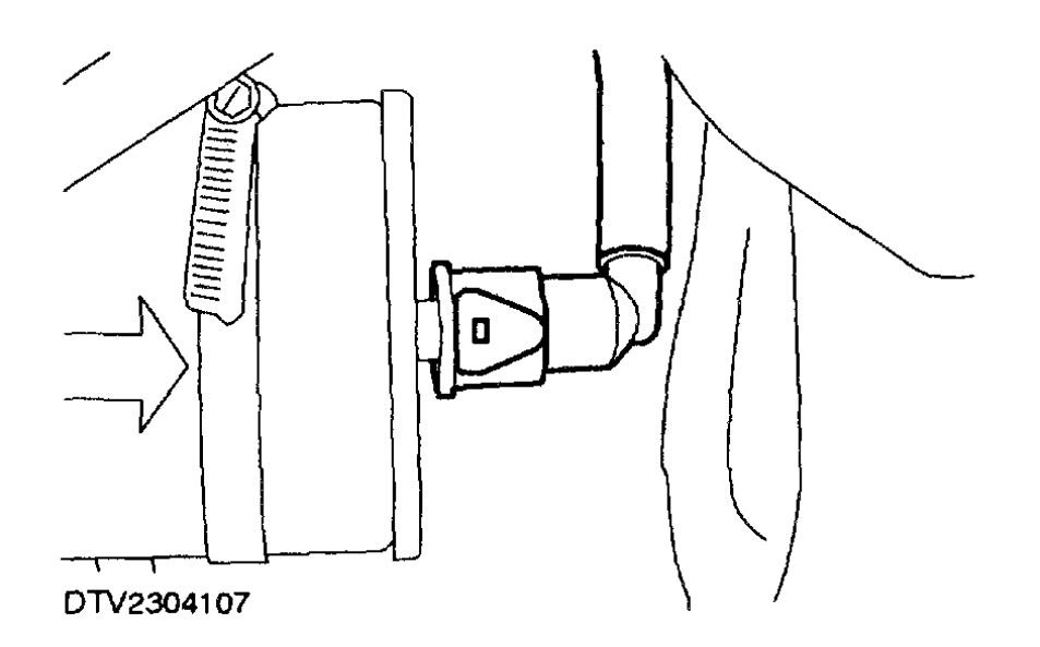

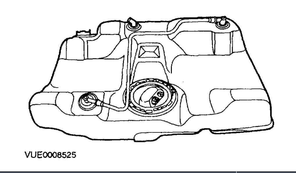

I attached the wiring diagram along with the procedures for replacing the pump.
https://www.2carpros.com/articles/how-to-replace-an-electric-fuel-pump
SPECIAL TOOL(S)
Warning: do not smoke or carry lighted tobacco or open flame of any type when working on or near any fuel related components. Highly flammable vapors are always present and may ignite. Failure to follow these instructions may result in personal injury.

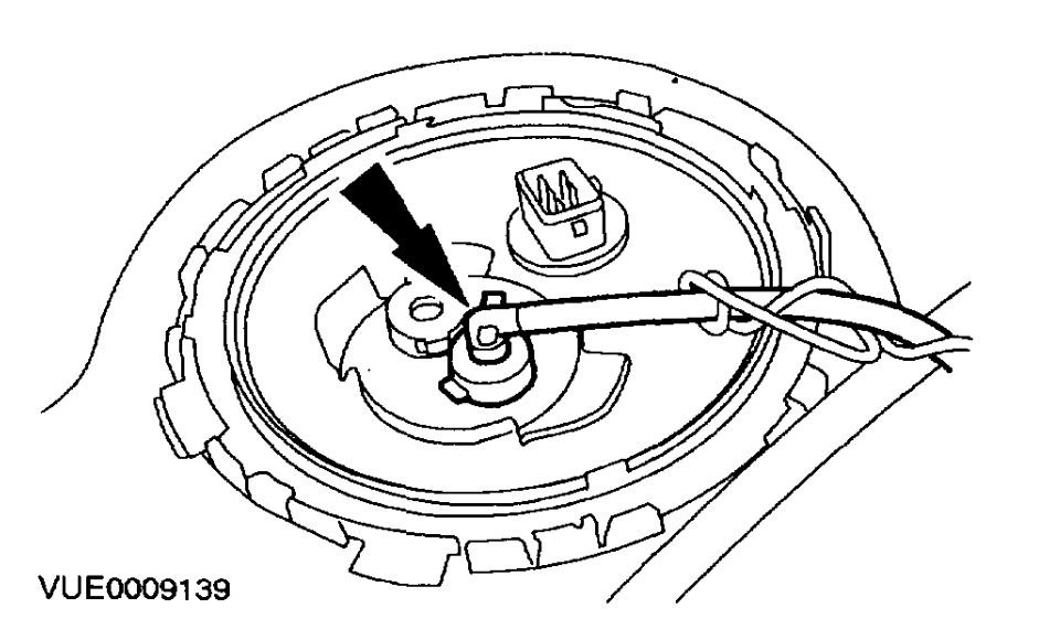

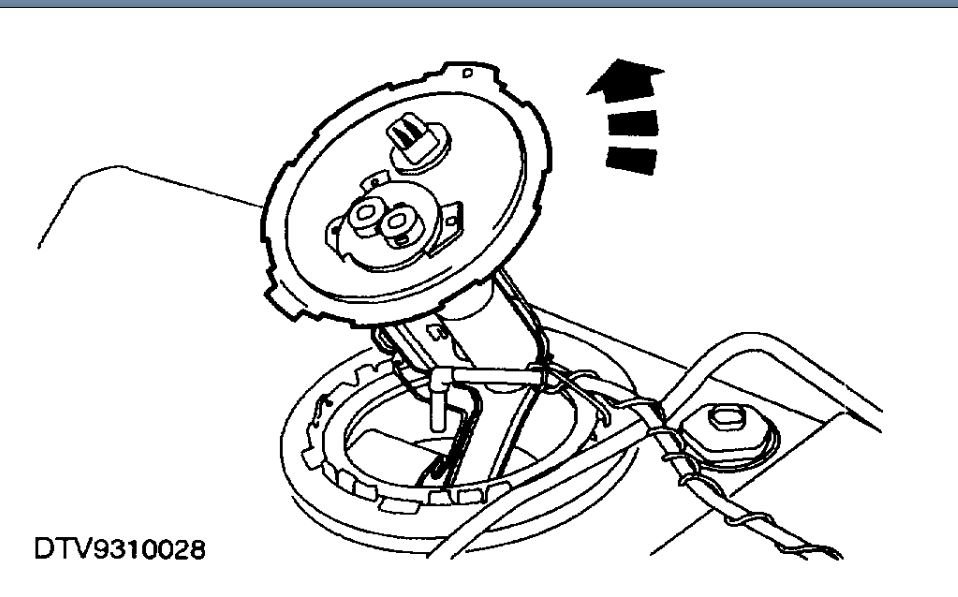

REMOVAL
1. Remove the fuel tank See: Fuel Tank > Procedures.
2. Disconnect the fuel feed pipe.
NOTE: Fuel supply line connectors are white or are identified by a white band. Fuel return line connectors are red or are identified by a red band.
3. Remove the fuel pump locking ring.
4. Remove the fuel pump.
5. Remove and discard the O-ring seal.

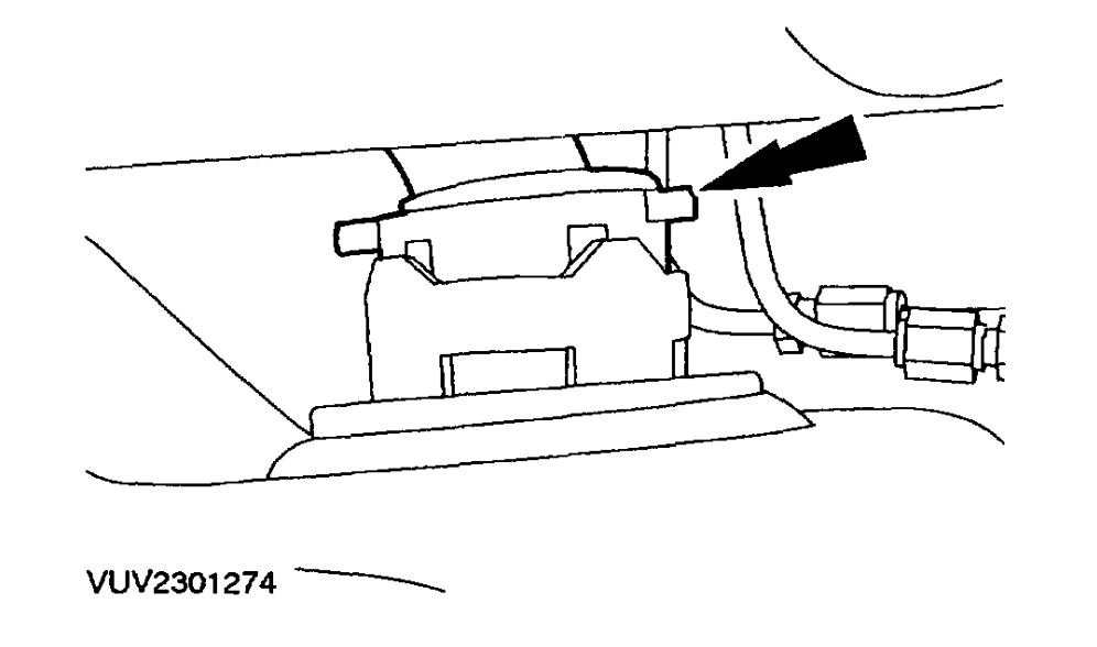

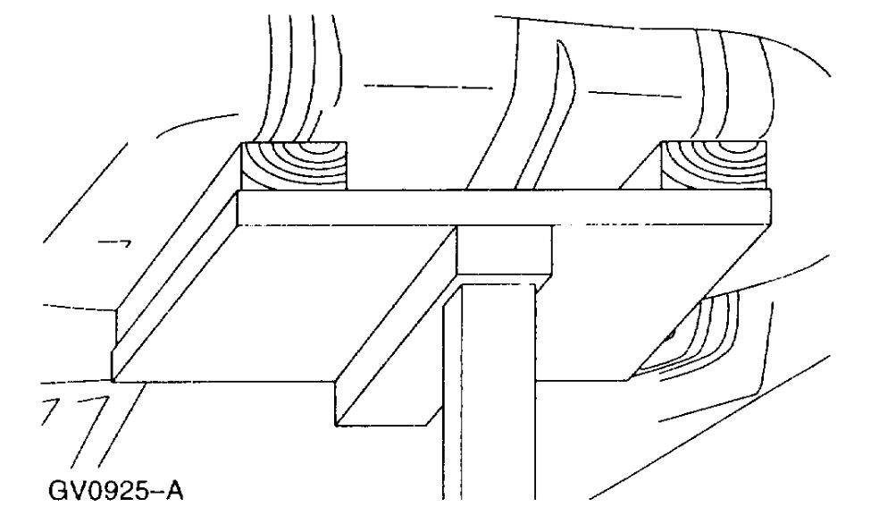

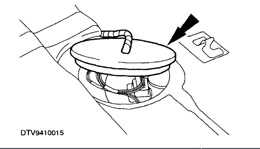

REMOVAL
1. Drain the fuel tank.
2. Remove the rear seat cushion.
3. Detach the grommet.
4. Disconnect the fuel pump module electrical connector and disconnect the fuel return line.
5. Raise and support the vehicle.
6. Disconnect the fuel filter outlet connector.
7. Support the fuel tank.
CAUTION: When supporting the fuel tank, use a suitable packing material to prevent damage to the underside of the fuel tank.
8. Remove the fuel tank support straps.
9. Partially lower the fuel tank.
CAUTION: When lowering the fuel tank, make sure that excessive strain is not placed on pipes and electrical connectors.
10. Disconnect the fuel filler neck from the fuel tank.
11. Disconnect the fuel vapor recirculation hose.
12. Disconnect the Onboard Refueling Vapor Recovery (ORVR) refueling hose (if equipped).
13. Remove the fuel tank (vehicles with returnless fuel system shown).

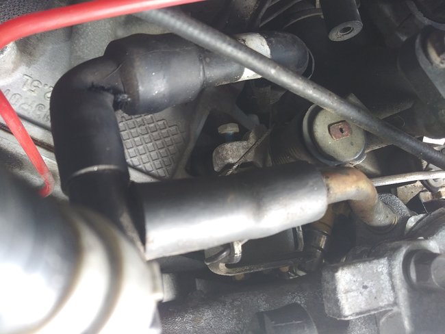

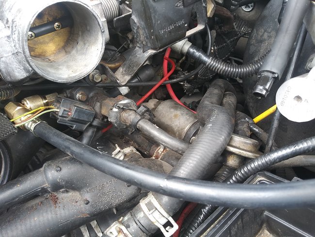

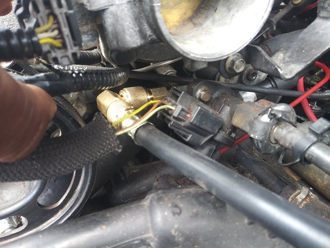

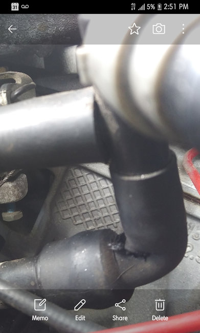

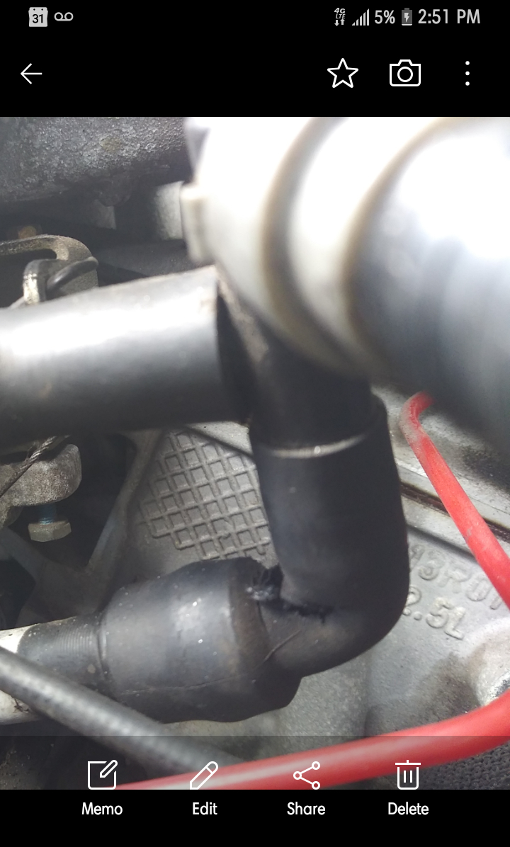

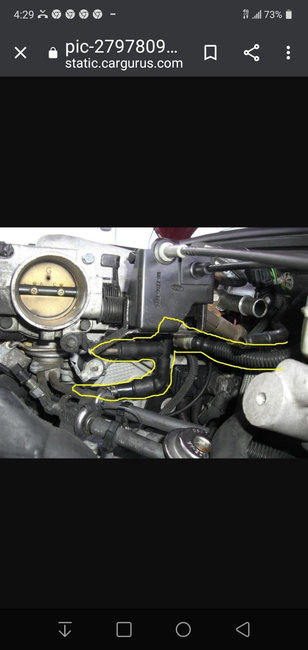

Hey guys, I have the pressure gauge connected to the only thing that resembles a schrader valve that's connected to the fuel rail and I'm getting no psi, no movement on the gauge. Before I went to rent the gauge kit I disconnected the fuel filter line leading into the filter and had someone turn the key on to assure myself that fuel was coming from the tank and a decent amount did.
I've noticed I have a connecting hose broken and I'm attaching pics. I do not know if this hose is relevant or even if it happened previously or during the time I was changing the spark plugs.
By what you can see do I have the correct valve for reading the fuel pressure? Thanks
Sep 21, 2020 at 3:55 AM (Merged)
Okay, thank you for the picture.
Can you hear the pump run when you turn on the key?
If you do, the pump is bad as it should give a good pressure to the rail.
If it does not then we need to do some testing.
No, the hose is part of this issue.

Can you identify the broken hose?
The pump can run and produce no pressure. That is an internal failure in the pump.
Can you take more pictures of the hose and post them for me?
MACHSWELL
  • 18 POSTS
These are the same pictures but close up. I'll try for more shortly but as it stands I should go ahead and order a full pump?

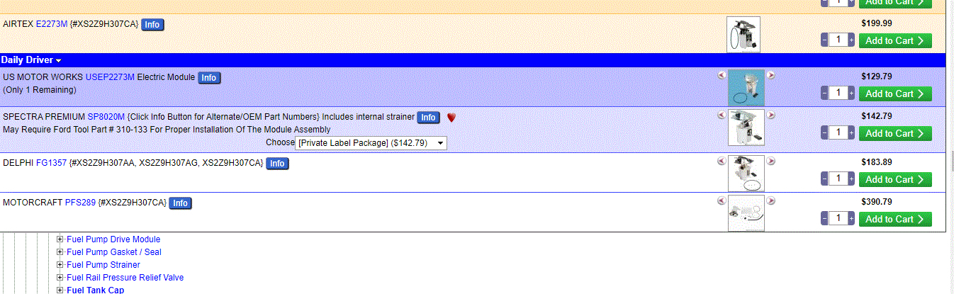

Yes, order a pump assembly. Rockauto has the best prices for this.
Yes, that hose is no good. I would replace it. I think it is called a breather hose but when you order it, take the picture with you to identify it.
MACHSWELL
  • 18 POSTS
You recommend purchasing the entire assembly?
Yes, I do. I have had too many issues with just the pump replacement. I know it is cheaper but cheaper is not always the best.

This hose i broke doing the water pump. Can anyone identify it? I don't think it's the breather hose as suggested but i could be wrong again. Thanks guys.
