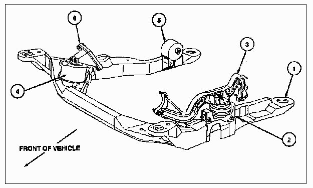

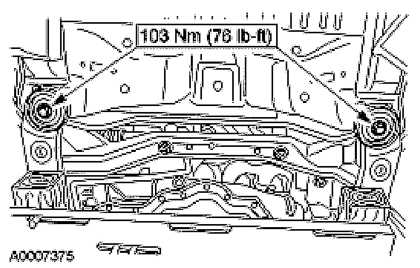

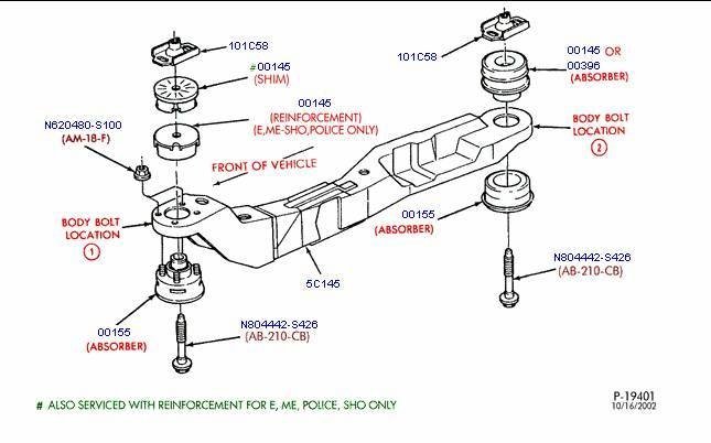

Subframe mounts, where are those?
Saturday, September 8th, 2018 AT 7:15 PM
STEVE W.
  • 13,573 POSTS
Under the car. There are four bolts that retain the front sub-frame to the chassis. Two in front two toward the rear. The sub-frame holds the engine and transmission in the car. What you are hearing could be those mounts creaking a bit as they are loaded and unloaded by the vehicles motion. When you step on and off the brakes the engine and transmission transfer power through those mounts to move the vehicle. If the bushings are worn and move even a small bit they could creak. There are kits out there to replace them. The two rear ones are the most failure prone and one sets just about directly under the drivers foot well. However, while they are replaceable you might be better off just spraying them with some silicone lube to see if you can quiet them. They are not really difficult to replace but if things are rusty they can become an issue.
