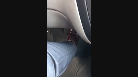

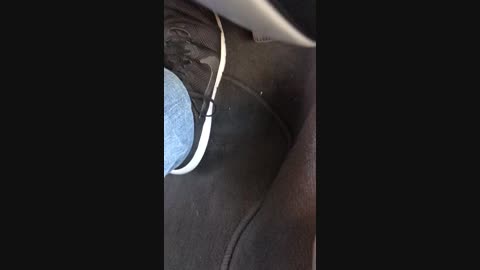

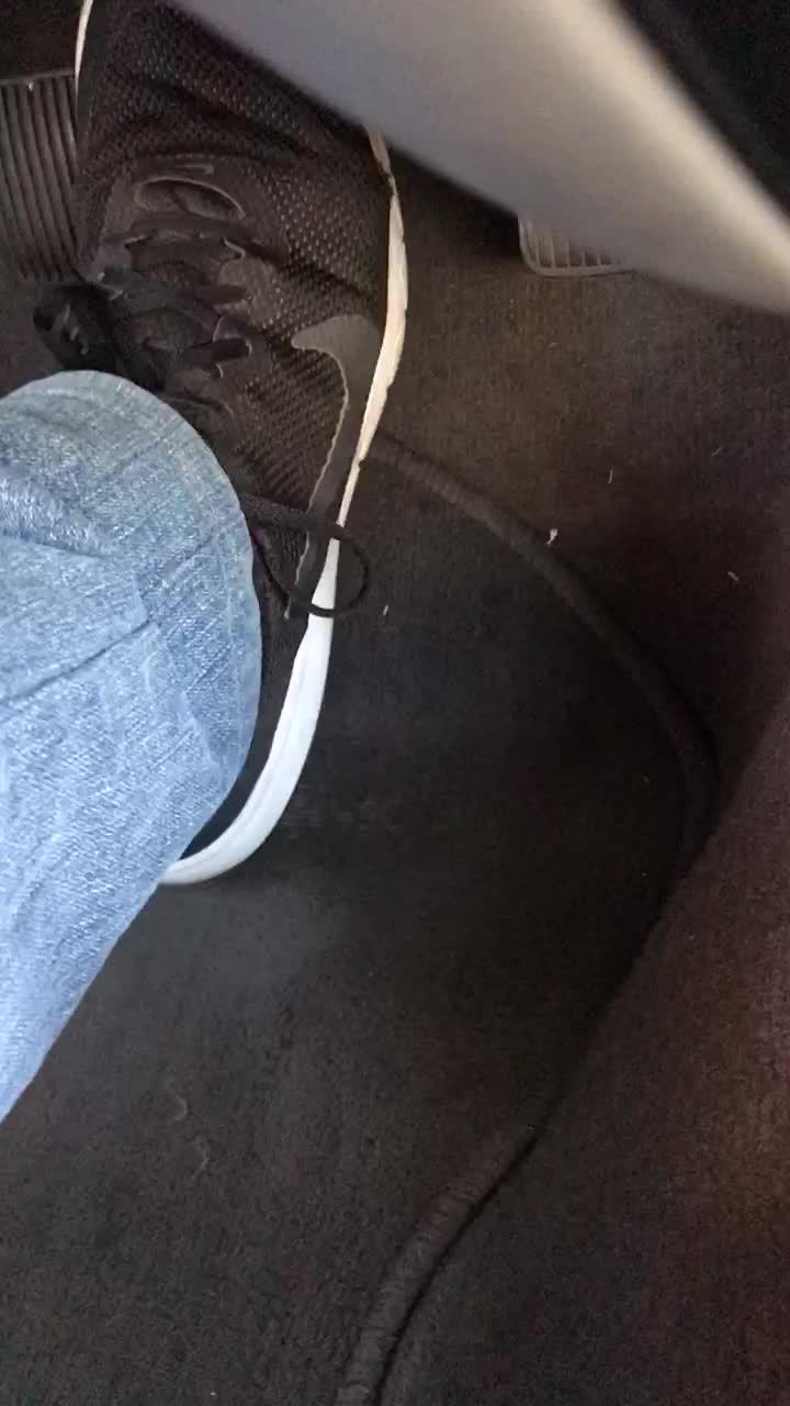

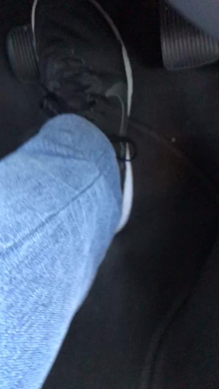

So I drove to work this morning and took a few videos of me slowly moving my foot off the brake pedal. This first video is a few minutes out of the driveway when I came to a stop, you can clearly hear the groaning noise coming from the brake pedal area.
May 17, 2018 at 12:03 AM
JGONZO2398
  • 374 POSTS

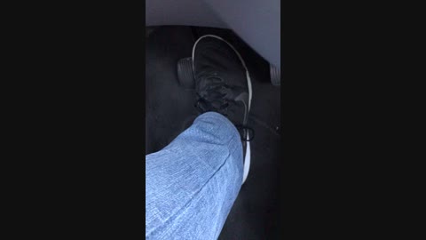

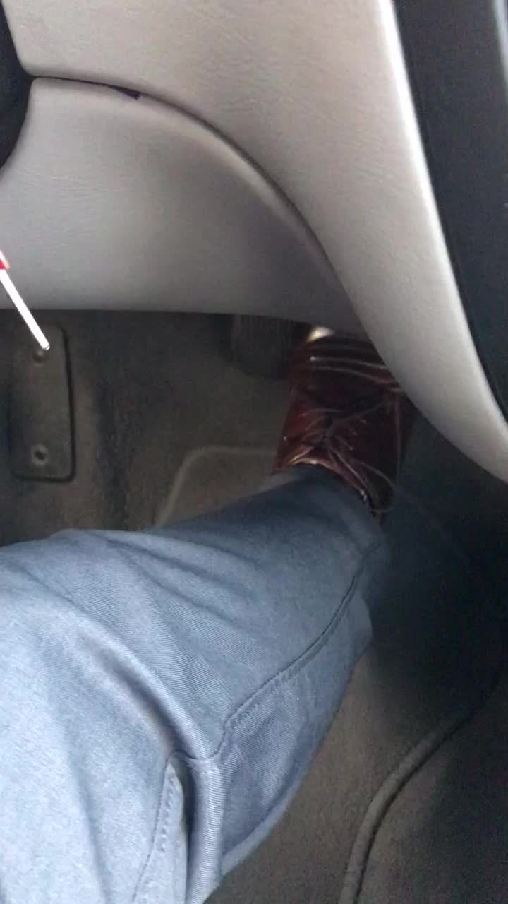

In this second video, the groaning noise drastically dropped, this was taken literally only a few minutes after the first video after a couple of stops. Also, lots of creaking coming from the brake pedal whenever I step down on it. It seems as if though after some driving, the groaning noise that is produced from slowly releasing the pedal, goes away.
May 17, 2018 at 12:06 AM

The creaking is not from the booster, it sounds like the upper pedal bushing. The sort of hiss that you hear is the valving on the booster as it lets air in to create the assisting force. If it has been driven a while with the various points rubbing it may take removing the brake pedal to get the lube in where it is needed. It is also possible the bushing in the pedal is damaged after fifteen years.

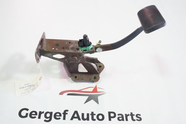

Sorry for the super late response. I still have this issue with the brake pedal. Really loud groaning noise when slowly releasing, I have the sprayed the metal joints and entire assembly with chain lubricant and also white lithium grease. I found a pedal assembly on eBay but I just wanted to show you the picture to find out what specific parts I need to lubricate. If I did not mention it before, probably five months ago I replaced the front disc, pads and calipers and the rear drum brakes were completely replaced at Firestone a little over a year ago. I have had the issue for over a year now.

STEVE W.
  • 15,352 POSTS
If you have someone set in the car, close the door and step on and release the brakes can you hear the noise outside? How about if you set in the car and with the engine off, pump the brakes to use up the vacuum in the booster. Does the sound still occur? If not start the car with your foot on the brake and listen as the vacuum refills the booster, then let the pedal up fast, what do you hear?

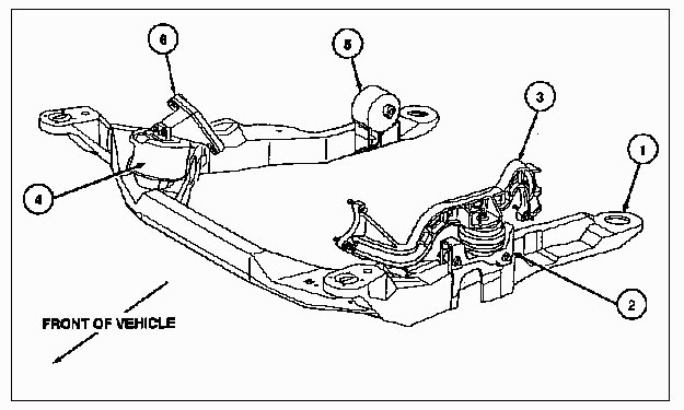

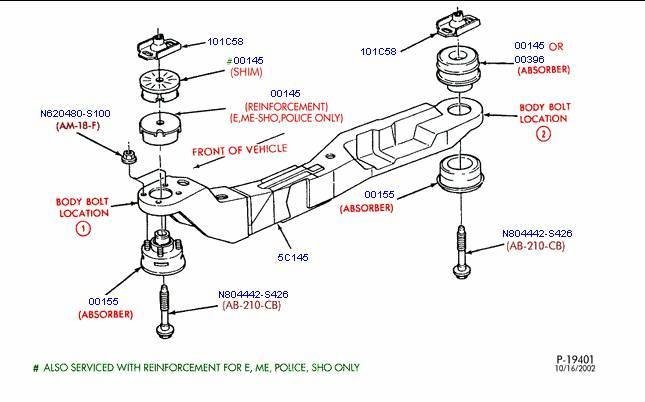

Ken, that was my first thought, had him lube the pivots, still noisy. However, if you can hear it outside the car and feel it as well I would look at the sub-frame mounts where they bolt to the rest of the chassis. It could be the bushings are shot and the groaning is the sub-frame shifting in relation to the rest of the chassis as the car moves.
Sep 8, 2018 at 11:24 AM
JGONZO2398
  • 374 POSTS
Subframe mounts, where are those?
Sep 8, 2018 at 12:15 PM

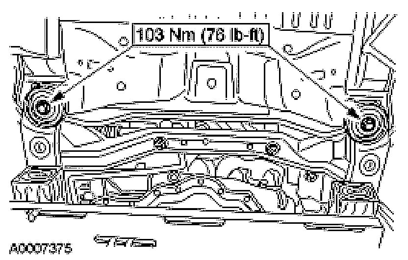

STEVE W.
  • 15,352 POSTS
Under the car. There are four bolts that retain the front sub-frame to the chassis. Two in front two toward the rear. The sub-frame holds the engine and transmission in the car. What you are hearing could be those mounts creaking a bit as they are loaded and unloaded by the vehicles motion. When you step on and off the brakes the engine and transmission transfer power through those mounts to move the vehicle. If the bushings are worn and move even a small bit they could creak. There are kits out there to replace them. The two rear ones are the most failure prone and one sets just about directly under the drivers foot well. However, while they are replaceable you might be better off just spraying them with some silicone lube to see if you can quiet them. They are not really difficult to replace but if things are rusty they can become an issue.
