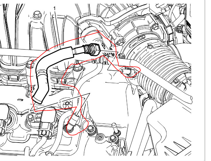

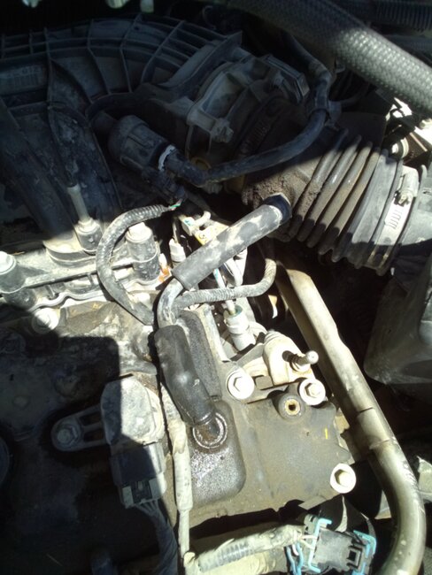

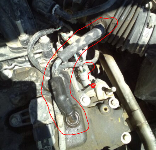

So, I have an air leak I can hear it. I have found this part needing replacement and it is at least tied somewhat to the air system. Okay, so it's not letting me load pic. It goes from engine block to the house behind the air filter. AutoZone said it might be fresh air intake or air bypass but weren't really sure. I'll try to load pic again.

It's letting me load pics now cool.
It's wet because a union joining the overflow radiator blew so water everywhere also how saw that ugly piece.

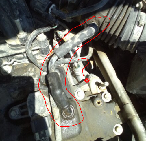

I made a copy of your pic and circled what I believe you are referring to. If I am wrong, let me know.
As far as the item is concerned, that is the PCV hose. There is a valve on one end and the other end is connected to the air inlet tube. See pics below
Let me know if I have the correct part. Also, note there is another PCV hose and valve at the rear of the engine between the intake manifold and the valve cover.

That is what I was referring to. What is that valve called? The part that goes into the engine. Also, the open screw hole in the engine block 2 inches to the right of valve is that supposed to be empty? Thanks

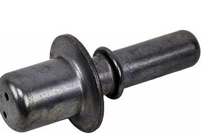

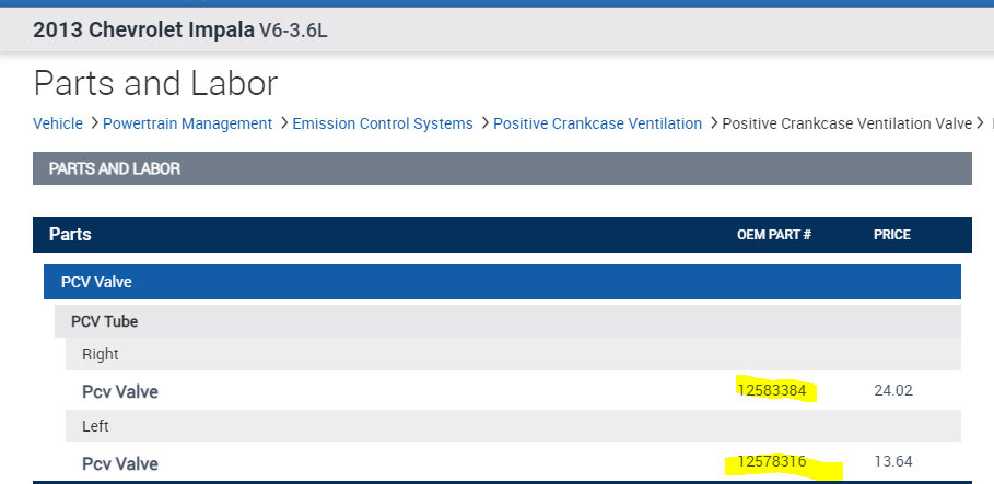

What is the name of the valve? Do you have a part number for the valve? Thanks

  • 110,244 POSTS

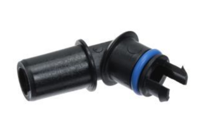

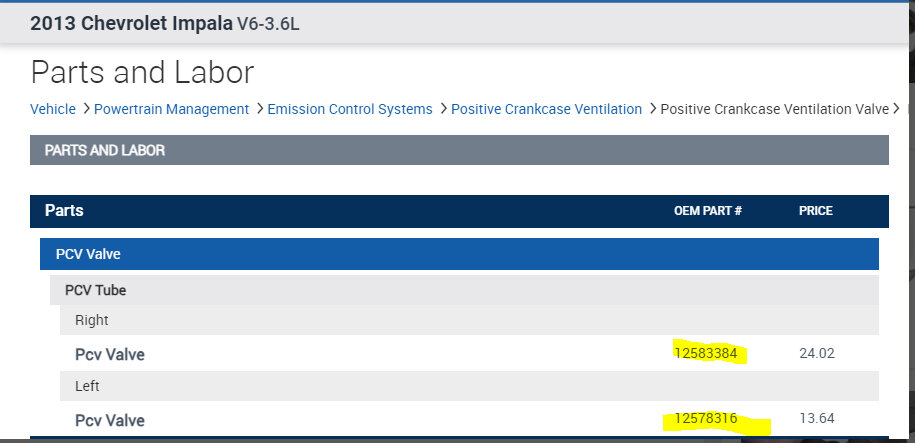

The valve is called a PCV valve. PCV stands for positive crankcase ventilation. It releases crankcase pressure and gases from the engine and re-burns them in the engine.
Remember, there are two on this vehicle as mentioned above. If you look below, I attached the manufacturer's part numbers and a pic of the two different valves. I'm confident you can get them for less at a parts store or somewhere like Rockauto.com.
Let me know if this helps.
See pic below. I'm not 100% sure based on the pic, but I believe the part ending with 384 is the one you need. Check to see if pic 2 looks like what you have.

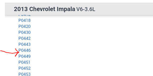

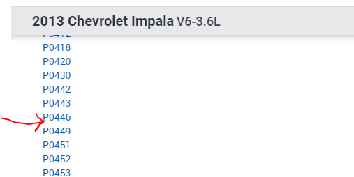

I just tried to look up the P0448 code for this vehicle. It isn't relevant for this vehicle. Are you sure that is correct? See pic below
Next, is that code still present? Is that the only code that was stored?

Sorry p0448 was the code.

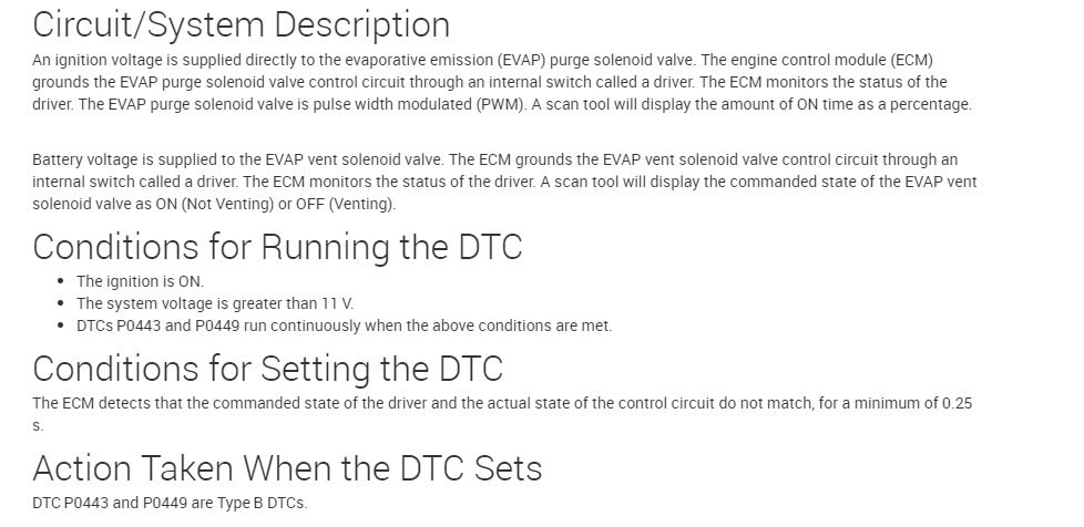

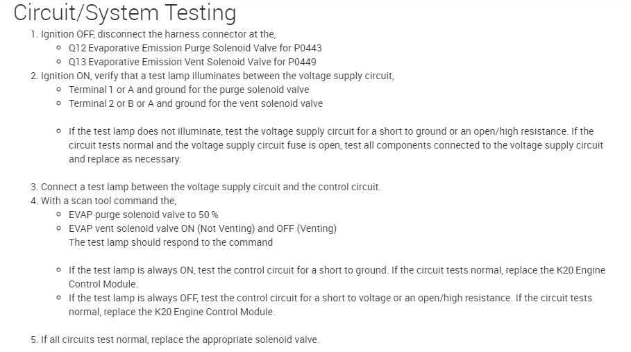

  • 110,244 POSTS

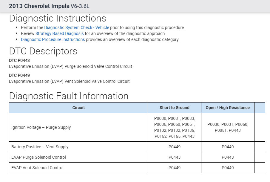

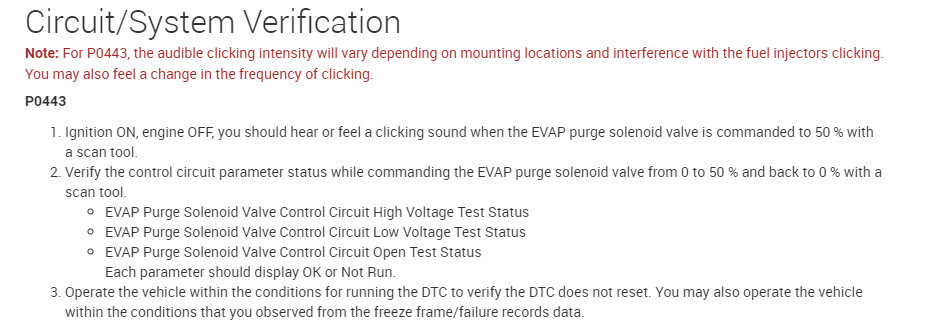

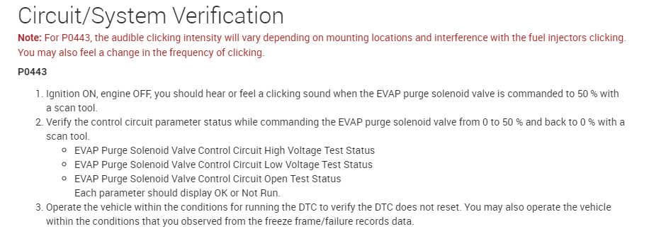

This is an interesting one. I'm aware the code is related to the canister vent valve, but it isn't listed for me. Instead, codes P0443 and P0449 are related.
I attached the diagnostics below for the codes I mentioned. Take a look and let me know if you are comfortable performing them or if you even feel they are relevant.

Hey sorry about this, I gave the wrong code p0449. I'm sorry to make you have to do more work. It says evaporation emission (evap) vent solenoid valve control circuit. With that I replaced the evap canister solenoid back by the gas tank. Next, I was going to change the evap purge valve in the engine because that is what came up on most popular fix is the purge valve that was O'Rielly's.

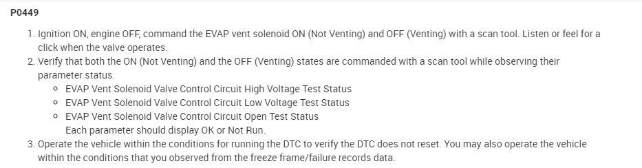

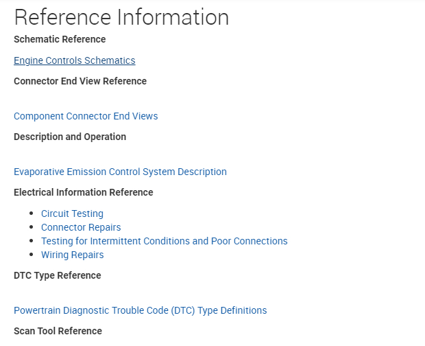

I can't read those pages with the symptoms I can't read. The whole left side of first page and right side of second page are cut off so really have no idea what's asking.
Aug 31, 2023 at 6:00 PM
  • 110,244 POSTS
Sorry about that. I didn't realize a portion was cut off. I attached it below.
The code that I provided the diagnostics for is specific to the P0449. Is there something different?

  • 110,244 POSTS
No problem whatsoever. By chance, did you ever locate the leak you mentioned above related to the PCV valve? Also, have any new codes shown up for you?
The code isn't a component issue, but instead, it is either a short to power, short to ground, or an open circuit.
When you replaced the vent solenoid, did you inspect the connector and wiring? With the key in the run position, are you getting power to the connector?

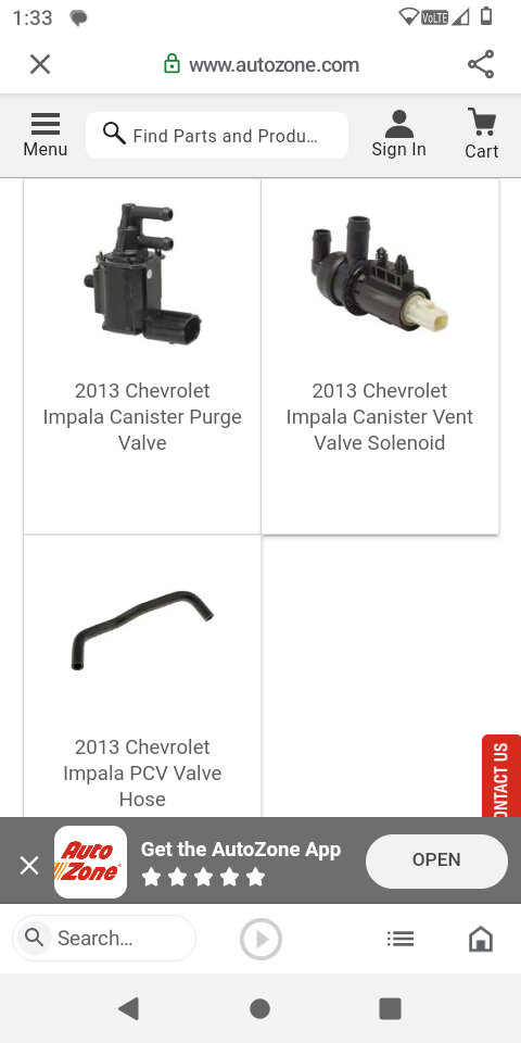

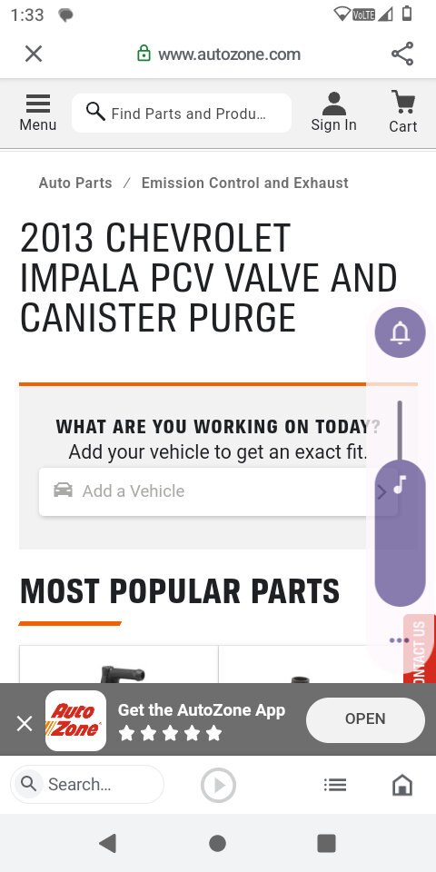

I searched AutoZone for PCV valve and this is what came up. Do you have part numbers for the valves?
Sep 4, 2023 at 6:35 AM
  • 110,244 POSTS
I only have the OEM part numbers. See pic attached below.
If you google search "GM part number ... " it should provide what is needed.
See pic below.

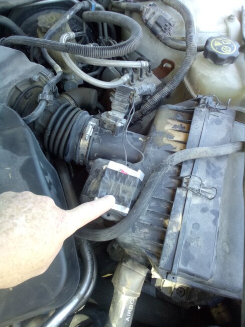

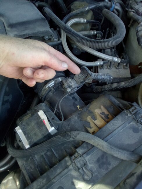

Thanks for part number. I'm getting a meter today to check voltage will let you know how that goes. Also, pic is a HP performance part that's junk. You see how it's wired spliced in. Could that be causing issues? So, I remove and connect wires back together? Thanks

Is that being used in place of the mass air flow sensor? If it is, yes, that can be causing issues. Lord knows what it is doing.

No, it's not in place of it's some module (because I don't know a better word to use) that you splice into whatever it said and supposed to increase horsepower by 50hp. Some gimmicky pos. If I can find any identification, I'll let you know.
