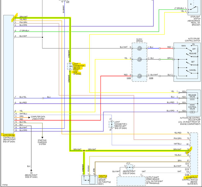

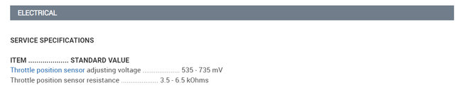

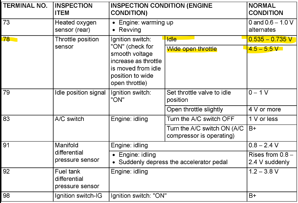

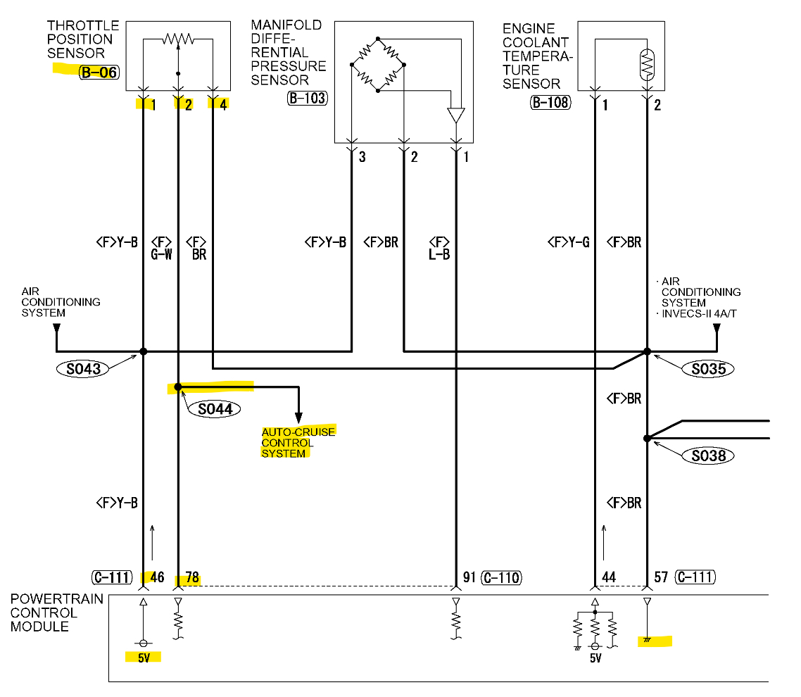

Hello, okay, service info on this is a bit iffy. According to the ECM connector voltage pinout, closed throttle should be 0.535-0.735 and wide-open throttle should be in the 4.5v range. I assume when you're checking the 5vRef you are using the sensor Ground or from battery ground?

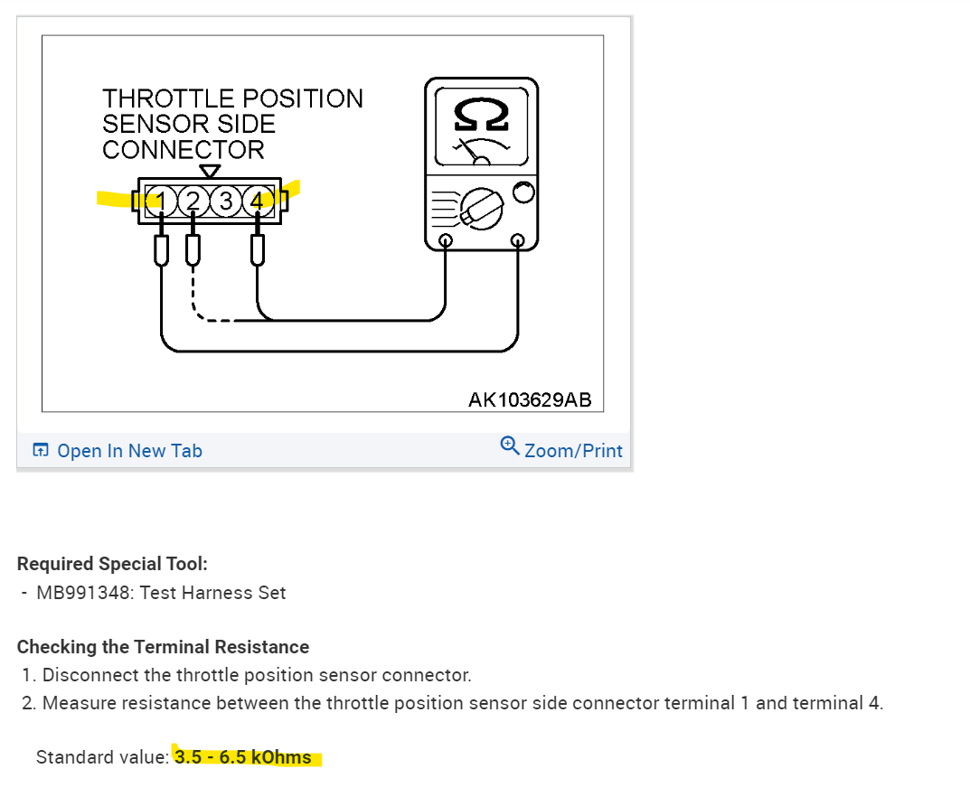

The resistance check for the sensor is 3.5 to 6.5kOhms for pins 1 and 4. Pin 2 being the signal pin. And it looks to be a 4-pin connector, but I'm not sure if that's what you have.
And you're back probing the connector I assume, does the 5vRef stay at 5 volts connected to the sensor?
Were you getting any diagnostic trouble codes?
I'm just wondering if you have a bad sensor, or if something else is pulling the signal down, the pin 2 signal does go to the Cruise Control module as well.

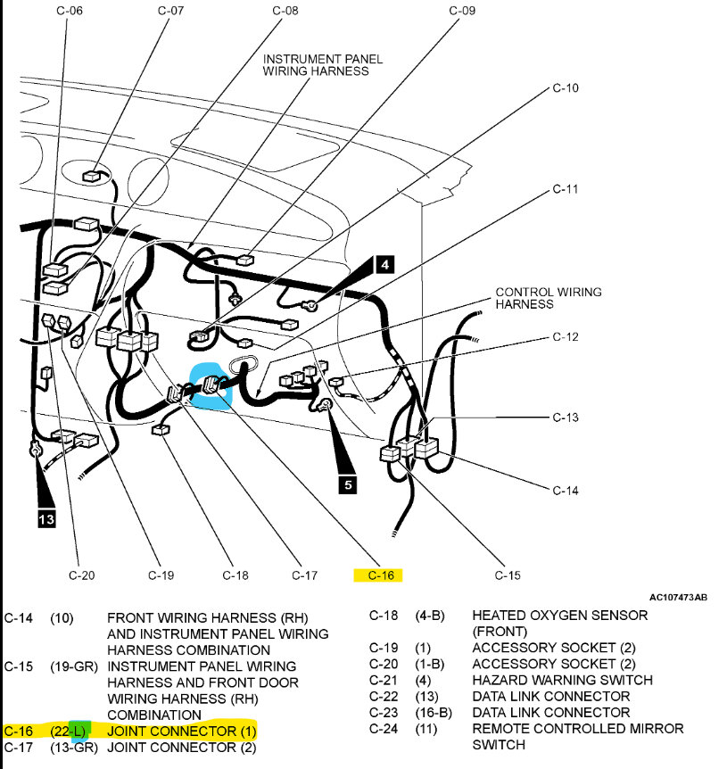

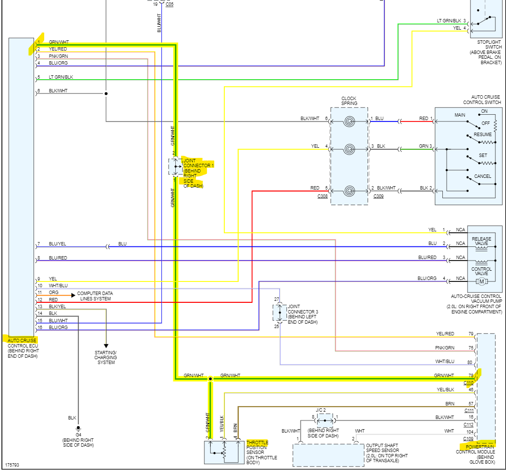

There's also this joint connector (C16 blue) it runs through before getting to the cruise control module.

Thank you so much. That's a lot of great information.
"I assume when youre checking the 5vRef you are using the sensor Ground or from battery ground?"
Battery ground.
"And youre back probing the connector I assume, does the 5vRef stay at 5 volts connected to the sensor?"
Yes, I am. It stays at 5V, no matter the throttle.
"Were you getting any diagnostic trouble codes?"
Yes, I am. P0171: System Too Lean (Bank 1)
I'm thinking about rigging the TPS until the signal wire delivers 0.535-0.735v, then removing the trouble code, and finally starting the car without pressing the throttle, to see if the error code comes up during idle after a few engine starts.

Did the resistance test come out to be higher that 6500 Ohms? If you've got low voltage on your signal wire, there has to be high resistance somewhere. It will most likely set a TPS low voltage code right away. 3 volts is too low. Id even go to a used parts yard and grab a used tps sensor, atleast it would be oem. But check that 5vRef using the Sensor ground and see if its a bad ground causing you issues. Unplug it and and just check across pins 1and 4. The sensor grounds through the ecm, so there could be an issue anywhere down the ground line. A bad ecm ground could even be causing the lean code, skewing sensor data.

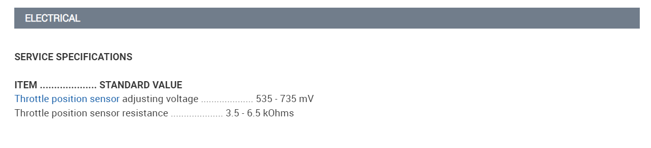

Okay, the resistance test on the TPS sensor unplugged should show its full resistance across pins 1 and 4 and should be 35 to 65 kOhms, if pins 1 and 4 only have 650 Ohms unplugged, that sensor is junk. But you have to unplug the sensor to do a resistance test,

"Ok the resistance test on the TPS sensor unplugged should show its full resistance across pins 1 and 4 and should be 35 to 65 kOhms, if pins 1 and 4 only have 650 Ohms unplugged, that sensor is junk. But you have to unplug the sensor to do a resistance test"
I was doing it wrong. I was checking the wire connector (no power), checking for a short in the wiring. I checked pins 1 and 4 on the disconnected TPS, and I only got 5.7 kOhms.

Yes, that resistance reading is low, 35 kOhms is the lowest it should be. It will just set a code for it, I don't know if it will go into any kind of low power (Limp) mode. The vacuum gauge is not really going to do much in this case. Just watch the fuel trim numbers, you'll know in a couple of minutes if the trim numbers start to drop down. If they stay at 30 percent, then we would start going over the sensor data to see why it's adding so much fuel. But it's probably an intake manifold gasket or a broken hose, stuck open purge valve, etc.

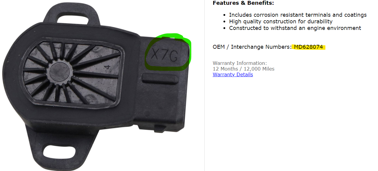

What brand sensors are you getting? So, on the bench with 5volts and ground to the sensor you're still only getting a max of 3 volts at WOT? Are you using a basic multimeter for this testing? and is it possible there is a low battery in the meter? Just trying to think of other possibilities for your results.
May 20, 2023 at 12:04 PM
VSPINNET
  • 19 POSTS
I'm using a Astroai Digital Multimeter TRMS 4000 which I just got. I'll try fresh batteries in the multimeter. If I get different readings, I'll let you know.
The TPS is only giving me 3V at WOT on the bench (on the vehicle as well). I should say, it tops out at 3V, and then the voltage begins a drop to zero as it's turned all the way. The brand is ISUMO: https://www.ebay.com/itm/181436237824
May 20, 2023 at 7:21 PM
AL514
  • 5,661 POSTS

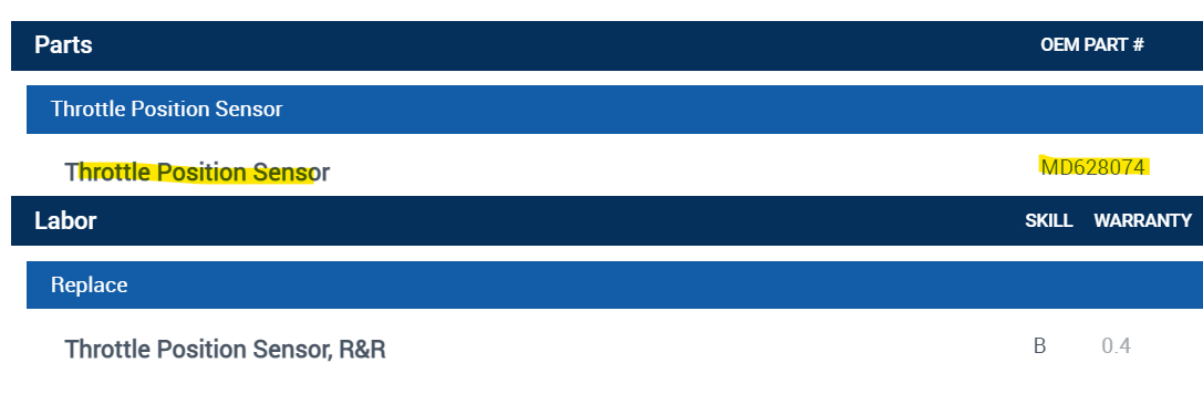

Yeah, that is definitely a cheap sensor, I think you're going to find any of those type of knock off aftermarket sensors are going to do the same thing, and if you do get one that works it will not last long, here is the manufacturer OEM part number for the TPS (diagram below). The OEM part is actually very expensive, $256. But try rockauto com, they have decent parts that will last. They have one for $99.00 that replaces the exact OEM part number (2nd diagram). Here is the link so you can check it out. I'm wondering with the cheap sensor are you getting that same voltage reading on your scan tool data? With the Key On engine off, you should be able to press the pedal wot, and get the same voltage reading you're seeing on your multimeter, which will at least verify it's a sensor issue. And that the ECM is seeing the same voltage. Check that just to be sure, I know it's going to set a low voltage code but clear the code and try that live data PID before the code sets again.
Looks like a decent meter, just turn off the auto range setting when bench testing the sensor, if it's on, see if anything changes then. Probably it won't make a difference, that's cool, they give you a temperature sensor with it.
https://www.rockauto.com/en/moreinfo.php?pk=2001386&cc=1434226&pt=5136&jsn=359

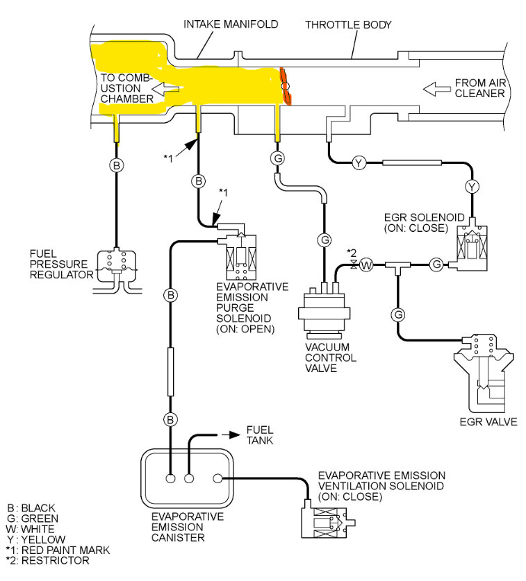

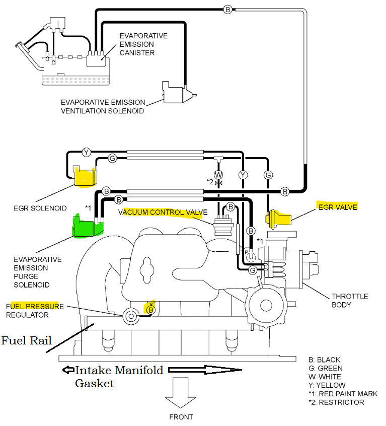

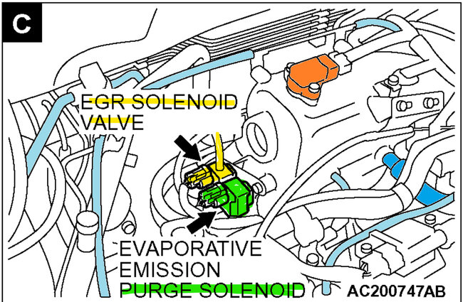

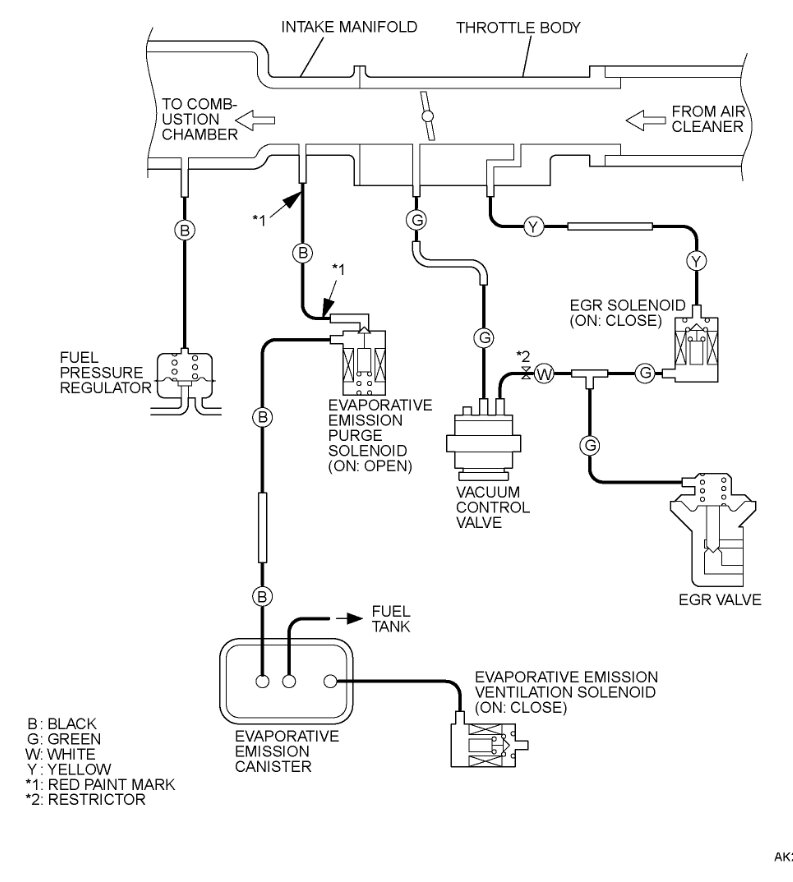

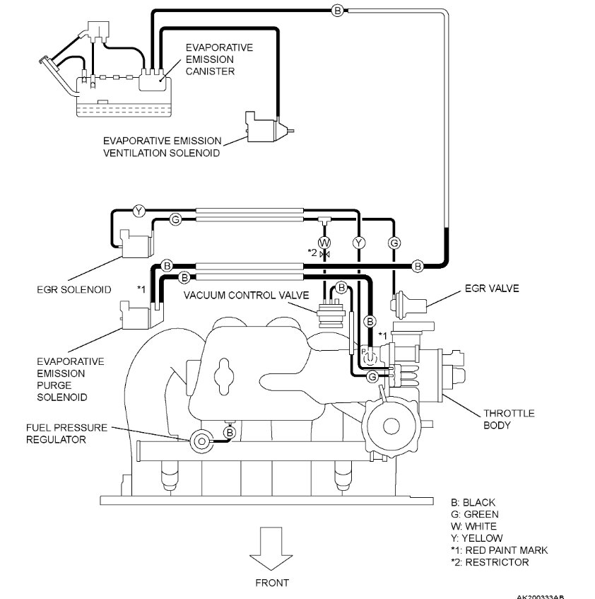

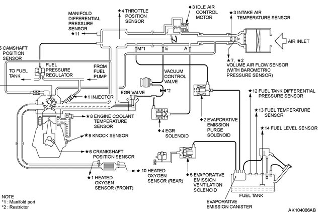

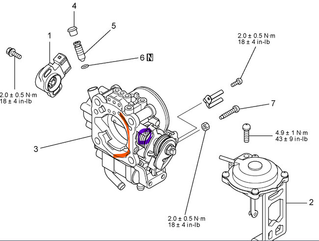

Okay, a couple things come to mind with odd readings like that, it might not be a ripped gasket type of vacuum leak, since those readings are opposite of each other at times, I'm wondering if the EGR solenoid or Evap Purge solenoid are part of the issue here. The EGR valve will be turned on when accelerating at the point where the cylinder temperatures are going to be at their hottest. The EGR allows a small amount of exhaust gases to be directed back into the intake manifold, this helps to prevent the cylinders from reaching these higher temperatures where the NOX gases are produced, it's an emissions related component. It is possible the EGR valve or control solenoid are leaking. Also, the Evap purge valve is another component that will turn on to pull fuel vapors from the gas tank into the intake manifold so they can be burned, this also helps in reducing emissions.
Try blocking off the EGR solenoid(yellow) and vacuum hoses going to it and also the ones going to the EGR valve which that solenoid controls. Do this one at a time and see if the Fuel trims stabilize at all. Then do the same to the Purge solenoid and its vacuum lines. From what I remember of this engine, I tried to mark out the other vacuum lines in light Blue, the darker Blue looks like part of the PCV hoses and in Orange is the MAP sensor, that takes a reading directly from the Intake manifold, that's why its bolted right to it, but it does have a rubber O-ring or gasket as well.,
For the vacuum lines, try to block them off at the point where they run into the intake manifold. When you find one that makes a change on your fuel trims, follow that hose and see what it controls. Manifold vacuum is at its highest point at idle when the throttle plates are closed. Some of the older systems use a ported vacuum to operate the EGR valve, ported vacuum is going to be right before the throttle plates, so when the throttle plates start to open, vacuum will be applied to that vacuum hose. You may not find this type of system on an 03', hence the solenoids for control. If the vacuum lines are not too brittle, you can just pinch them off with a pair of pliers or vice grips. Just try not to crush or damage the hoses. See what you get with these tests,
I'm not sure if you tried spraying water around the intake manifold gasket area yet, I may have missed that in your posts, but if the intake gasket is bad enough, you'll hear it will a spray bottle and water. I will see if I can find a vacuum hose diagram for your vehicle as well. Here is a diagram (diagram 2) of the vacuum hoses related to emissions components.
The 3rd diagram shows the area where manifold vacuum will be at its highest at idle, notice the throttle plates are closed
This might help too, smoke machines can be very expensive, some are almost $1,000.00, this video shows how to make one of your own, the trick here is you need to buy resistance wire, you can't use regular wire. This one also doesn't include a pressure gauge, but you can add a small tube and use your vacuum gauge if you have the type that reads vacuum as well as up to 10 PSI, I know harbor freight sells some vacuum/low pressure fuel gauge sets. I built one of these to see how well they work, and it was really good, you just can't over pressurize whatever system you're smoke testing. Just a few psi is usually enough to find any vacuum leaks on intake manifolds. The Evap system going to the gas tank cannot take more than 1-2 PSI, so you have to be very careful and monitor how much pressure you put into that system, so have a gauge on it is important. But this smoke machine you can build for really cheap. Just follow his instructions carefully, you'll need your multimeter to measure the 2.5 Ohms of resistance wire that goes inside, but if you don't have enough money to buy a real smoke machine this works good.
https://www.youtube.com/watch?v=tixozqgSwN0

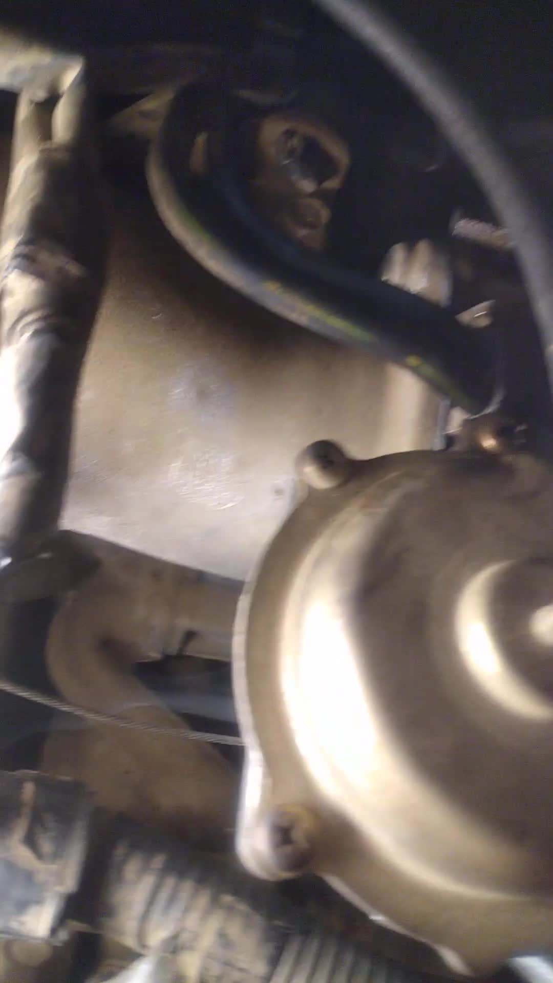

I got underneath the car, and it looks like I'm going to need a dual exhaust pipe flange gasket. The nuts and flanges look like they're in great condition, so I suspect I won't have much of an issue. In the morning, I'm going to try to tighten the nuts first, and see if it stops the leak.

Yes absolutely, if there is a place where air is entering the exhaust the Oxygen sensor is going to read that as a lean condition, the ECM will enrich the mixture, but then either the other oxygen sensor will read incorrectly or other sensors will, and the ECM will just go back and forth not knowing what the correct mixture should be. Thats why your short-term fuel trim was dancing all over the place.
If you need to replace any gaskets, I will spray the bolts, or nuts with penetrating oil and let it sit overnight if I have the time, spray it again before doing the job. That helps a lot. Getting it hot sometimes will help, you just have to be extra careful not to get burned. Wear thick gloves. But it sounds like you're on track there. Your spark plugs might be carboned up somewhat because of the rich mixture, so you might want to take a look at them as well. Good idea with the shop vac, I've never pumped air up the tail pipe before. Thats thinking outside the box for sure. Exhaust leaks like that can be tricky. Nice work though.

Wonderful. I hope that's it. I tried tightening to see if it would stop leaking, and it didn't work, so I just removed the gasket which came off with ease, especially after spraying it with penetrating oil. The auto parts store will have a gasket for me tomorrow. I'll let you know how it goes.

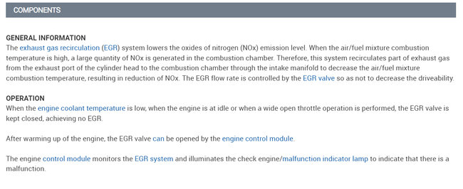

I read that some EGR valves have a vent that may put out smoke during these tests which is supposed to be normal. I don't know if the amount coming out is normal, or if my particular EGR valve should be putting out any smoke.
The smoke doesn't appear to be coming out of the throttle body gasket or air intake hose port, it seems to be coming out of the side of the throttle body. I sprayed the side of the throttle body with soapy water and was not getting suds. I'm wondering if the smoke is rising from the EGR valve, and making it seem like it's smoking, or if the location air is coming out is not able to be hit directly by the soapy water.

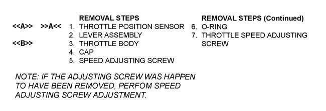

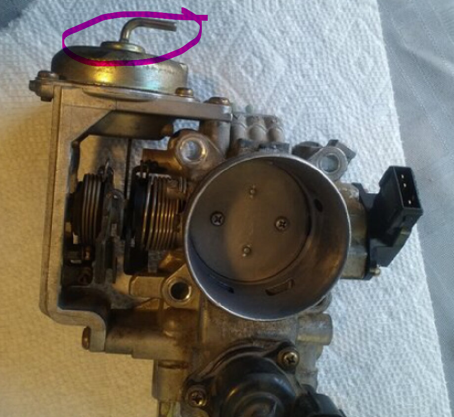

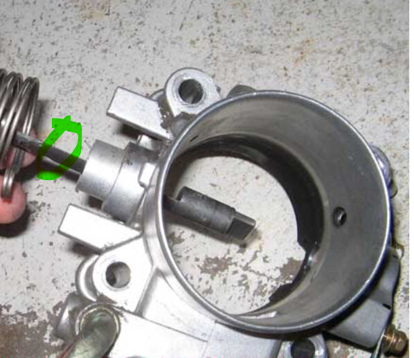

Yeah, some brakes were making a horrible grinding noise then all the sudden the brake pedal went soft valves do allow some smoke out, it depends on the design. What is your fuel trim numbers at? The 2nd smoke leaking there looks like it's coming right out of the throttle plate spring. So that seal behind that spring is probably leaking. and being right at the throttle plates that will be a high vacuum area. So, to be sure you might want to take the throttle cable off. It might be the throttle body gasket too, it's difficult to tell on video.
If the throttle plate shaft seal is leaking, just replace the throttle body, it will be more difficult and take more time.

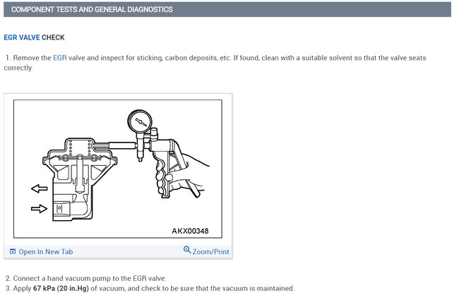

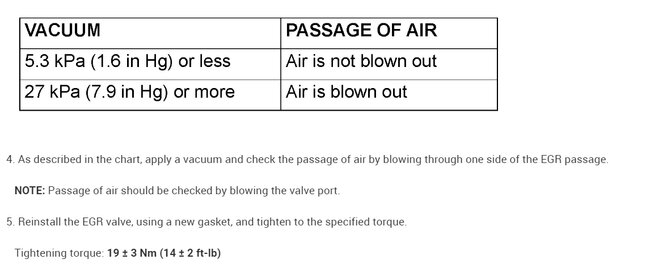

I did find info on that EGR valve, the testing diagrams are below, it looks like it should hold 20inHg of vacuum, so I don't think that valve should have any smoke coming out. You can take the valve off and inspect it some more. But I think the internal diaphragm is leaking. But it looks like all that's left for vacuum leaks are confined to that one area. Smoke testing is always the best way.
You can remove the EGR valve and block off the passage and retest too just to be sure. But it looks like the shaft seal with smoke coming right out of that return spring.
Jun 13, 2023 at 11:22 AM
VSPINNET
  • 19 POSTS
I have since removed the EGR valve, and throttle body, so I can't check the fuel trim numbers. If I recall correctly, the long-term fuel trim was between 8-12%, and the short-term fuel trim was greater than 10%, but that was over a week ago when I checked.
I did a vacuum test on the EGR diaphragm, and surprisingly, it held 20inHg for 10 minutes. I wanted to do a vacuum test or smoke test on both passages with a closed valve but nothing I had fit the passages. With the valve closed, I ended up putting colored water in the intake passage and setting it on a paper towel. I found that nothing leaked to the exhaust passage, however, an extremely slow drip developed from the EGR valve stem going to the diaphragm, much the same as your opinion of the throttle plate shaft seal.
I'm glad you told me what may be leaking from the side of the throttle body because I had no clue. The throttle plate shaft seal leaking makes perfect sense. I don't think it's the throttle body gasket where the smoke was coming through as it was just replaced, and I had inspected where I could see, and it didn't look like it was coming from there. I'm going to try to close the passages to confirm that it's coming from there.
A new throttle body is ~$800, so I'm looking for a used one. My local Pick-n-Pull does not have my vehicle in their inventory. The only place I could find one is car-part.com (if the inventory is up to date). I did look for those seals as well, but they are absolutely nowhere to be found. The car is probably just too old.

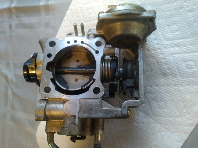

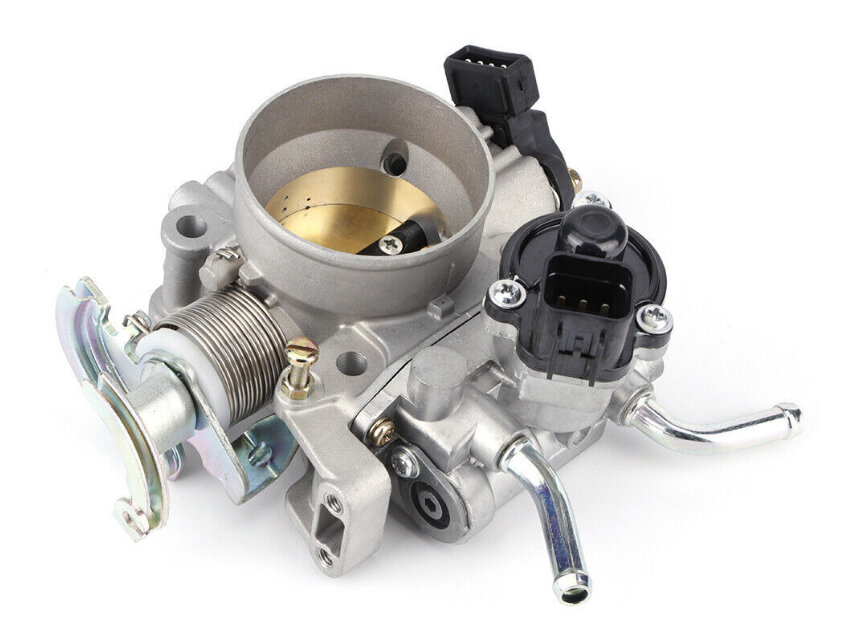

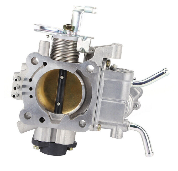

$800.00, that's a crazy amount. You can try a search on eBay or other used parts stores, some will mail it to you. The OEM part number is MN122179. The OEM is listed at $1,016.16. eBay has some listed, but I don't see any part numbers listed.
You could try pulling off the throttle body again and block off the front and back, then smoke test it again to be 100% sure it's the shaft seal.

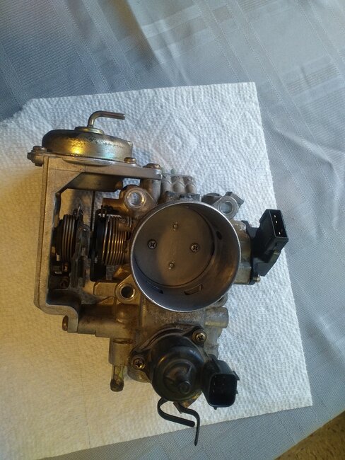

This is a throttle body for a 91-03 Montero 2.4L 4wd. it looks exactly the same, the part number is different, but I see other locations that could be leaking, these are the diagrams for the all the vacuum hoses. I see quite a few ported vacuum locations.
I'll keep searching to see if there's any alternate part number besides the OEM, aftermarket ones won't have the same OEM number. So, check on that as well.
Can you post a picture of your throttle body?

I'm still trying to do a smoke test with the throttle body off the vehicle. I think I'm going to take its gasket, and sandwich it with something else flat to block the back passage. Here are pictures of the front, and back of the throttle body. They look very similar to the Montero throttle body you provided. Thank you so much.
Jun 17, 2023 at 8:02 AM
AL514
  • 5,661 POSTS
Yeah, they look almost exactly the same, that's what came up when I did a search for your vehicles throttle body. It was a different part number, but it would be from a different vehicle. I was thinking the same idea, if you block off both sides and see if that's really where the smoke was coming from.

Just an update.
I confirmed there was indeed a leak in my throttle plate shaft seal, so I purchased a used throttle body from ebay, and an EGR valve from China which took time to arrive. When I installed both, the new EGR still puts out smoke in the same place, although very little. The used throttle body I got puts out even more smoke from the throttle plate shaft seal. It wasn't in the best condition, but they gave me a refund after showing them a video, and let me keep it, which was great because it came with an original TPS. I just purchased another throttle body from ebay, so hopefully this one is sealed.

All I'm finding in service info is "Lever Assembly"
I did find a technician statement about the throttle plate shaft seal leaking due to excessive play in the plate and shaft that had worn out internal to the throttle body. So the leaking shaft seal might be the result of a wear in the throttle body itself. In that case replacing the seal would not be a permanent fix, which makes sense.
So aside from replacing the entire throttle body with a new unit all together, which looks to be very expensive, if the next one you get is leaking at that seal, I would change the throttle body gasket (the main one) and just monitor the fuel trims for a few days. You did replace some seals, if you can get the fuel trims to stay down at 10% and thats the best you can do without replacing the TB, it might just have to stay like that. I know thats the worst answer, but at a 1000 dollars for a new TB. As long as the lean exhaust code doesnt set anymore. The ecm can compensate for small air leaks, thats what the fuel trims are for, you just dont want it to get so excessive it damages the Catalytic converter
