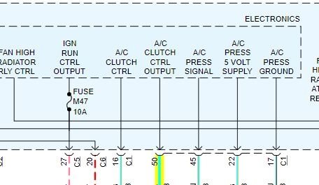

like to know the location of were the A/C relay
2009 DODGE RAM
180,000 MILES • 4.7L • 6 CYL • 4WD • AUTOMATIC
COWBOY1986
I would like to know the location of were the A/C relay inside the fuse box.
Sep 12, 2019 at 3:00 PM
  • 110,194 POSTS
Welcome to 2CarPros.

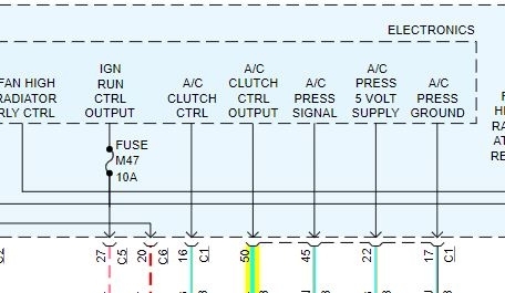

It doesn't have a traditional relay for the A/C compressor. Instead, it is controlled by the TIPM (totally integrated power module). Most times, the pins at the connectors corrode and break. I'm not sure what the problem is with the vehicle, but I did attach a pic of a portion of the TIPM so you can see where A/C power is coming from.
Let me know if this helps.
