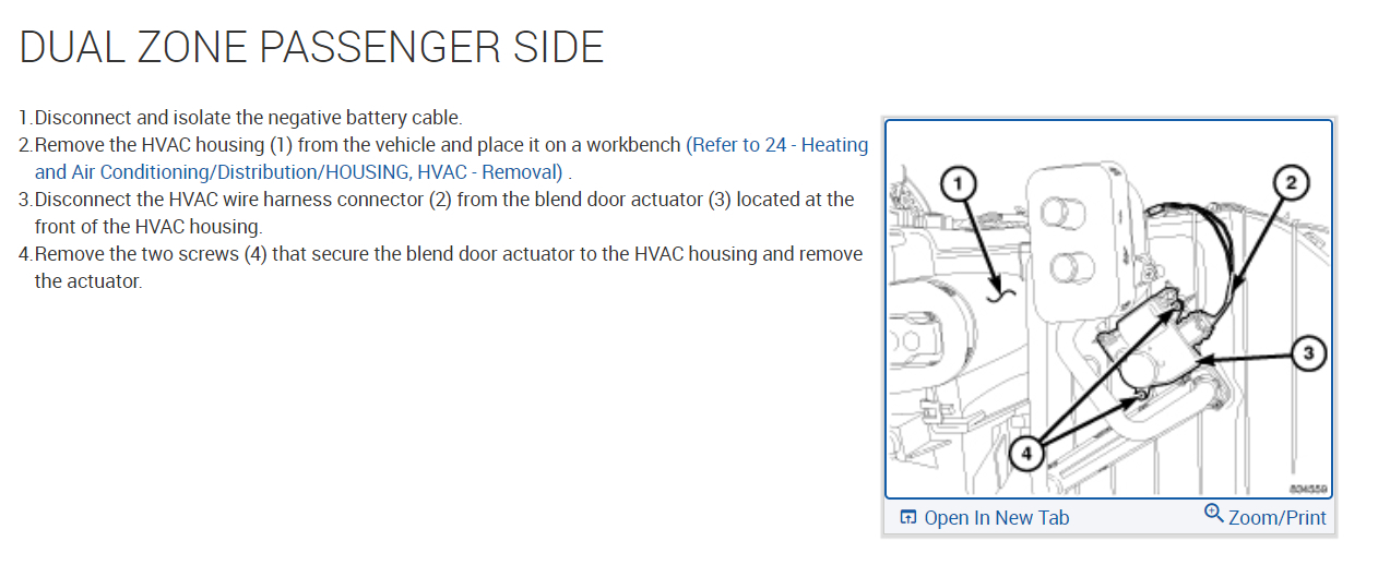

Heat blows on passenger side and rear but not driver side, just blows cold air, also makes a noise on passenger side under dash.

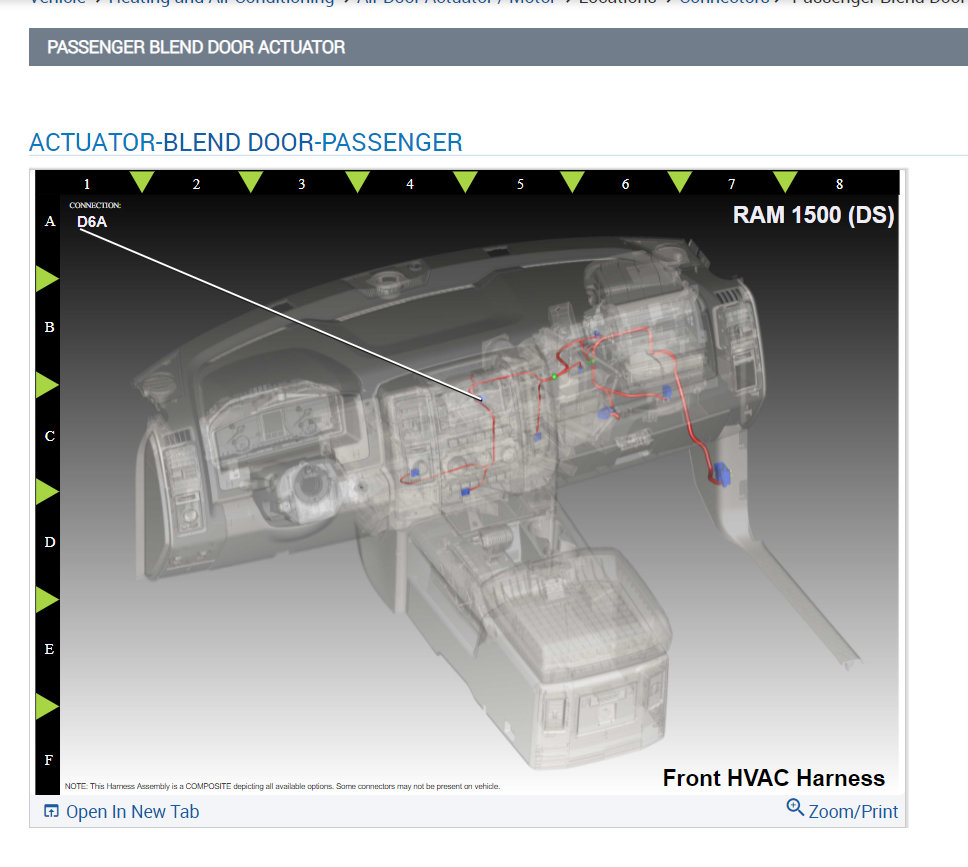

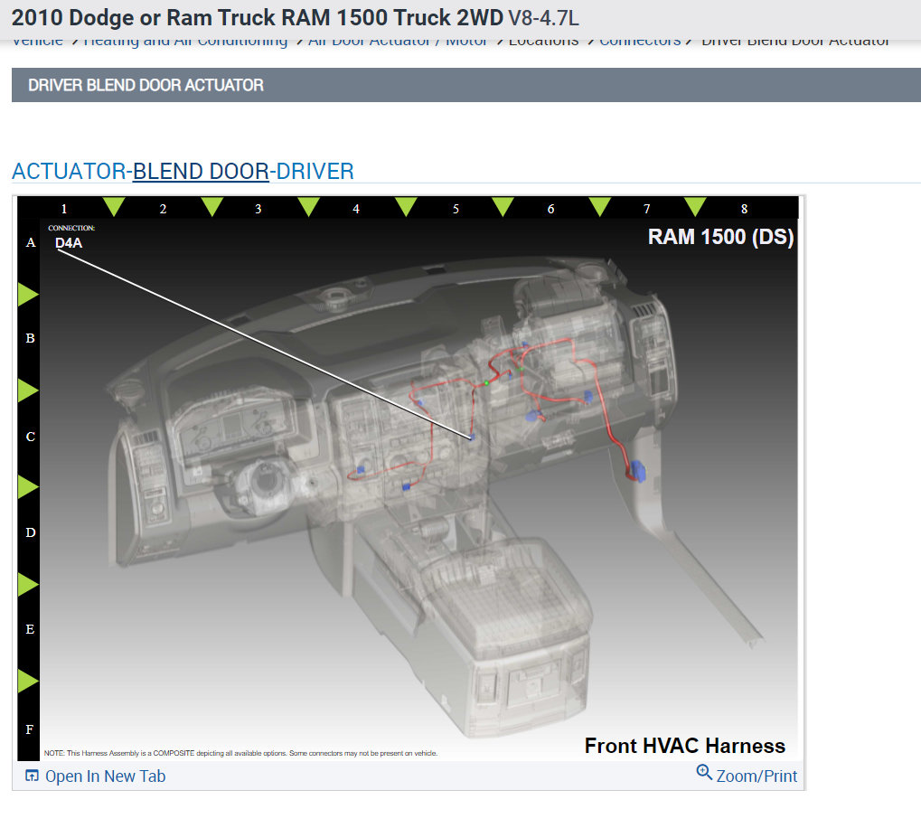

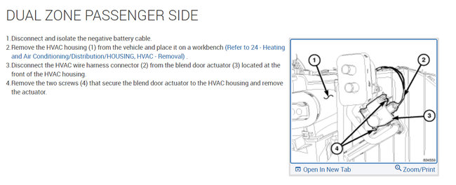

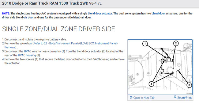

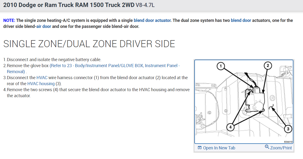

This happens when the right or left temperature blend door actuator goes out. This guide can show you how a typical system works and where the actuators are located. I have included diagrams for your car below.
Check out the diagrams (Below). Let us know what happens and please upload pictures or videos of the problem.
Jul 1, 2020 at 12:03 PM
WILLY1997
Yes separate temp control. It's a weird clicking noise kinda loud I got a driver side actuator works great thank you.

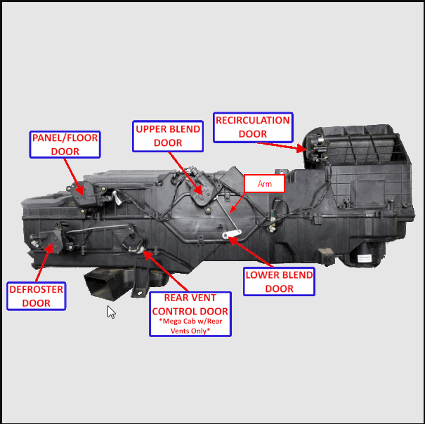

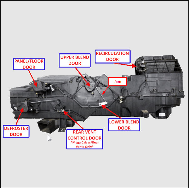

This could be a blend door issue if you have dual zone temperature control. If this is single zone then most likely the arm that connects the two doors has fallen off or broke.
Here s a guide that will help with this:
Below you will see an illustration of this as well.
