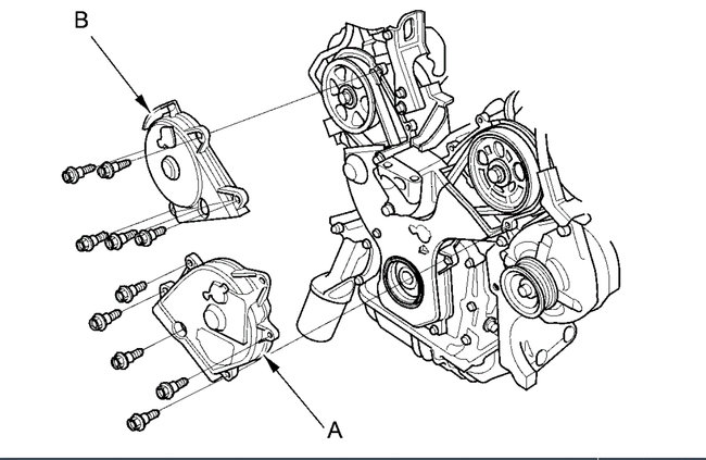

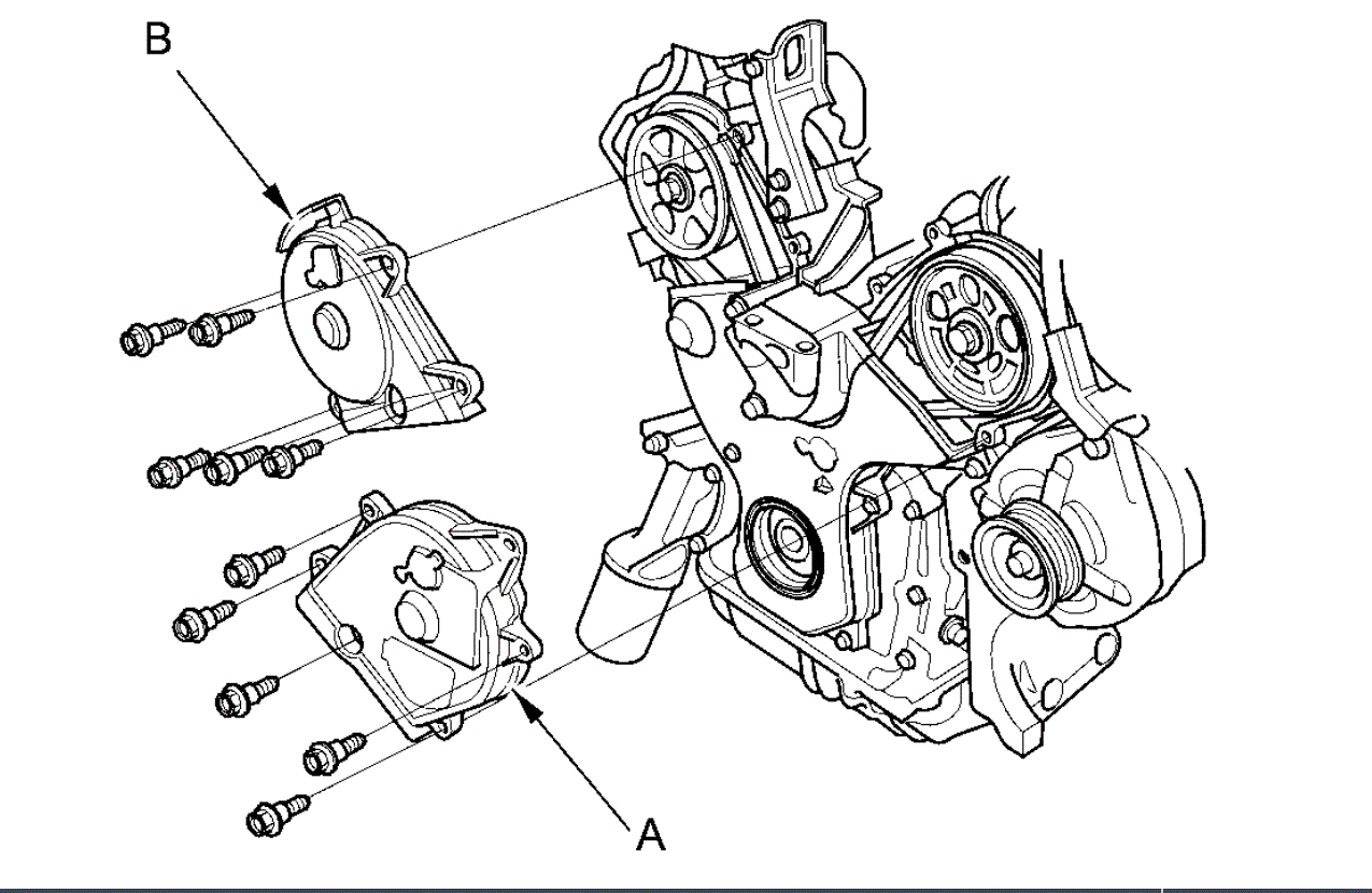

If that is where the noise is coming from, something needs attention. We have two ways to attack this. First, have them listen to confirm that is where the noise is coming from before taking things apart.

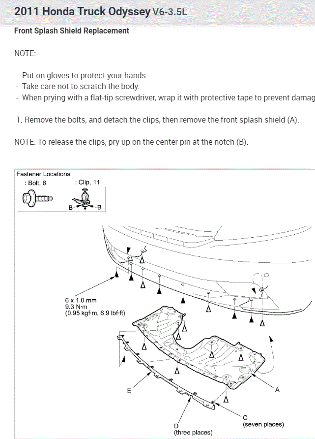

Or I attached a pic below. It shows the two upper timing belt covers and the bolts holding them in place. You could remove those and check belt tension by hand and with a flashlight, look down into the bottom cover to see if anything appears loose or damaged.
This should be all that is required of them to do for confirmation. You will likely need to remove the serpentine belt and a few covers, but it really isn't that difficult to do.
Let me know if you have questions or if I can help in any way.
See pic below.

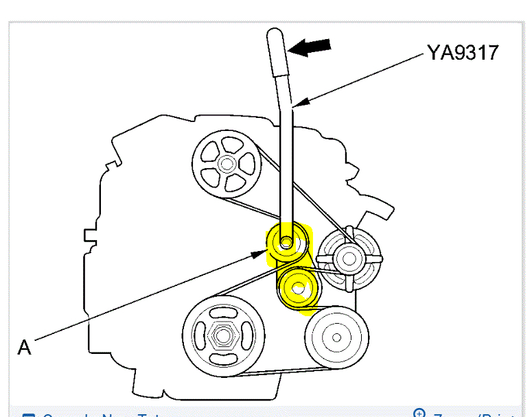

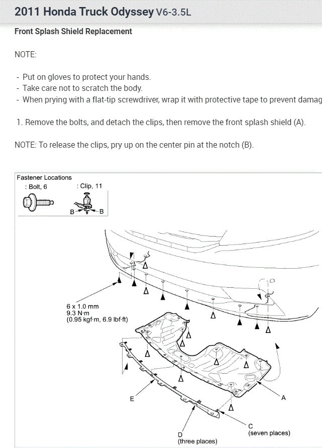

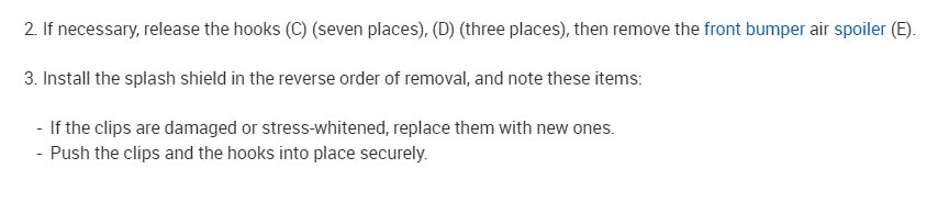

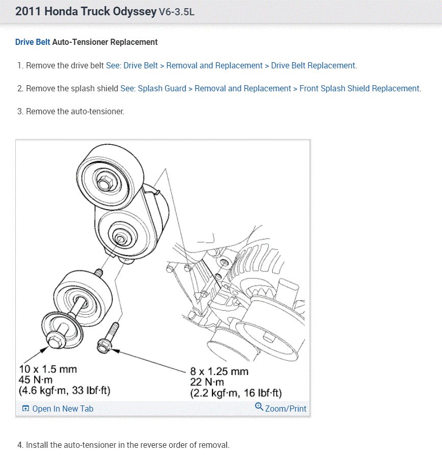

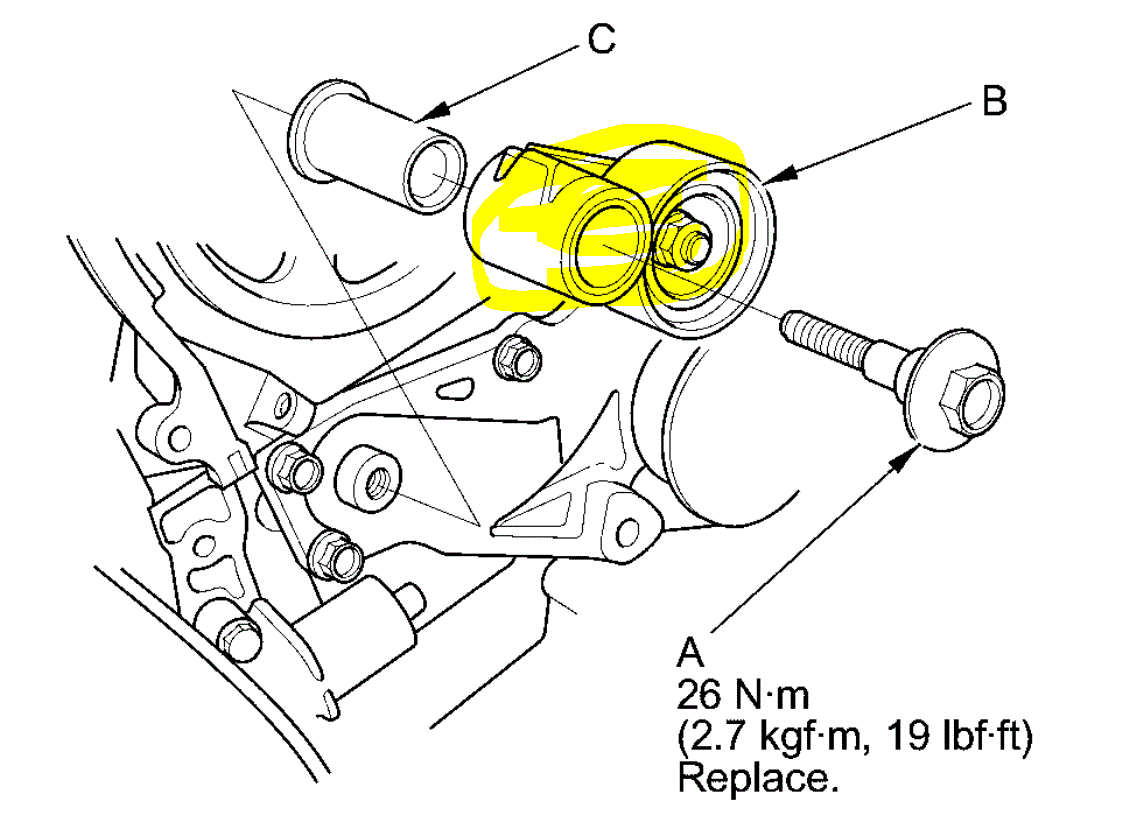

Regardless, the worst part of replacing this is room to work. You will need to remove the belt and then the plastic splash shield under the front. It is held in by several different plastic clips.
If you look below, I included a pic of the tensioner (pic 1) showing which way to move the tensioner to loosen the belt. Remove the belt first. Next, pics 2 and 3 explain how to remove the splash panel. If you find access without removing the entire thing, that is fine.
The last pic shows the tensioner and directions. There are two bolts that need to be removed for the removal of the tensioner. The installation is the opposite of removal.

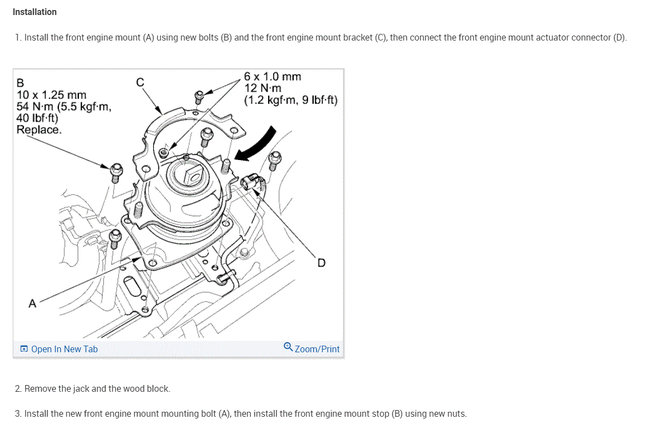

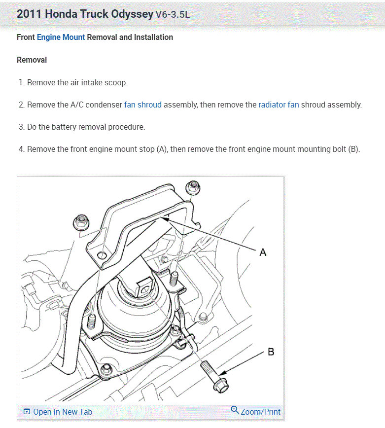

I went back and checked through the maintenance records, that same motor mount was just replaced around 40,000 miles ago at the dealer. I wonder why it would break so quickly, unless they messed it up somehow when they changed the timing belt?
May 9, 2022 at 5:17 AM
  • 110,248 POSTS
In most cases, a motor mount will last the life of the vehicle. Which one moved? How far did it move? Does it move in drive and reverse?
Here is a link that explains in general how one is replaced. Take a look through it and let me know if it helps.

The passenger side motor mount is where we were looking since that's where the noise comes from. He said it shifted inside the mount in both forward and reverse when I pressed the gas and we heard the chatter when I pressed the gas as well.
May 9, 2022 at 11:28 AM
  • 110,248 POSTS
Some movements are normal because it is mounted in rubber. However, rattling isn't. If you feel that is where the noise is coming from, then it certainly is a possibility.
Do you plan to replace it yourself or have the dealer do it again?

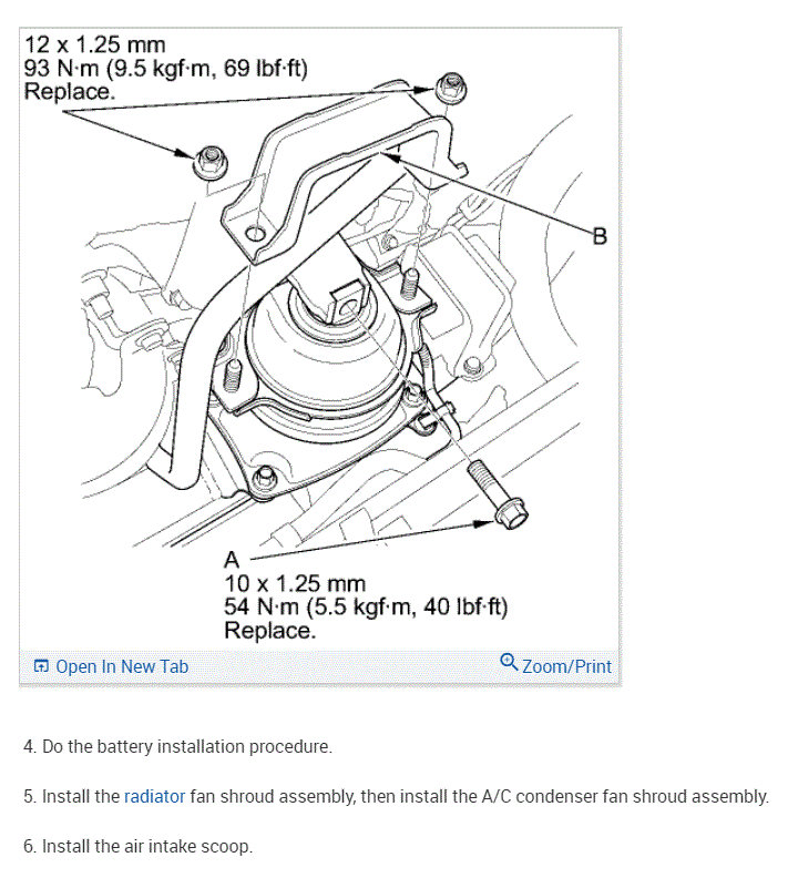

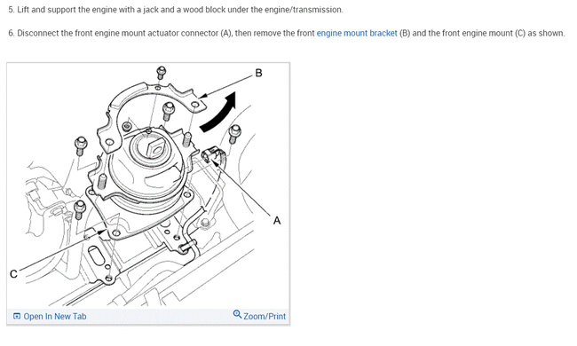

I may go out there tomorrow and just re-tighten all the bolts on the motor mount just to be sure the dealer didn't miss something when doing the timing belt.
I would try to replace it myself for sure, it's a $25.00 to $30.00 part. But before I do anything I want to listen with the stethoscope again just to be double sure before buying anything. That's the only thing we didn't do today was stethoscope.
May 9, 2022 at 12:00 PM
  • 110,248 POSTS
That is a good idea. Let me know if it is the problem. Also, I attached the directions specific to this vehicle for replacing the front engine mount.

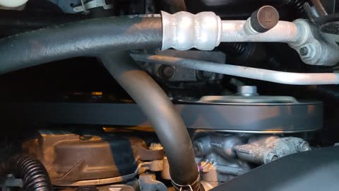

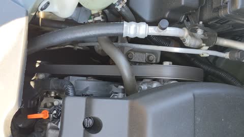

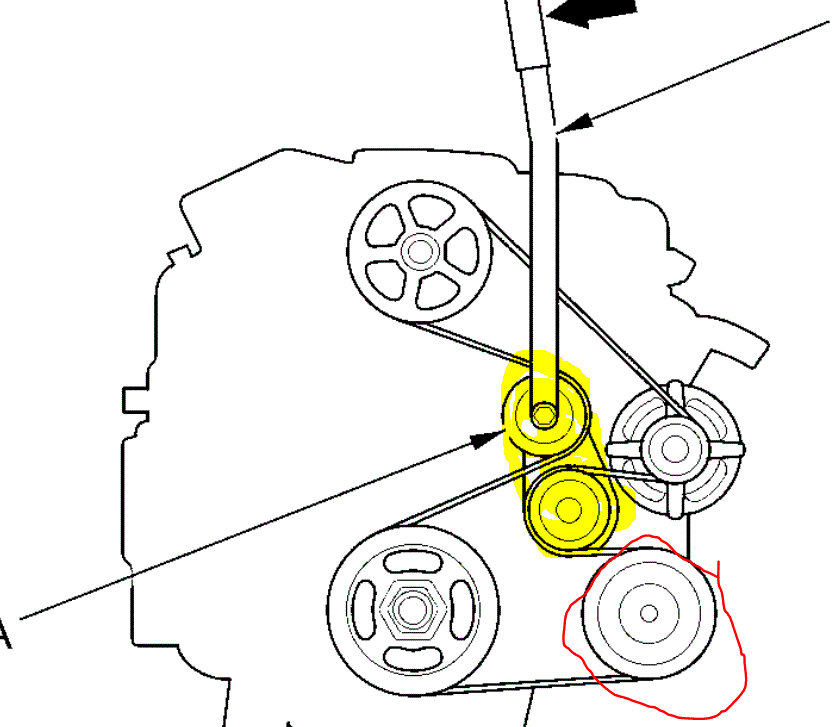

I finally managed to get a video of the chattering. I had to drive it for a while with the AC going, then stop and out the parking brake on (but leave it in drive). If I put it in park or turn off the AC, the chattering stops.
May 20, 2022 at 2:30 AM
  • 110,248 POSTS

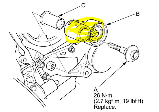

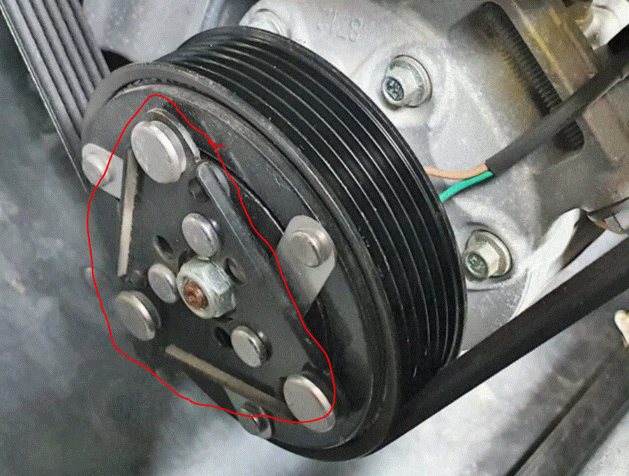

It sounds like the tensioner is chattering, which is very possible, or the A/C clutch is kicking on and off.
I attached a pic below. The highlighted part is the belt tensioner. Check to see if that is vibrating when this is happening.
Next, in red, I circled the A/C compressor. At the front of the pulley is the clutch. With the A/C off, the pulley spins freely. When you turn the A/C on, the clutch clicks in and turns the compressor. Check to see if that clitch is kicking on and off. Here is how you can tell:
The center of the pulley will not be turning with the AC off. When it's on, the center will engage and turn. If you look at pic 2, in red I circled the clutch. With the AC off, that will not turn while the pulley does. When turned on, that engages and begins to turn with the pulley.
Let me know what you find or if you have other questions. Also, if I had to guess, I would say the tensioner is the issue and not the compressor clutch, but since it stops when turned off, that is where the sound may be coming from as well.

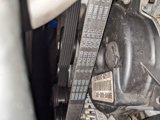

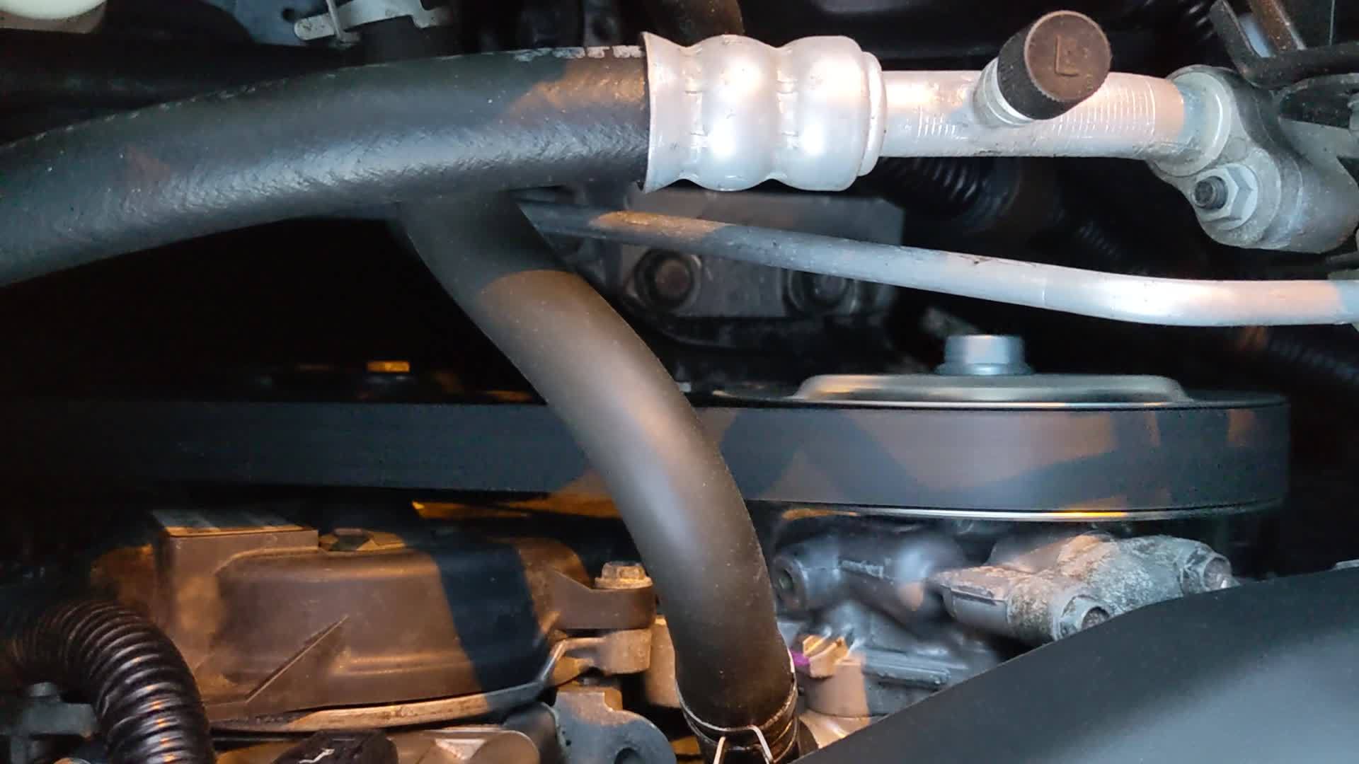

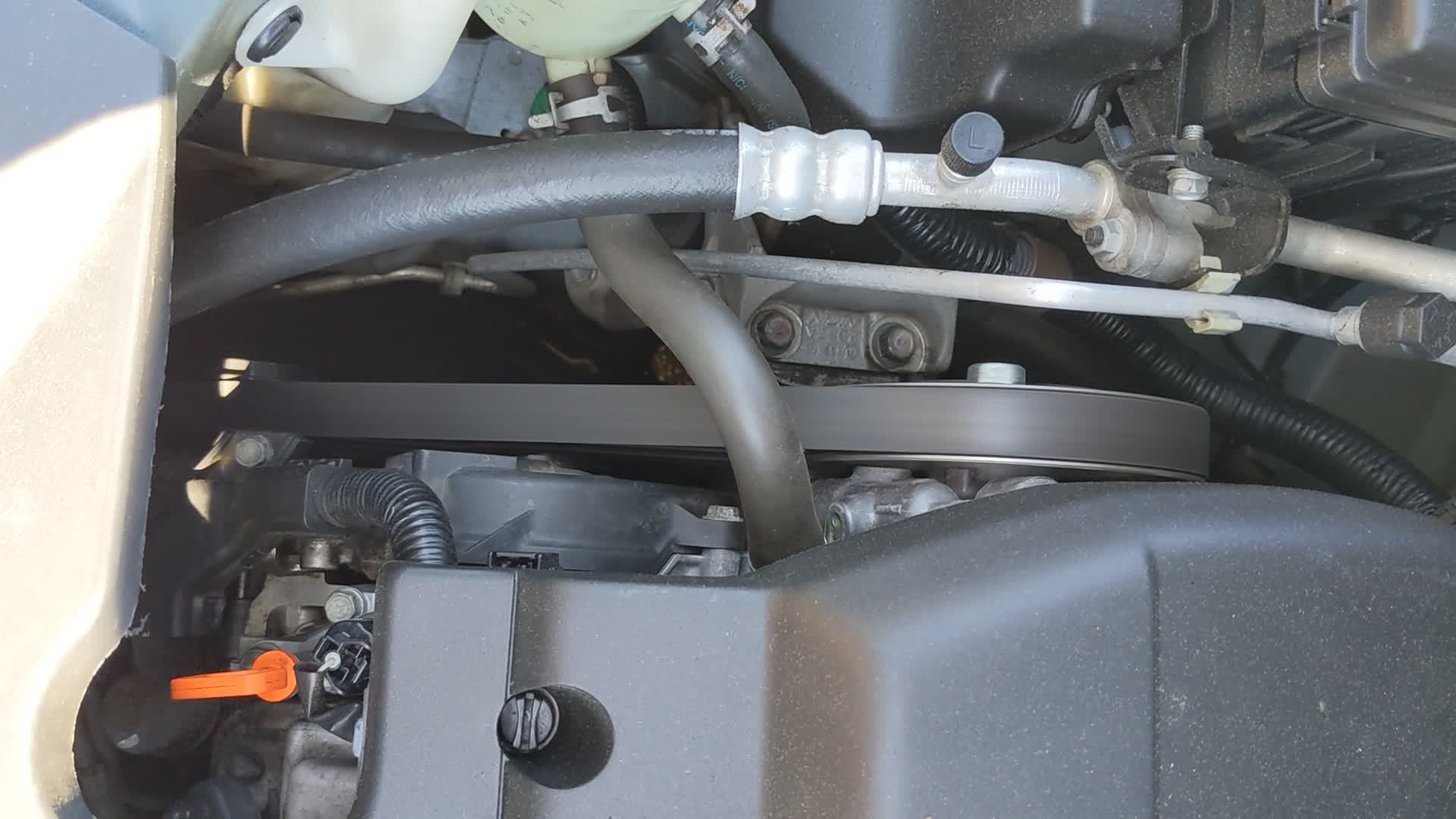

Question. I've noticed that the belt is riding off center on the tensioner pulley. It's not coming off, but it's like 1mm close to the edge facing the wheel. Will this cause any issues? My neighbor who used to be a mechanic said the belt said as long as it's on the pulley it's fine.
Oct 30, 2022 at 12:24 AM
  • 110,248 POSTS
He is correct, but I would rather know it's centered. Do me a favor. Just keep an eye on it to see if it changes at all.
Let me know if there is anything I can do to help. Also, if you want to take a pic of how it is and upload it for me to see, I would be happy to let you know my thoughts.

I haven't noticed it move at all. I think it's just that we barely got the belt on there due to the new tensioner being so tight and hard to move. We figured it would self-center but I guess not. I might try to relieve the tension and slide the belt over some more of I can.
