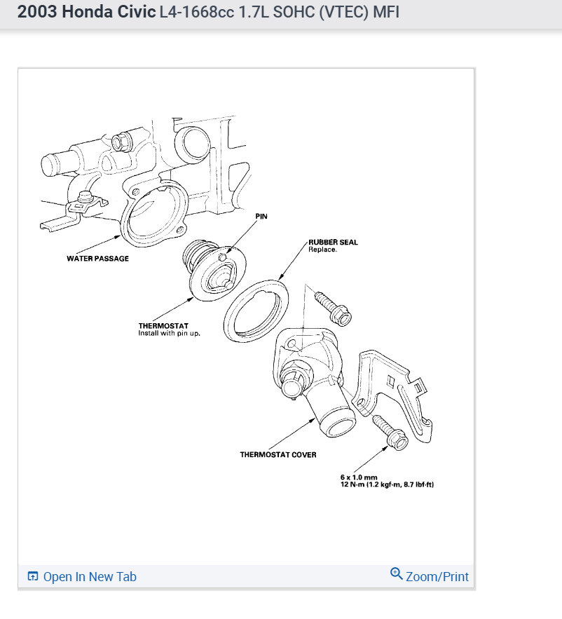

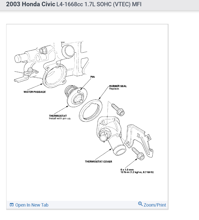

It sounds like the thermostat is stuck closed. Can you please shoot a quick video with your phone so I can hear the noise? That way I can tell for sure what's going on. You can upload it here with your response. Here is a guide on how to check the thermostat out step by step with instructions below for your car.
Check out the images (below). Please let us know what you find.

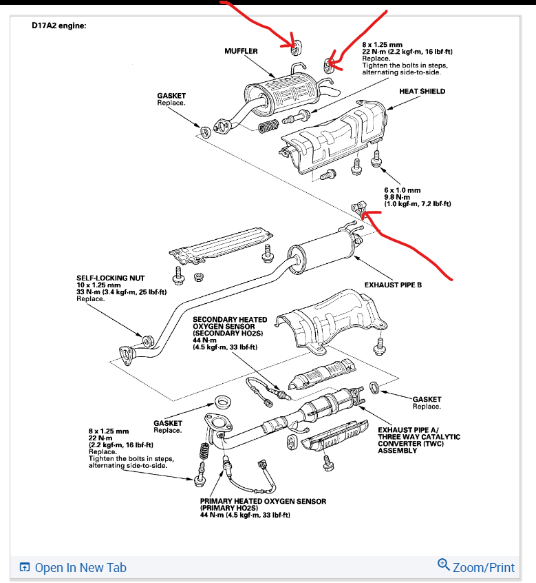

Thanks for the video, it helps. it sounds like the exhaust system is loose under the car, I would raise the car up and use a flashing light to see if any of the exhaust hangers are loose or broken. Here is a guide that can help, and I have included the exhaust diagrams as well so you can see what I am talking about.
