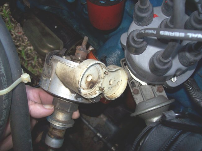

Pic below of the Presto beside my Motorcraft, I gutted it and a little modificationing, (mainly the drive gear has been removed) it is now used in conjunction with my electric drill to "prime" the oil galleys in rebuilt 232s and 258s before they are ever cranked up
